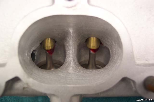

Head
Fully ported head
Crower springs and titanium retainers
SI oem size stainless valves (back cut/swirl polished)
SI bronze valve guides
Revised large hole lifters
HKS 272/272s
Findanza cam gears (degreed)

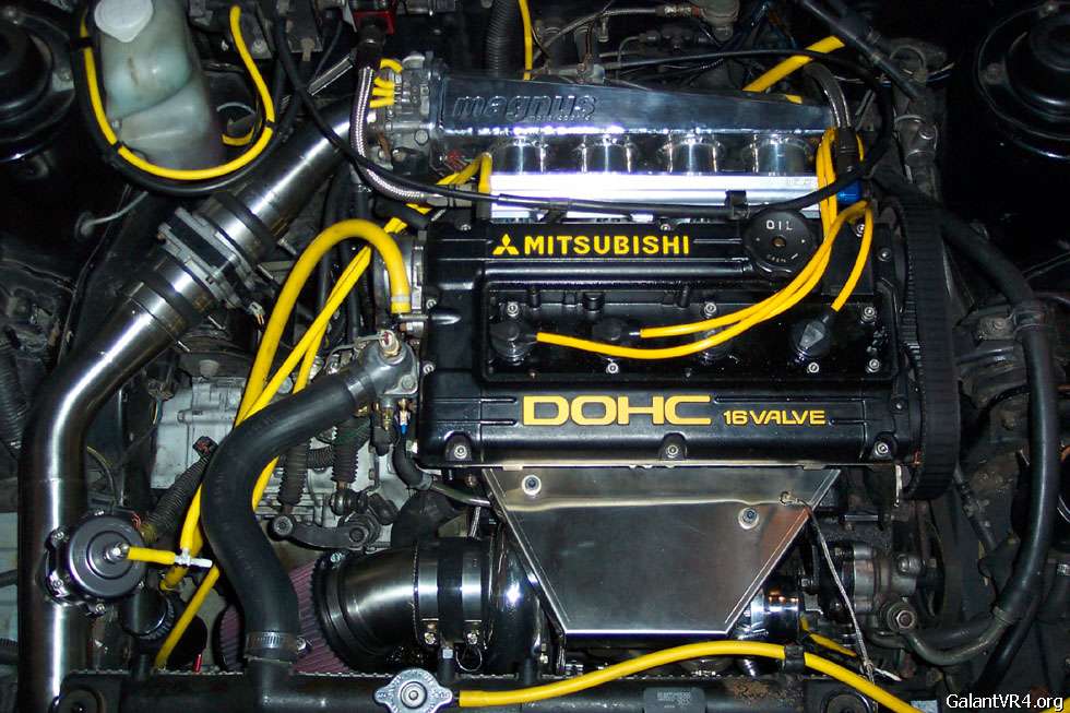

Induction
custom 4" stainless intake
4" K&N filter
Forced Performance 3065 turbo
2.5" stainless upper/lower IC pipes
Magnus intake manifold
50mm Tial BOV and 44mm Tial watsegate
Slow Boy Racing Evo III clone ceramic coated black satin
custom 3" exhaust
Dynomax bullet and ultraflow muffler
Spearco 2-216 with endtanks welded up by AMS

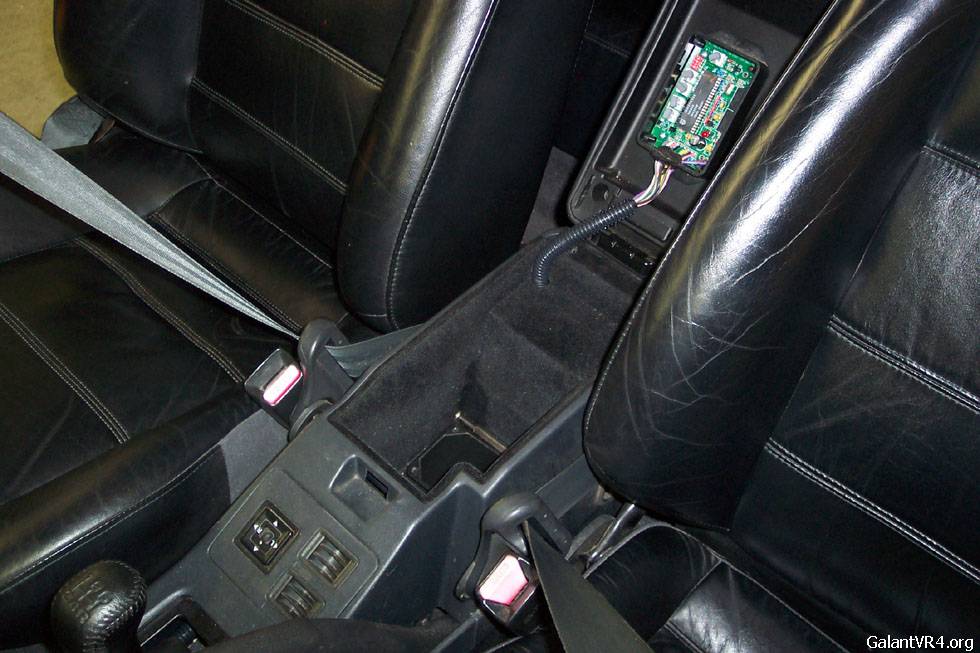

Electronics/Misc
MAFT
Jeff O’s Custom EPROM
