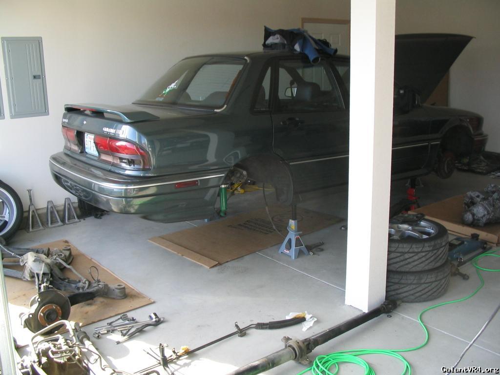

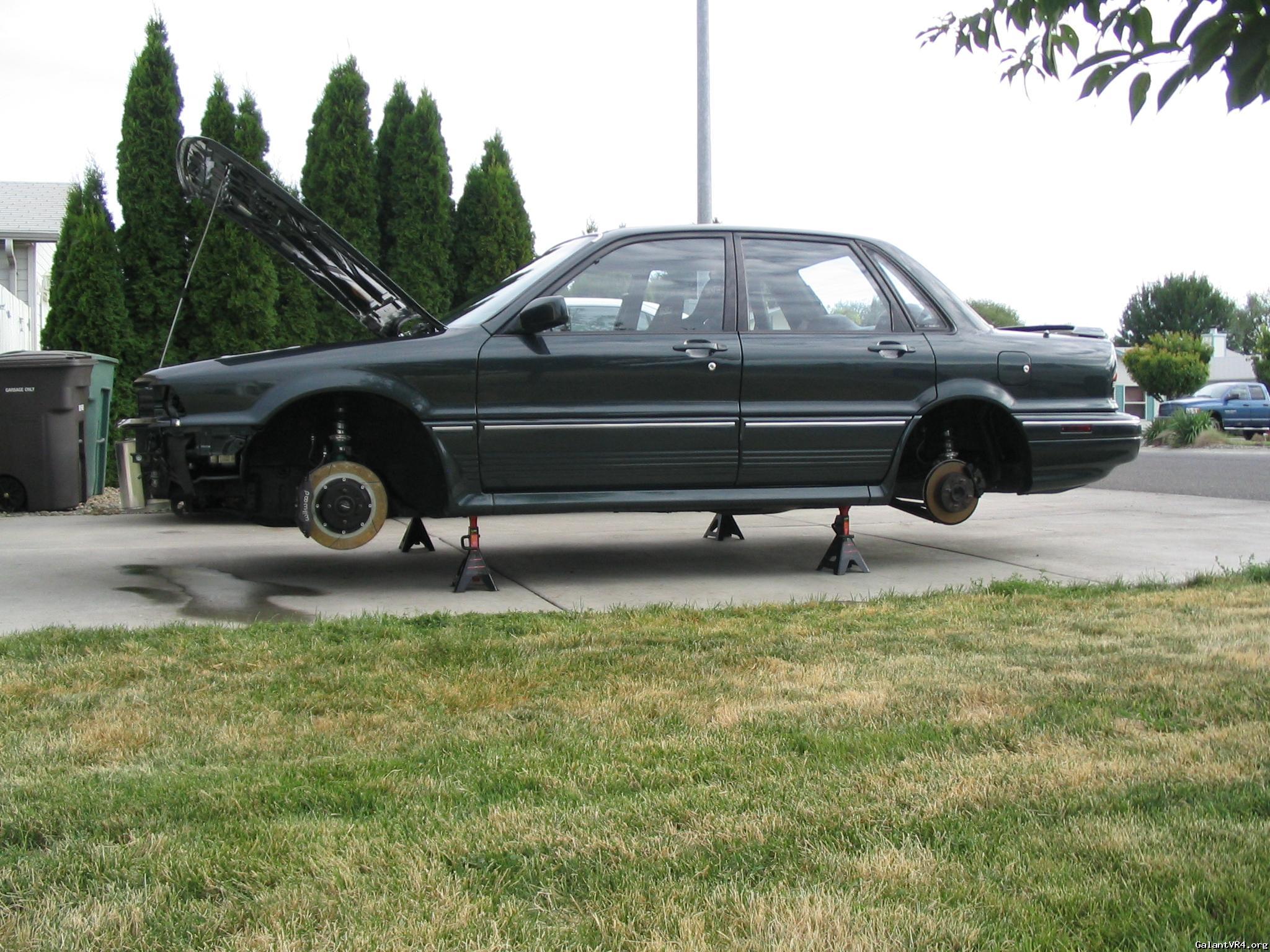

There are four jack points around the rocker panels on the car for doing tire changes. Put the jack stands at those points. There is an arrow stamped into the rocker panel spine that shows where they go.
