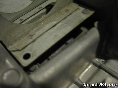

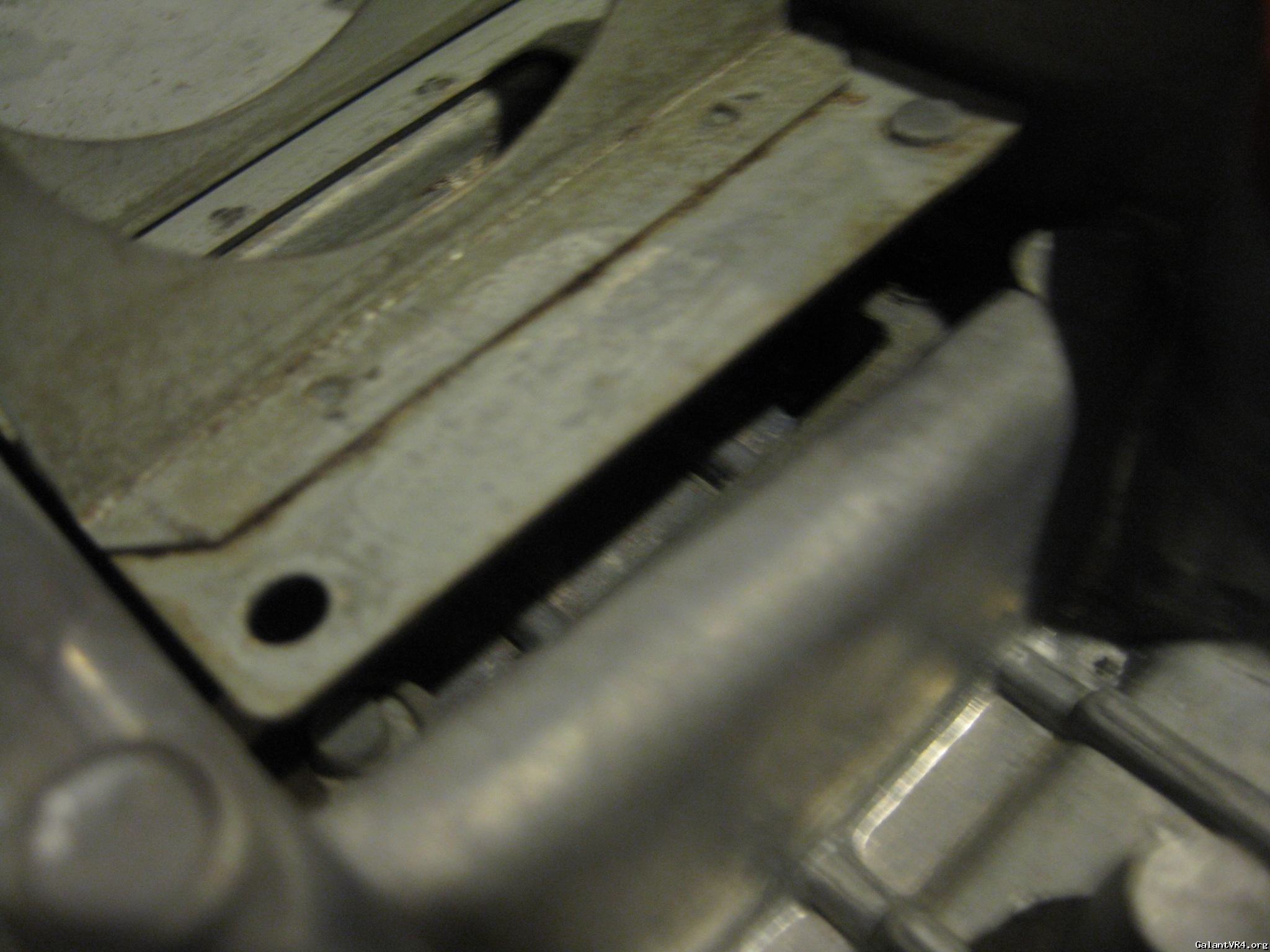

ok so I have a valve cover in front of me that seems to have an issue.
when i turn it over on the inside, on the side without the oil filler hole, the metal plate has 4 broken studs and missing part of the gasket. i can move it up and down inside the VC. i am worried this will be noisy as sh*t and may also have implications on the oiling system.

will the cam caps hold it in when it is bolted down?
will there be a rattle?
will there be oil trouble?

2 ways you can fix that. If you can weld aluminum, you can tack weld aluminum blocks on the sides. Else, you can drill a hole in the mounting position and use a sheet metal screw, and tack the screw to the baffle itself.
I'd worry about those mushroomed over parts breaking off inside a "good" cover no matter what.
