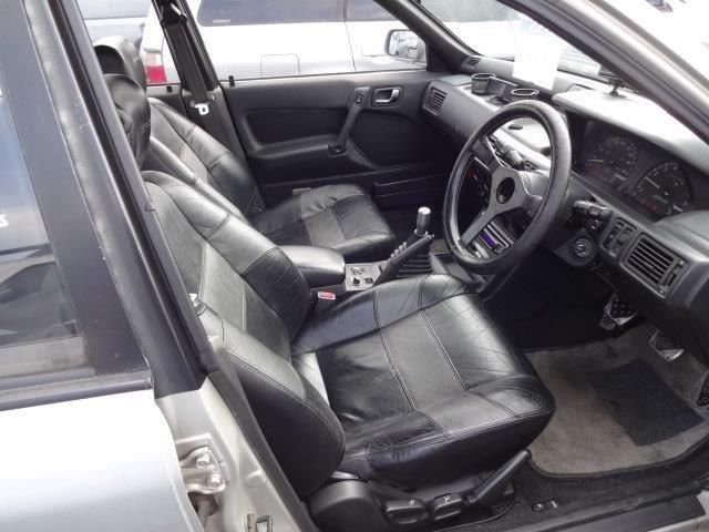

Wile looking at the missing shifter cup,i was noticing that the shifter looked to new and do good of quality to be OEM. so what you guys think?

no that is an aftermarket shifter with no shifter stops. I would try to find a stock setup so you don't wear out your syncros by overthrowing the hub slider in the transmission.

Not OEM, a quick google images search and I'm not finding anything that looks exactly the same to tell you what brand. Interesting, most aftermarket shifters only replace the left half of the assembly, and not everything like yours. Either way, I agree, looks like a well made part.

So, what other jdm goodies does your car have besides the AMG seats, power folding mirrors and the air purifier??
Not sure what the air purifier is but it seems like one came up for sale on the board a while back. Is it a box mounted on the deck behind the rear seats?
