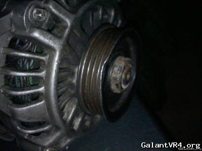

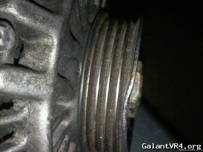

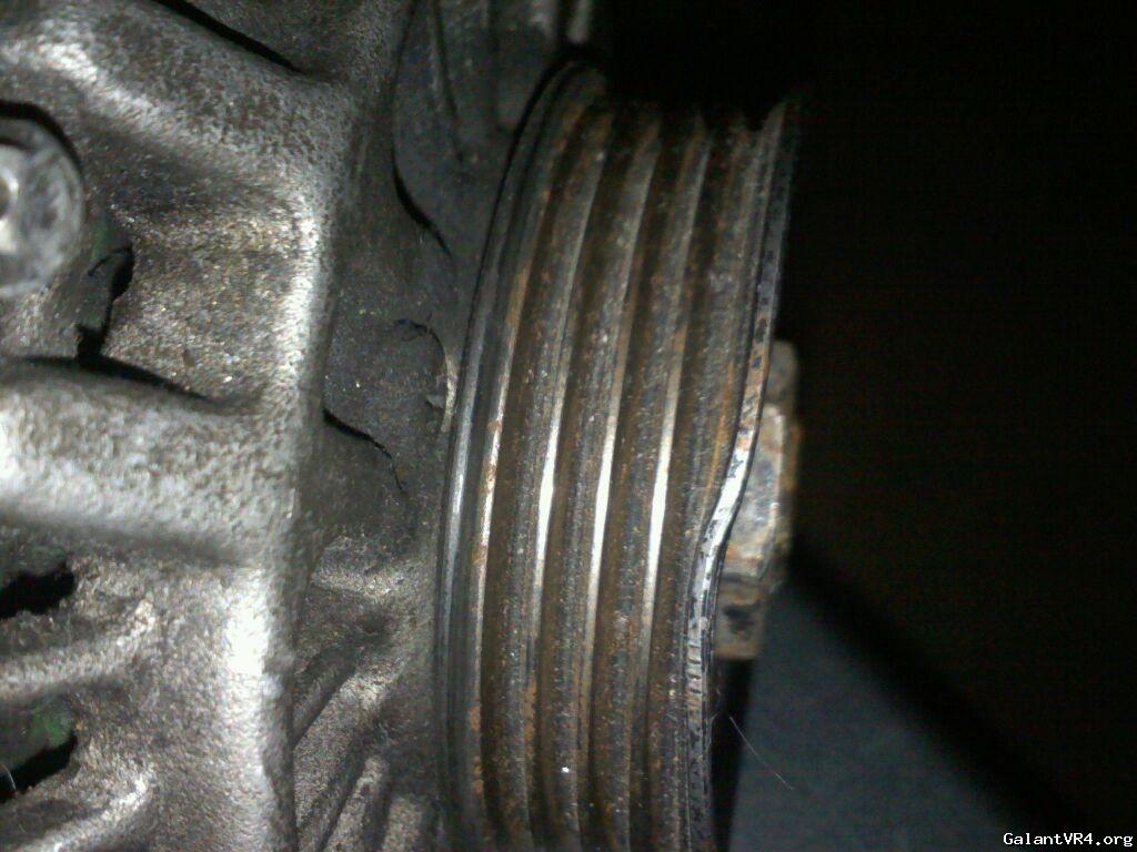

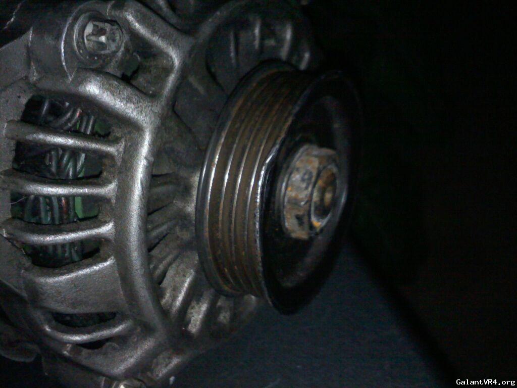

is this alternator damaged?
yeti
Oct 13, 2010
803
san diego california
is it damaged enough for the belt not to fit it,
and
if it is damaged
could I remove that part and put the wheel from my old one, onto this one.
^true. I wouldn't use that pulley, but just swap the pulley from the old one.

If you have another pulley, swap it. I would just straighten it if I didn't have another.
Terry Posten
Dec 16, 2003
9,009
Davenport, Iowa USA
Quoting iceman69510:
I agree with this.

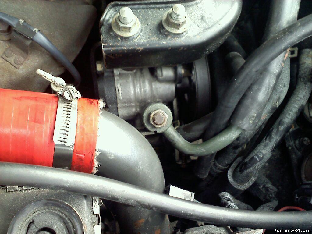

the last one was before i took off the IC piping

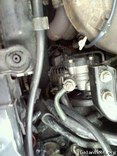

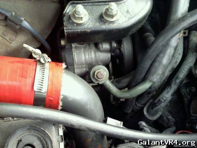

and is it just the 3 gold looking bolts for the power steering
if anyone could help it would be great
(i don't have a manual and i don't really know much about this car)
yeti
Oct 13, 2010
803

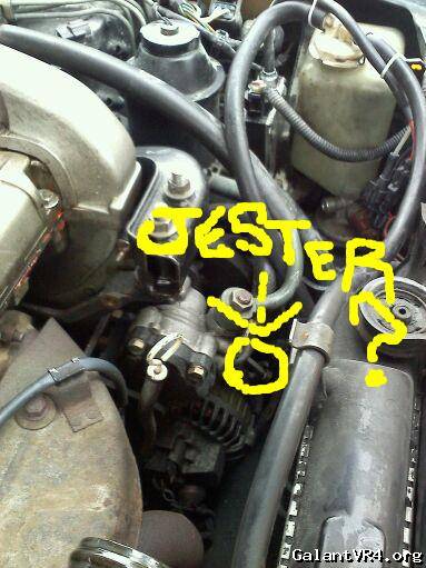

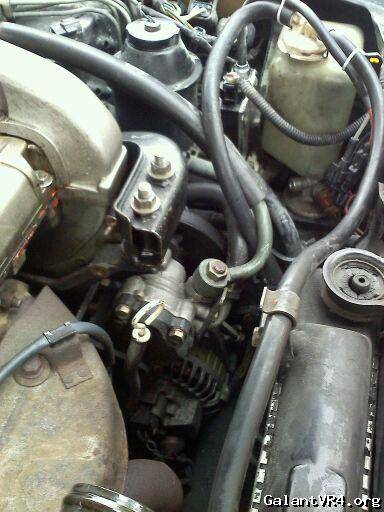

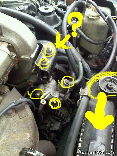

am I missing ANYTHING?
all the bolts circled are the 3 for the power steering
in the first picture?
or are those bolts not right
and is that the jester bolt?

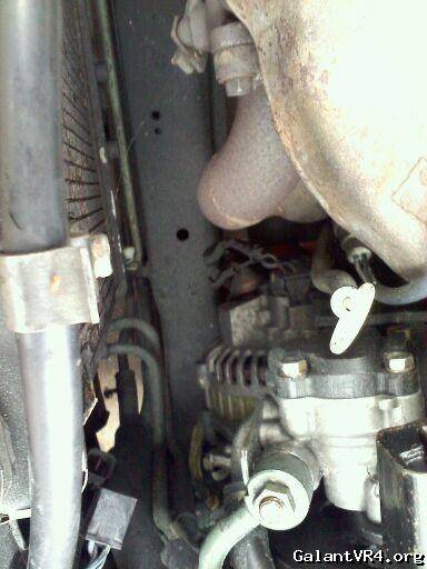

cant get second bolt for power steering pump the pully was in the way
can i still get it by removing just the radiator
