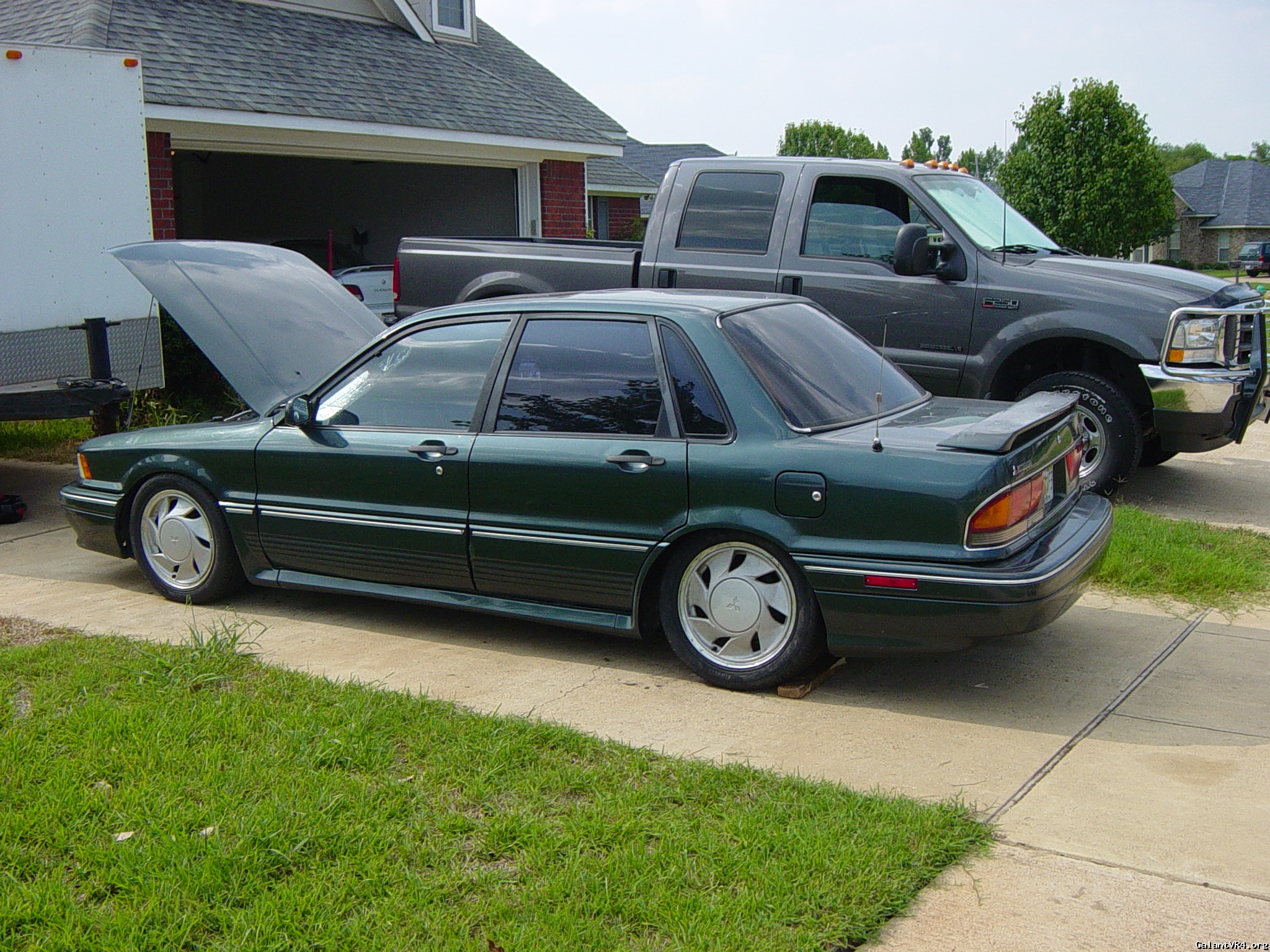

I have coilovers and the car is way lower than 1". It's not a race car but it's not a daily either. Car handles like a dream. If you have a nice setup then it's not "rice". If you just have the typical blown shocks and 1g springs to make it uneven and retarded looking like some people have on here then that's unneccesary.

In my opinion, a daily driver is something you can drive EVERYDAY and in any city WITHOUT changing anything. In that pic you would not be able to drive around here. We have steep angled drives here and there and not to mention....
potholes!
