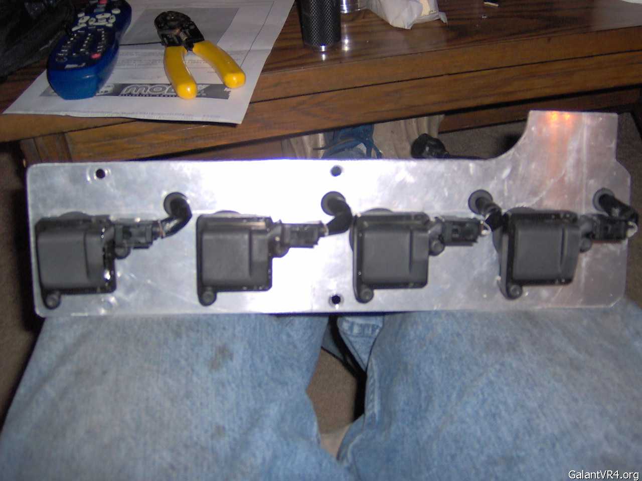

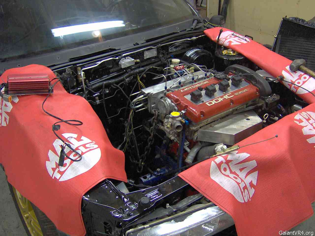

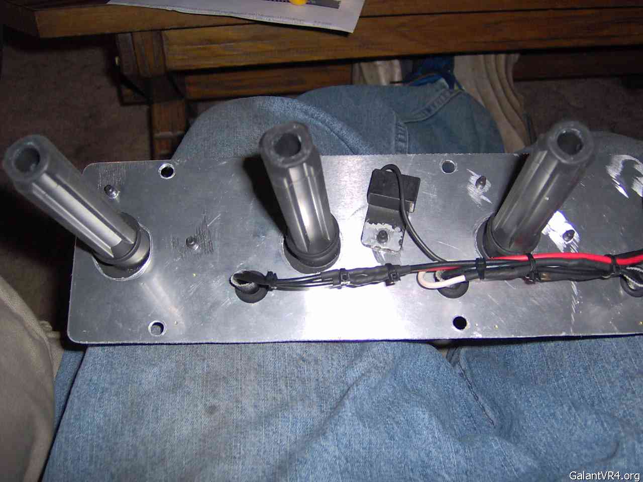

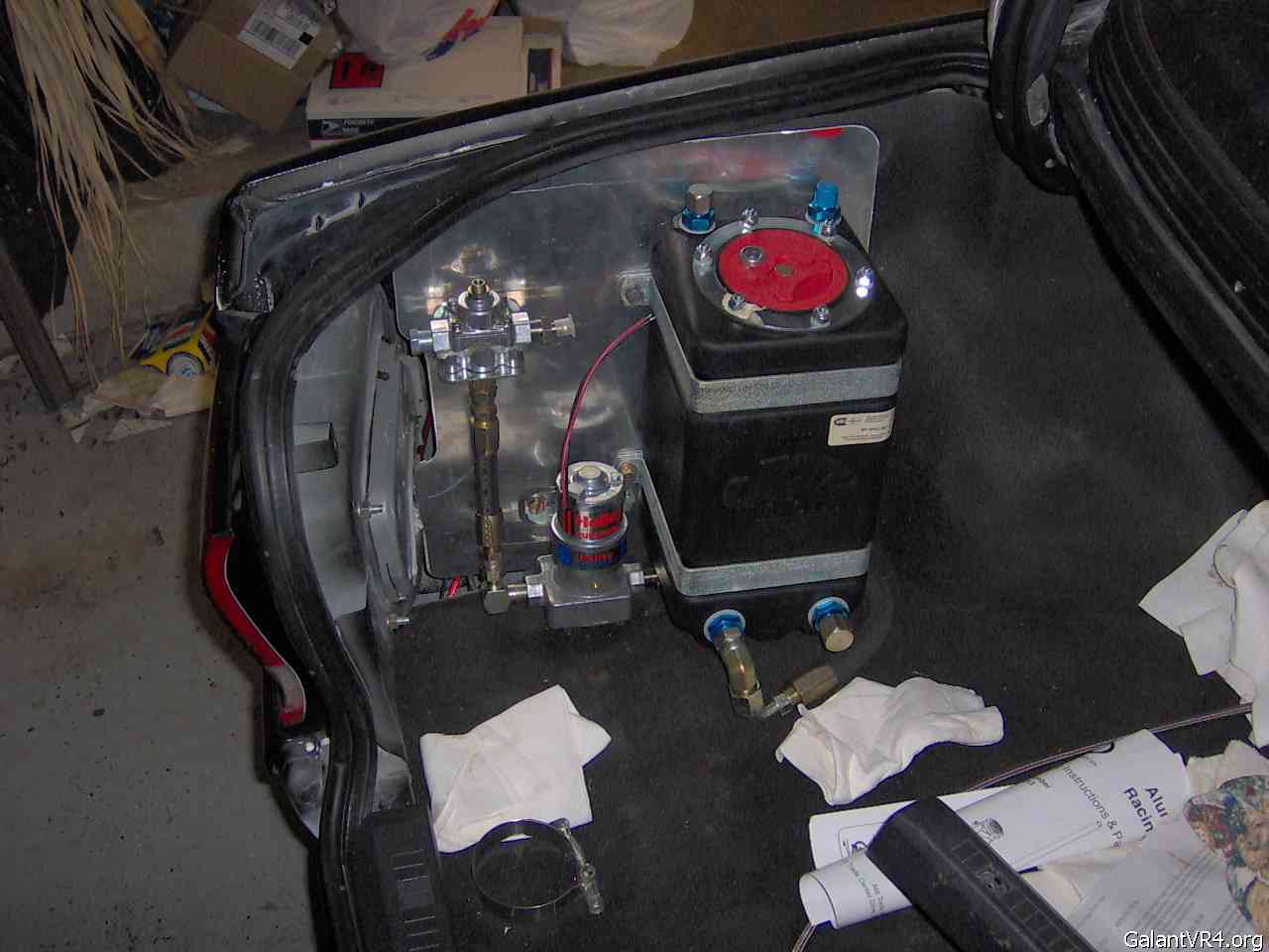

I finished it last night, just wanted to share some pics with you guys. Thanks, Curtis for your info on the subject. The pic of the fuel system is for my nitrous only, thats why its so small. Wanted to share that pic too.
Just take your time and it will turn out just as nice as mine. I got my rubber grommets at ace hardware.
Mine is .080 aluminum cut out by my jig saw. /ubbthreads/images/graemlins/grin.gif

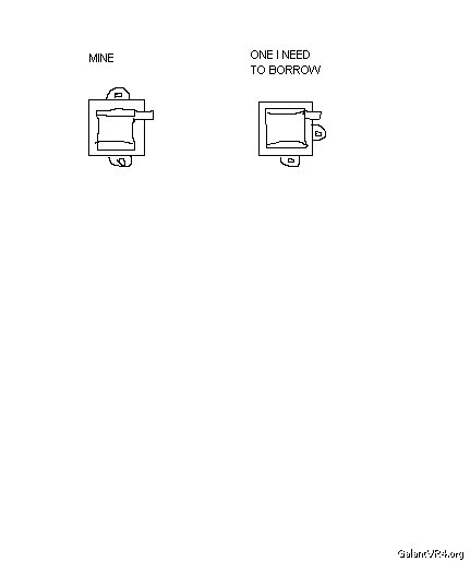

Anyone got a coil they could lend me that has the bolt holes on the side and end, for a couple days??? Mine has the holes opposite each other, and I want to make my plates with both. Here is another awesome drawing:
