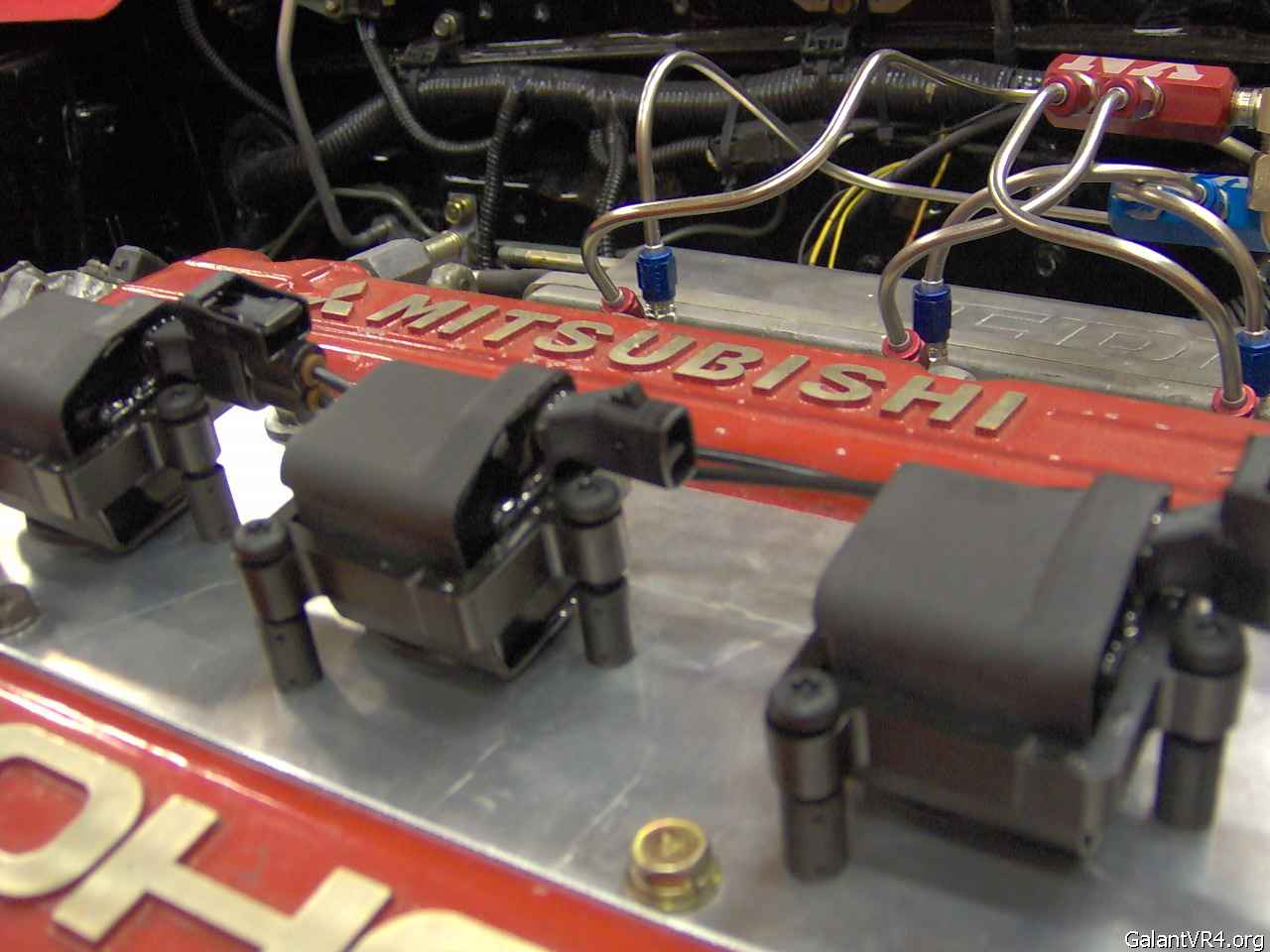

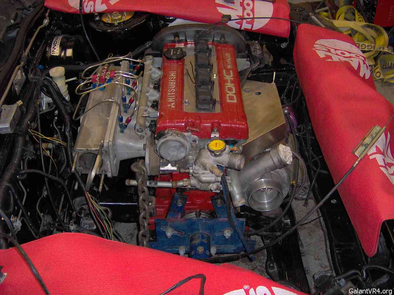

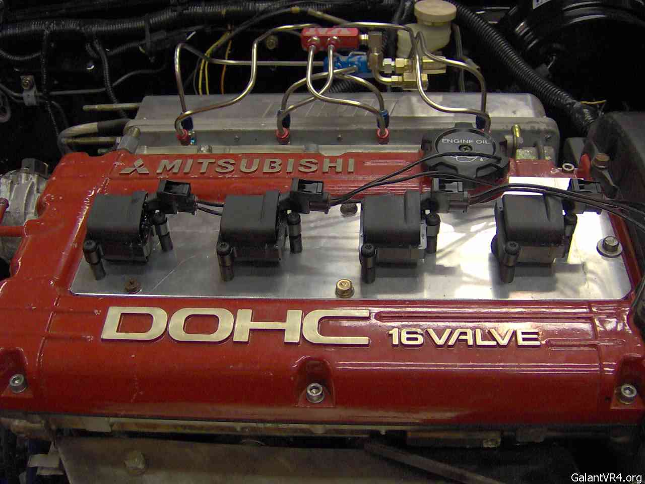

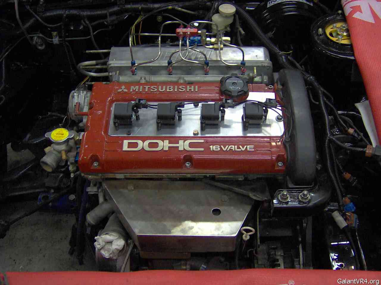

Intrepid COP setup!!!
it's probably worth it if you have the msd ignition or aem system, but other than that, I don't see how it can be better...
My buddy made his for dirt cheap a lot less than 250...pretty sure it was about 75 all together...he used coil packs out of a chrysler 300m. It looked cool and worked with his msd ignition, but he said he couldn't notcie any difference just from driving it daily, plus his rubbed up against his hood...
geoff
If you are dumping in alot of fuel and spraying nitrous you don't want your spark to blow out. So I would have to say yes, it is worth it!! Read in the how to article on curtis's setup. He said it was worth every bit of it.

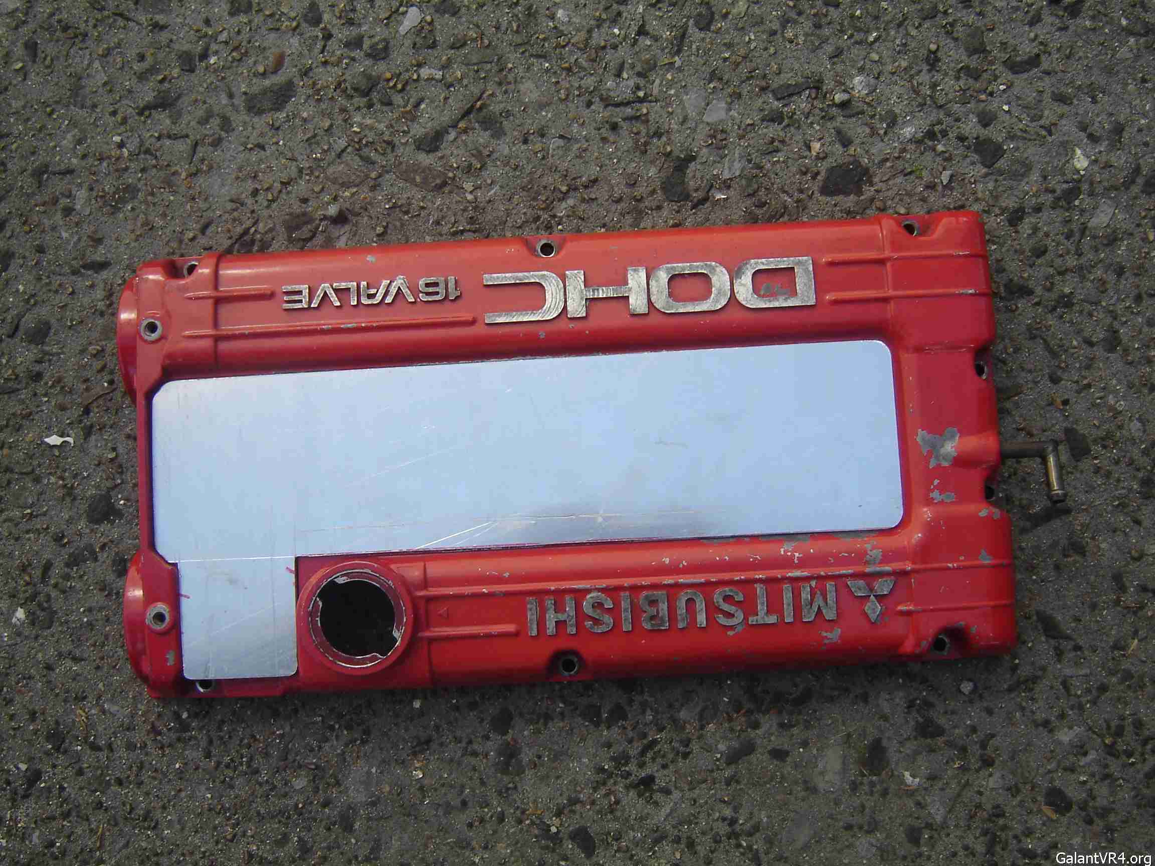

You could build one for around $50, if you wanted to use used parts, and cut your own plate with a saw or something. I get to cut them on a laser, so mine are pretty. /ubbthreads/images/graemlins/laugh.gif

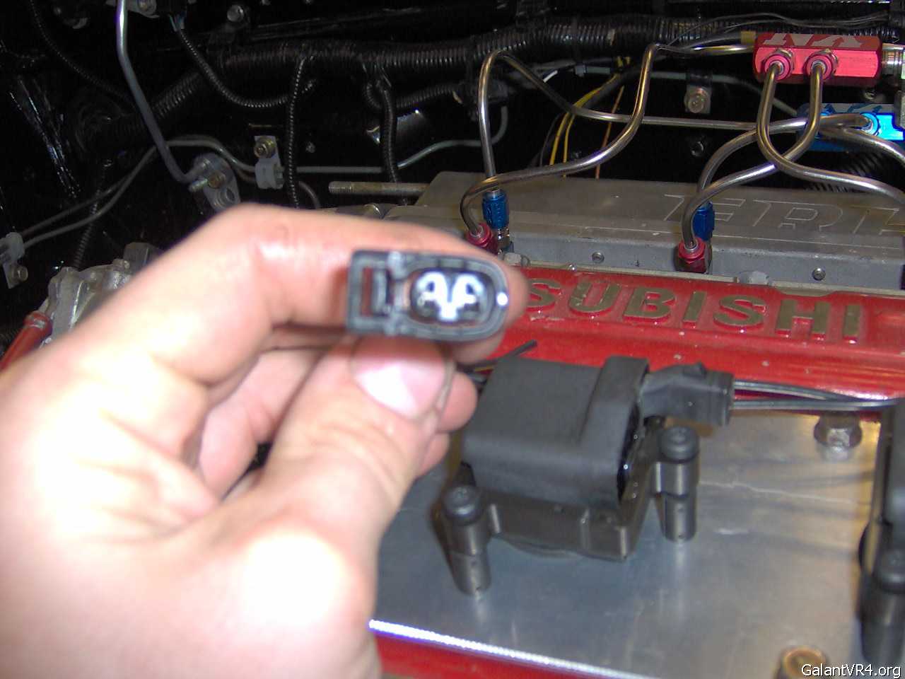

One thing I need to know is what wire is which. The splice wires that I got from toyota are black with no colors. There are numbers 1 and 2 on the connectors if anyone can help I would apperciate it. Thanks, Chris

so what you think
looks nice but I personally wouldnt bother with that COP stuff. The only standalone I run is Electromotive, which includes the coils, and Ive seen the stock coil packs support 500 wheel nicely.
May 4, 2003
11,892
Clarksville TN
You need a ride in a car before and after. They work.
It's not always about top end HP but drivability, thats where they really perform, HP and torque both go up but the off idle is crisp and the part throttle to passing on the street pulls way better.
Keep up the good work John you'll love it.

Yes, you've said that twice. Check the price,,,,, bet it's hella expensive, and your not likely to find one in a junk yard.
I will check tomarrow on price on COP my cost or your cost
Even at your cost, I bet it won't beat the $50-$200 it takes to make your own.
