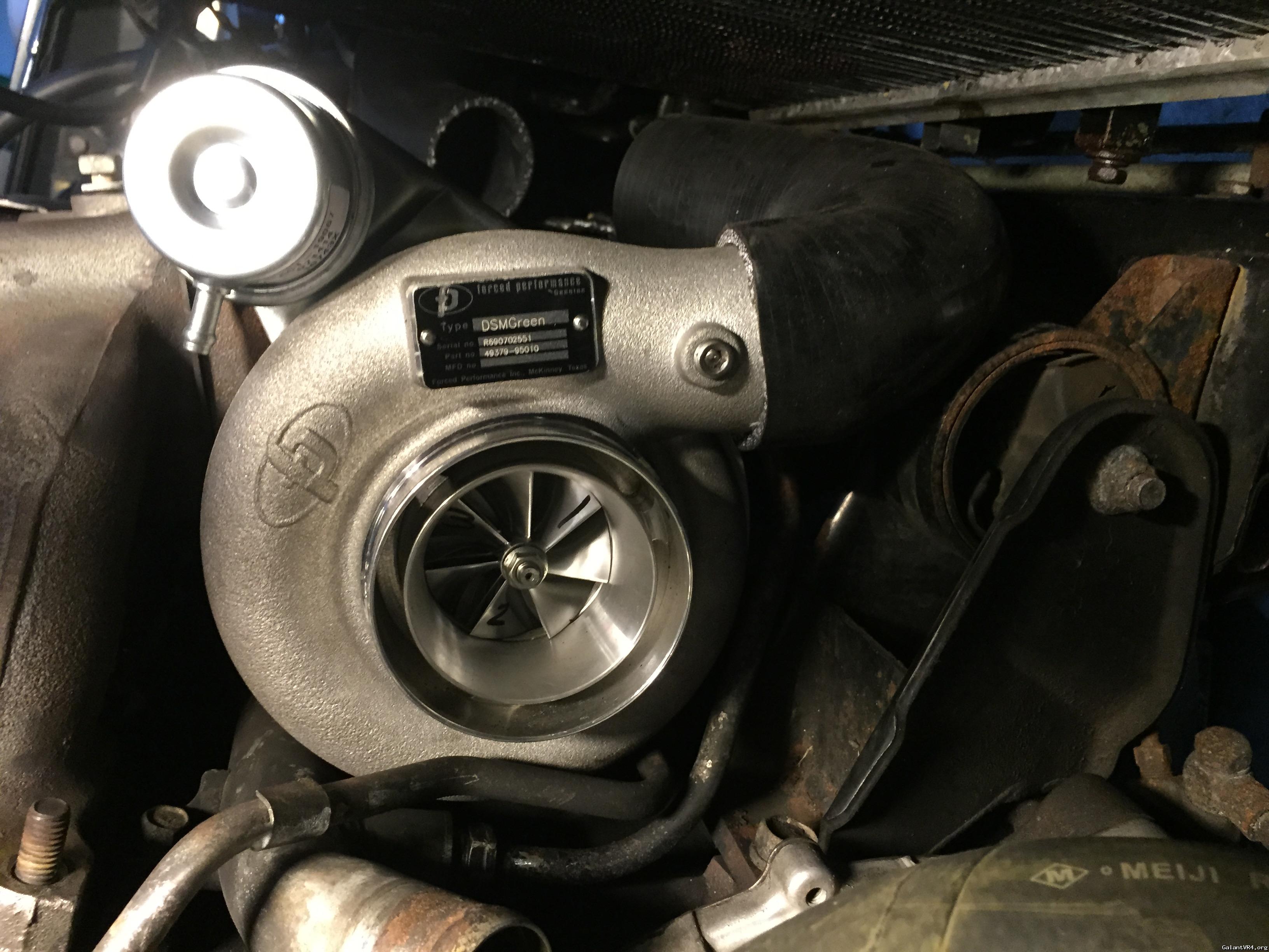

Wouldn't you clock it upwards? This would put the inlet at roughly the same spot as the stock j-pipe. There should be no mounts in the way up high.

Oops I'm sorry guys I misinterpreted his op I thought he wanted it down firing, I didn't realize he wanted the compressor outlet facing upwards until I reread everyone's post.
Just re clock the turbo and you'll be golden.

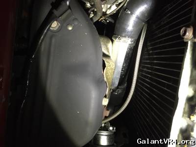

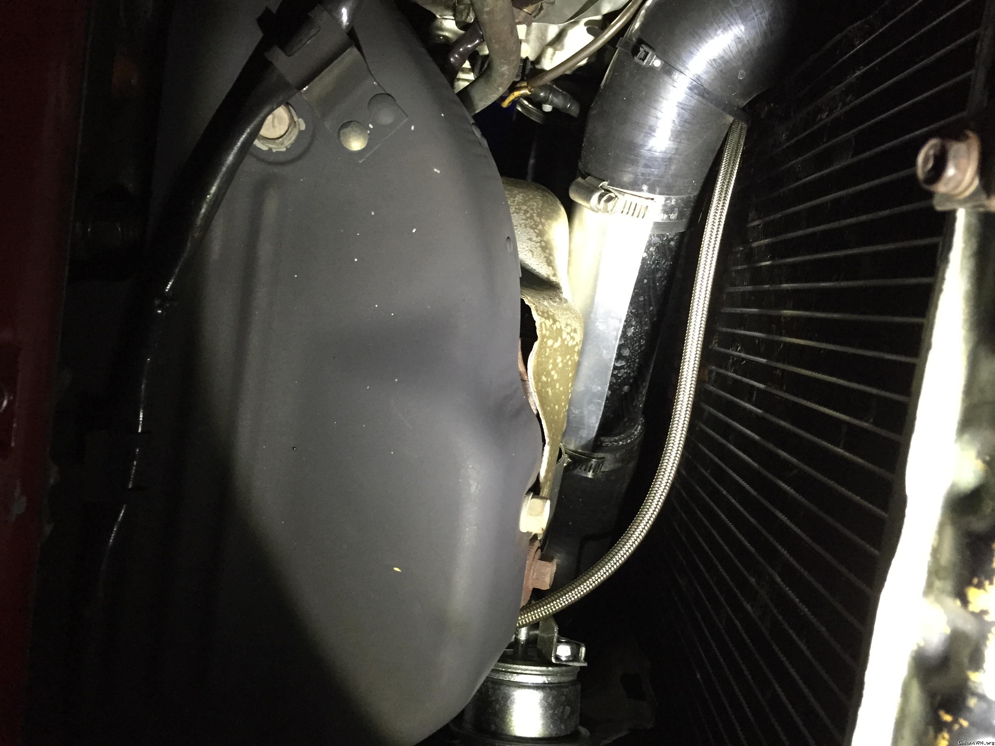

If the black is same size as green, you could use a 135 deg coupler and a section of pipe to get it in the vicinity. I think I used a 90 flush against a 45 at the other end to slide right onto the ETS IC input pipe. Also made a small heat shield where it passes near the exhaust. I removed the long vertical plate that rest against the DS radiator, and the only cut I made was to notch out the stock radiator frame right where the inside of the 90 deg coupler sits. Wish I knew a way to clock and remount the WG arm so I could go over the top to reduce the combined turns a little bit.
