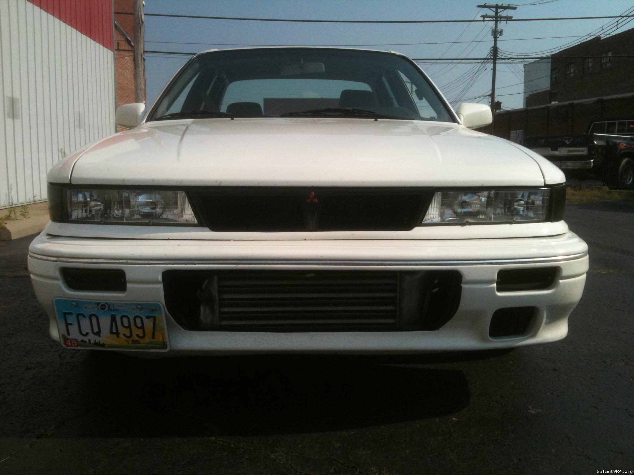

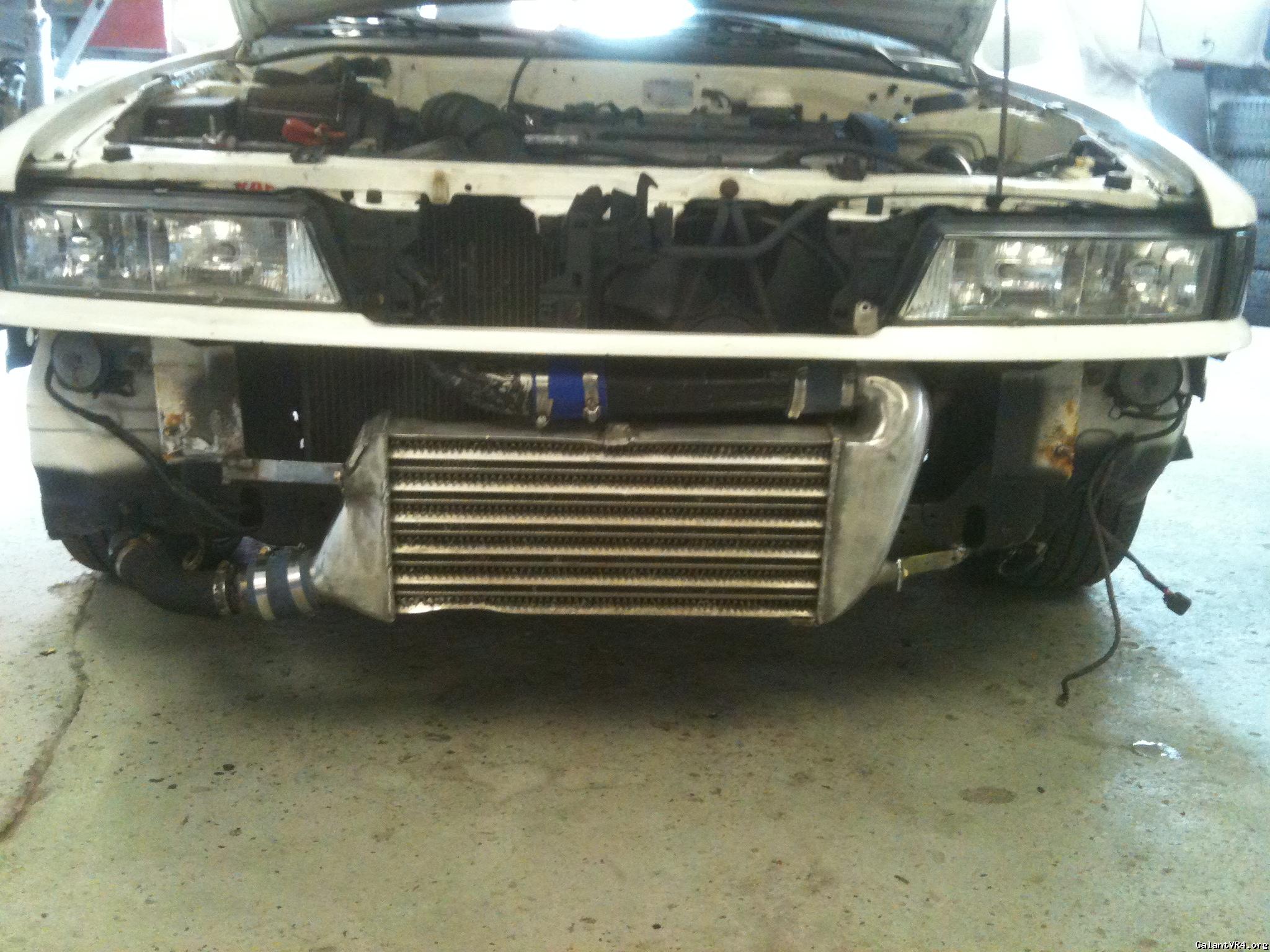

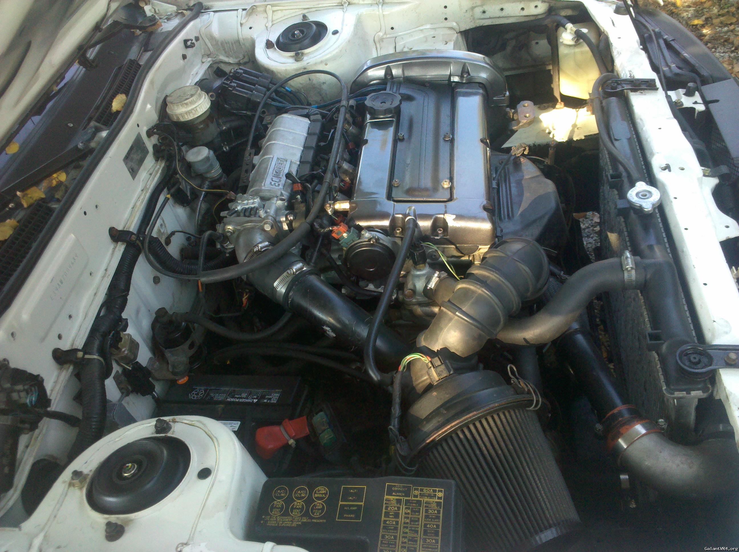

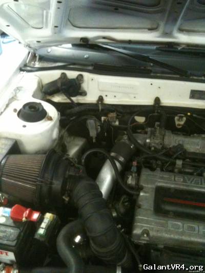

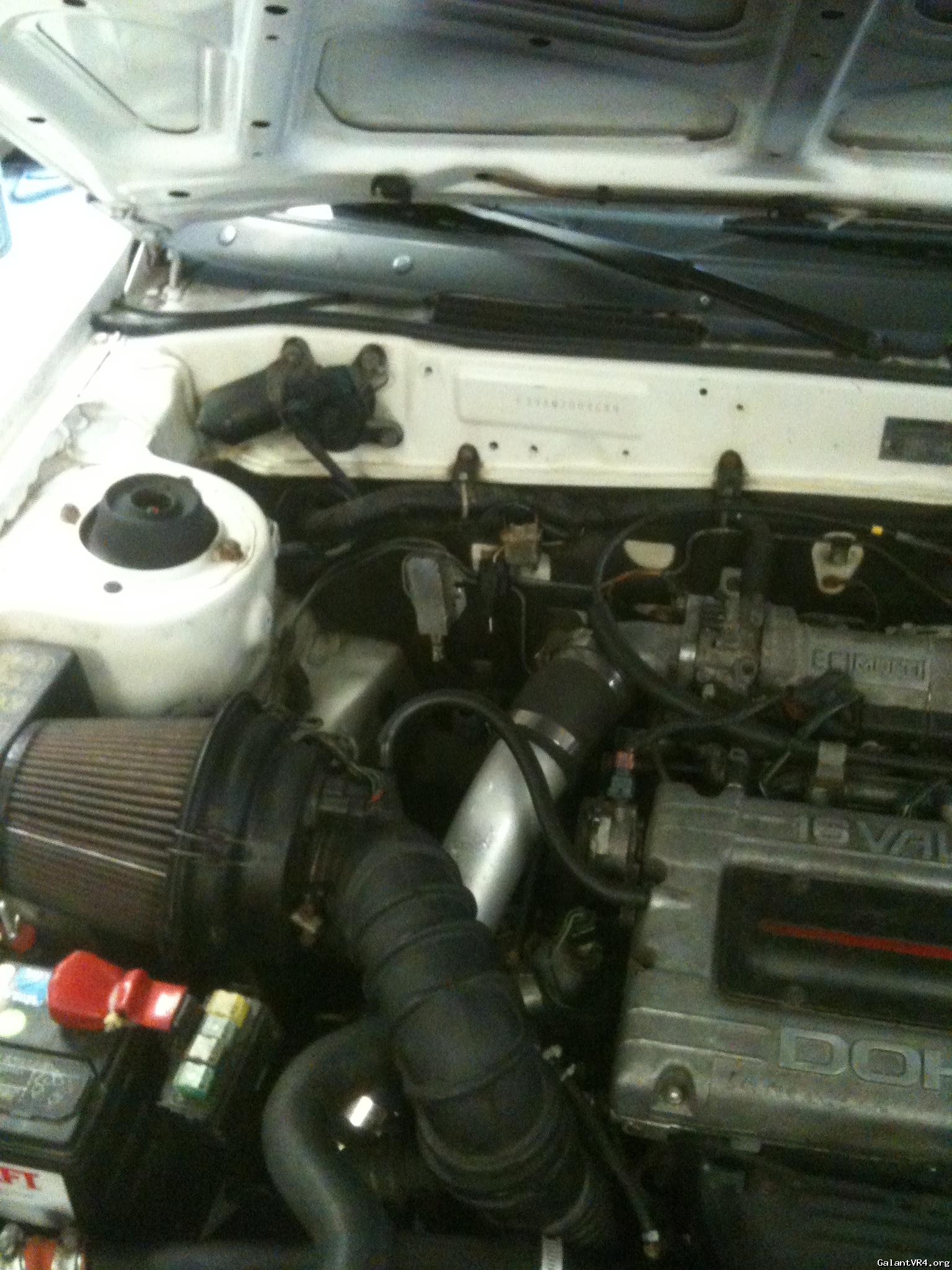

Here are some pics of mine, just because I went a different route than most. We threw it together with a spare Apexi core I had leftover from an FD RX7, and piping and couplers I already had laying around. We flipped the stock J pipe around, and used the first part of the stock hose. The upper pipe is still pretty ghetto because of the reducers we had to use to mate with the stock piping. For being 100% free, I can't complain though.
