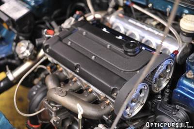

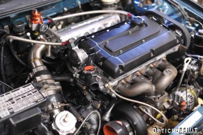

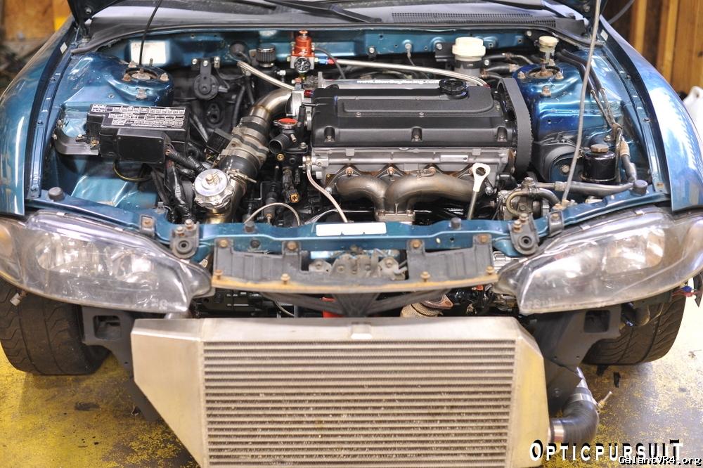

Just some eye candy for you guys. Figured id share the love of what im doing currently. just waiting on my 02 housing to come back from JMF with the 44mm gate flanges welded on and shell be ready to hit the dynno.
No im going for 500whp on pump, straight 93, no meth.
Maybe a Q16 tune, not likely itll see E85. Theres not enough places around here to get it, and its not pure at the pump this time of year. Mixed with that E78 crap for winter. Unless i get it in 55 gal drums its not worth it, and my 1050's i dont think will support the power that turbo will make with E85, also...i dont feel like running dual pumps.
Maybe down the road. But right now im just trying to hit the 500whp mark on straight pump.
Heres one more /ubbthreads/images/graemlins/smile.gif
