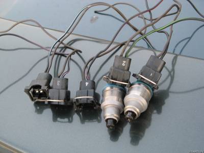

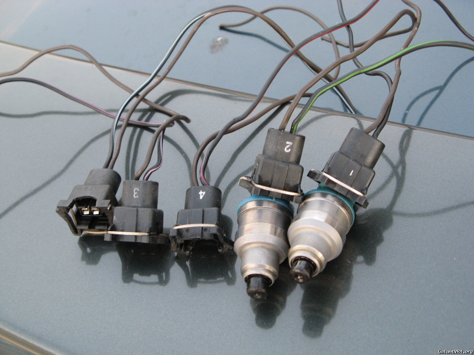

So I was working on GN and notice how the injector clips are so easy to remove. I went hunting for a set and got lucky. The nice part is they are numbered.
atc250r
Sep 11, 2003
13,235
Orange County, NY
Those look familiar:
DSMotorsport sells them but they are like $15 each. /ubbthreads/images//graemlins/uhh.gif
Injector Clips
They are under new ownership so I don't know if they still stock them but that is too pricey anyway. IIRC, they are made by Dorman (the company that makes nuts, bolts, clips, and other assorted automotive stuff). I bought them from DS when the old owner was doing an inventory reduction sale for like $20. It was definitely money well spent.

Yeah, they have to be squeezed to be removed. These are just really easy to get. I tried to look it up on Dorman's site but they are having some database problems.

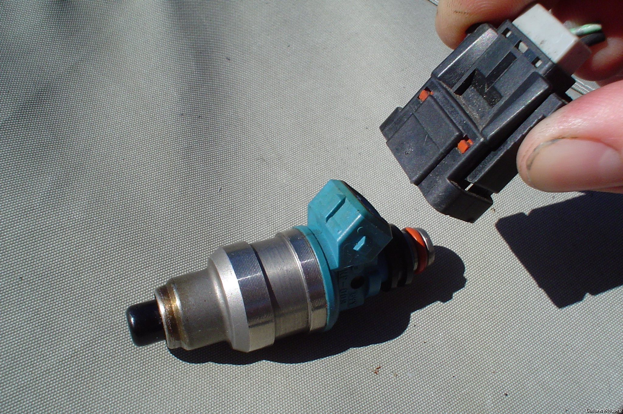

don't the 2G's have no little metal clip lock? would they be the most ideal?
Thats what my 1g has and they are awesome. So much easier than stock to remove and install. I thought you could buy the 2g plugs but maybe the PO just cut them off at a junkyard, either way it would be well worth it.
strokin4dr
Aug 30, 2005
2,770
Savannah, GA
^+1

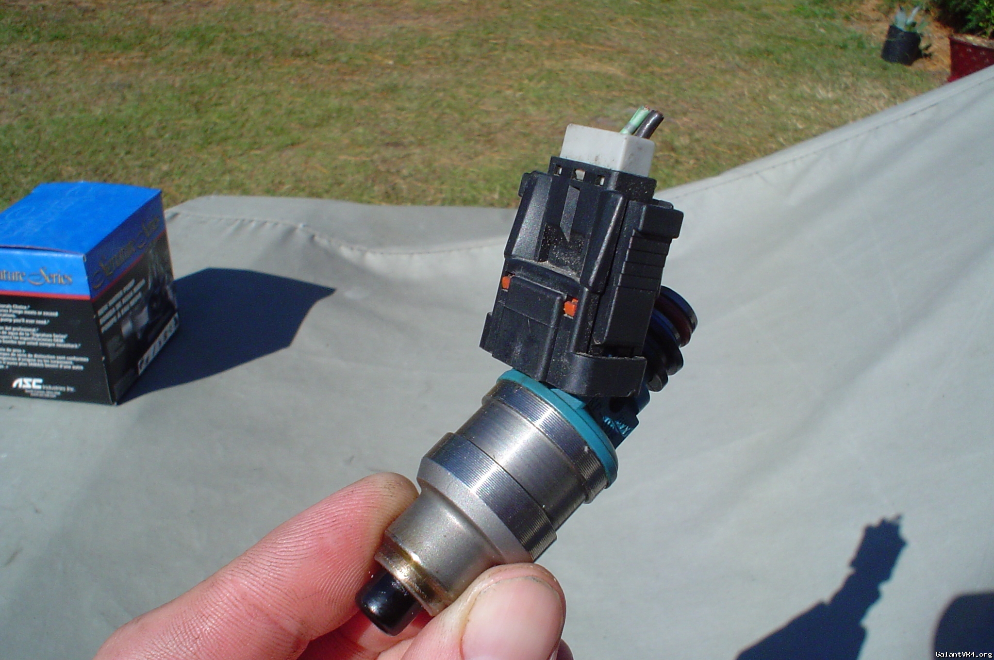

The 2g N/T plugs rock! Also, there is no need to cut and slice when you use them, like the ones shown above.

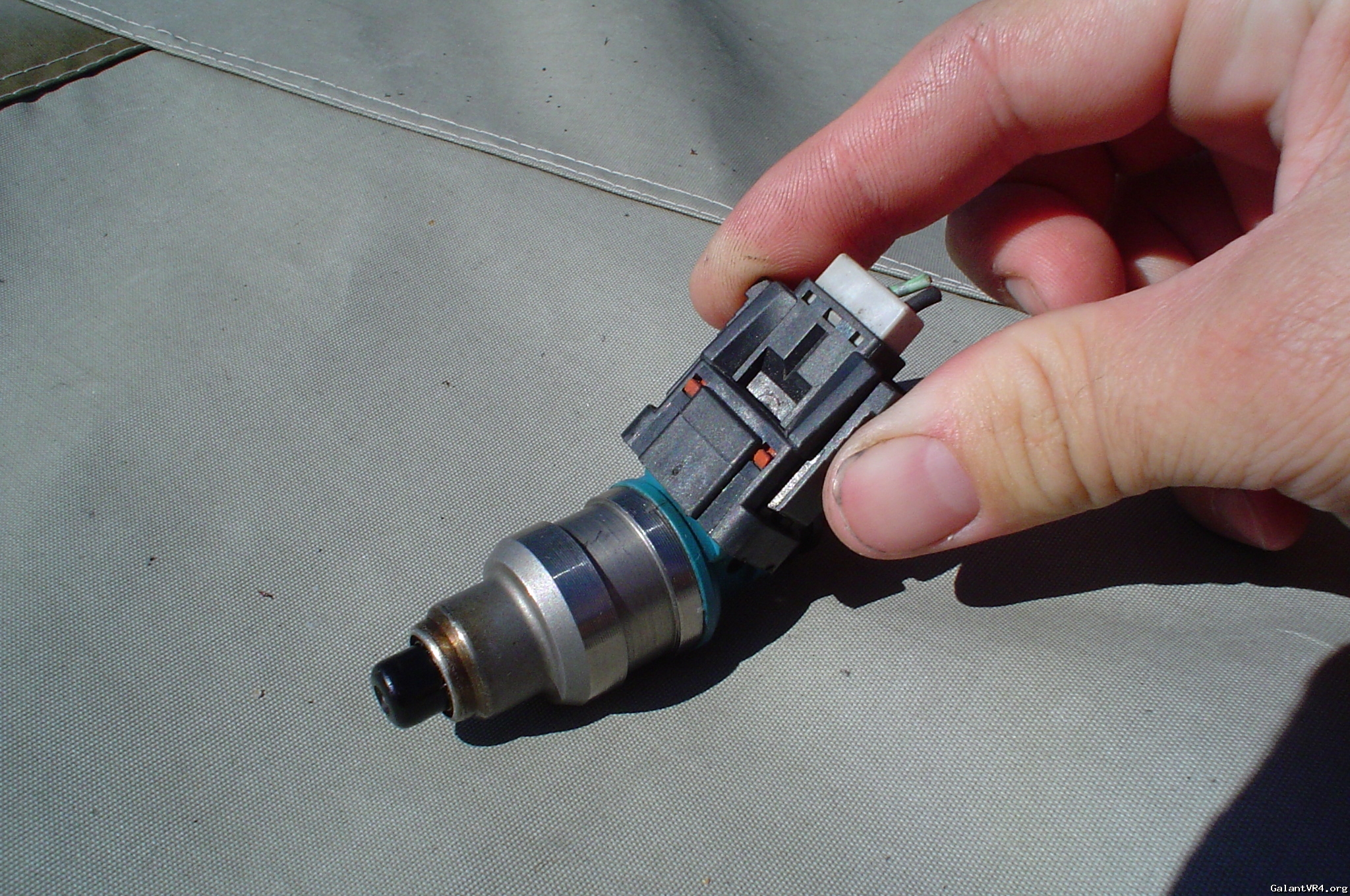

I don't understand why you would want to crimp or solder any of the wires for the injectors. With these, (see pic) all you have to do is de-pin the two wires and insert them in the new clips. Plus, they look and function much better that the other ones being discussed in this thread. I just don't get the whole "cuttin up the harness" way of swapping clips /ubbthreads/images//graemlins/uhh.gif.

Well Ryan, I know you have a lot of experience with this, but the GVR4 terminals were not identical and did not fit properly in the 2g connector body IMHO.
It is not EXACT, but they do lock in place and will not pull out. It anyone wants to try it, you will not be disappointed.
