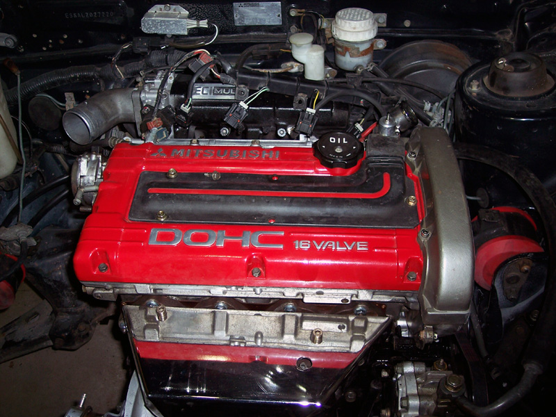

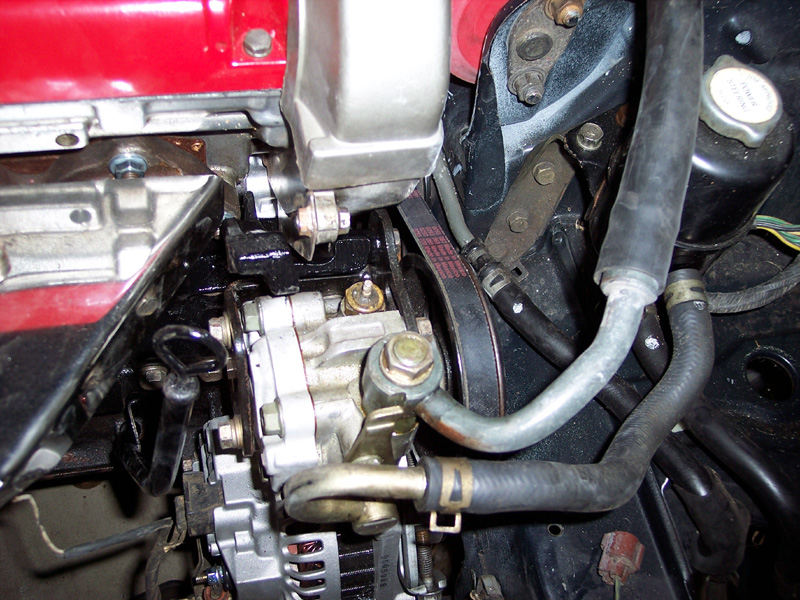

2G power steering set up on your GVR4
IncorpoRatedX
May 28, 2003
5,593
Arizona
I've got a lot of 2g stuff laying around so tonight i decided to toss the 2g power steering pump etc on the car. I guess just for the sake of looking newer and to be a little different? /ubbthreads/images/graemlins/dunno.gif I'm a ricer, i know.
so far i have, 2g exhaust manifold, o2 housing, 2g trans, 2g slave cylinder, 2g injector clips and now 2g power steering pump. lol.

Pump, both pulley's, bracket.
So detail this for us. What parts did you have to change? Bracket? Pulleys because it uses ribbed belt not a V-belt?
need:
-2g inner water pump pulley to drive the power steering pump
-2g PS pump
-2g PS pump bracket
-2g belt .5 inches shorter than stock. I believe it's a 27in belt.
