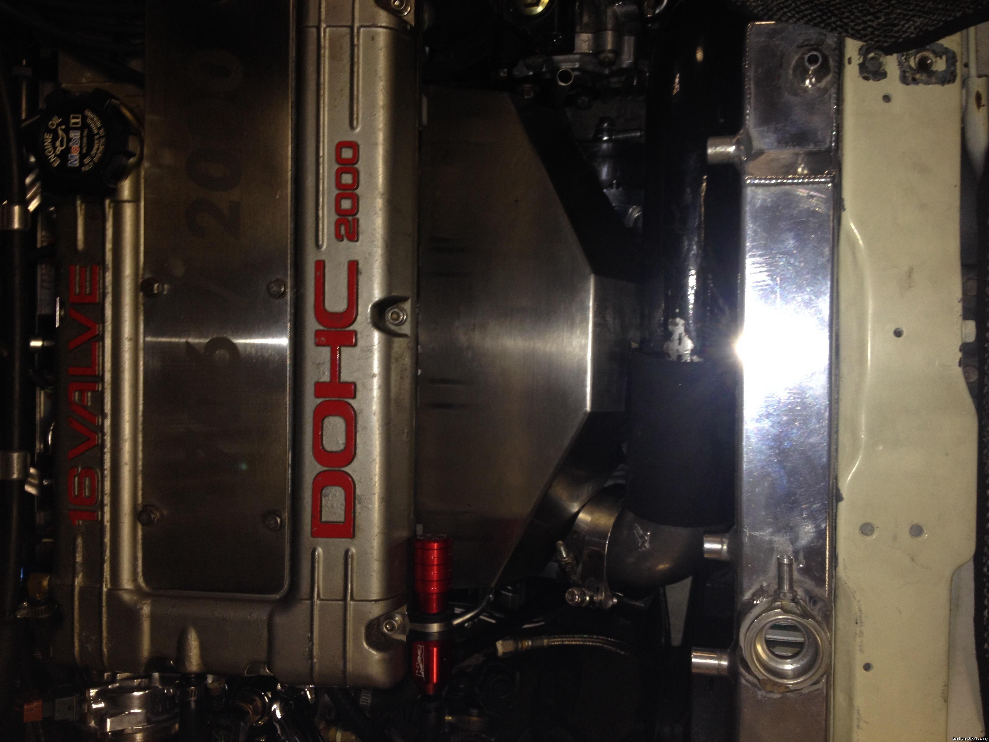

I just finished my setup with similar issues.
The problem with mine is the intercooler pipe does not fit inbetween the radiator and exhaust manifold.
I got a polished sheild like the ones jnz sells now.
I also heat blanketed the turbine and exhaust manifold.
My radiator ended up with a hole in were the intercooler pipe hit radiator when installed.
I put a 05 civic radiator in for temporary use.
My engine intake temps seemed much better even with tiny civic radiator.
Here is pic with heat sheild installed when I had fluiddyne radiator installed.

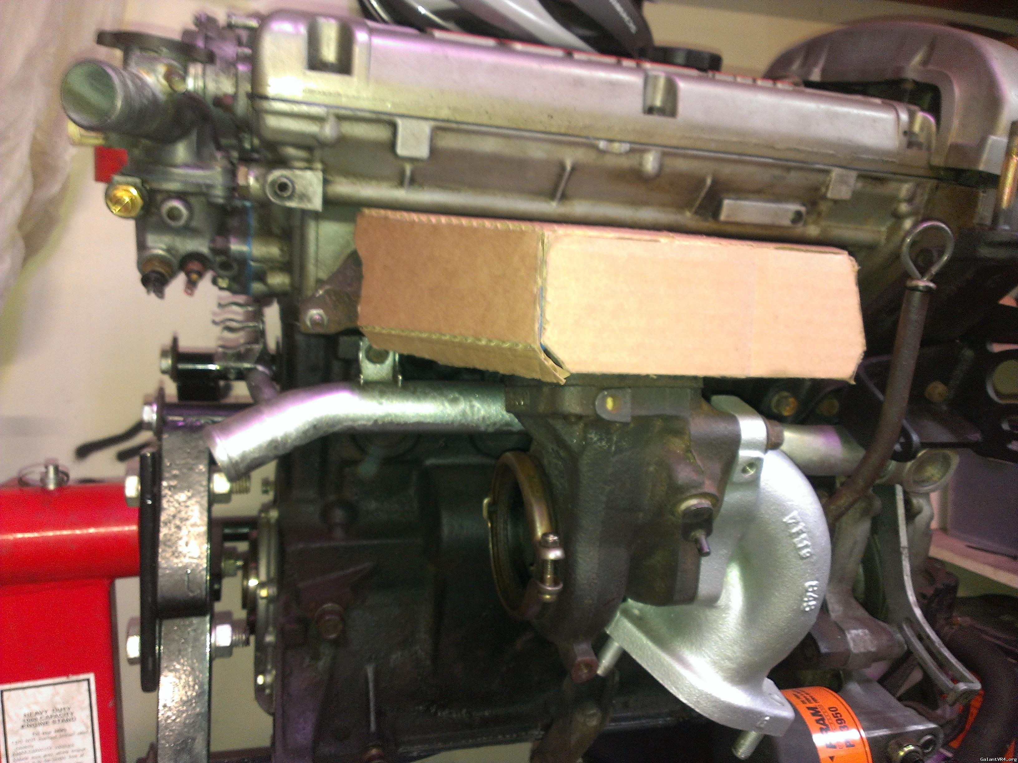

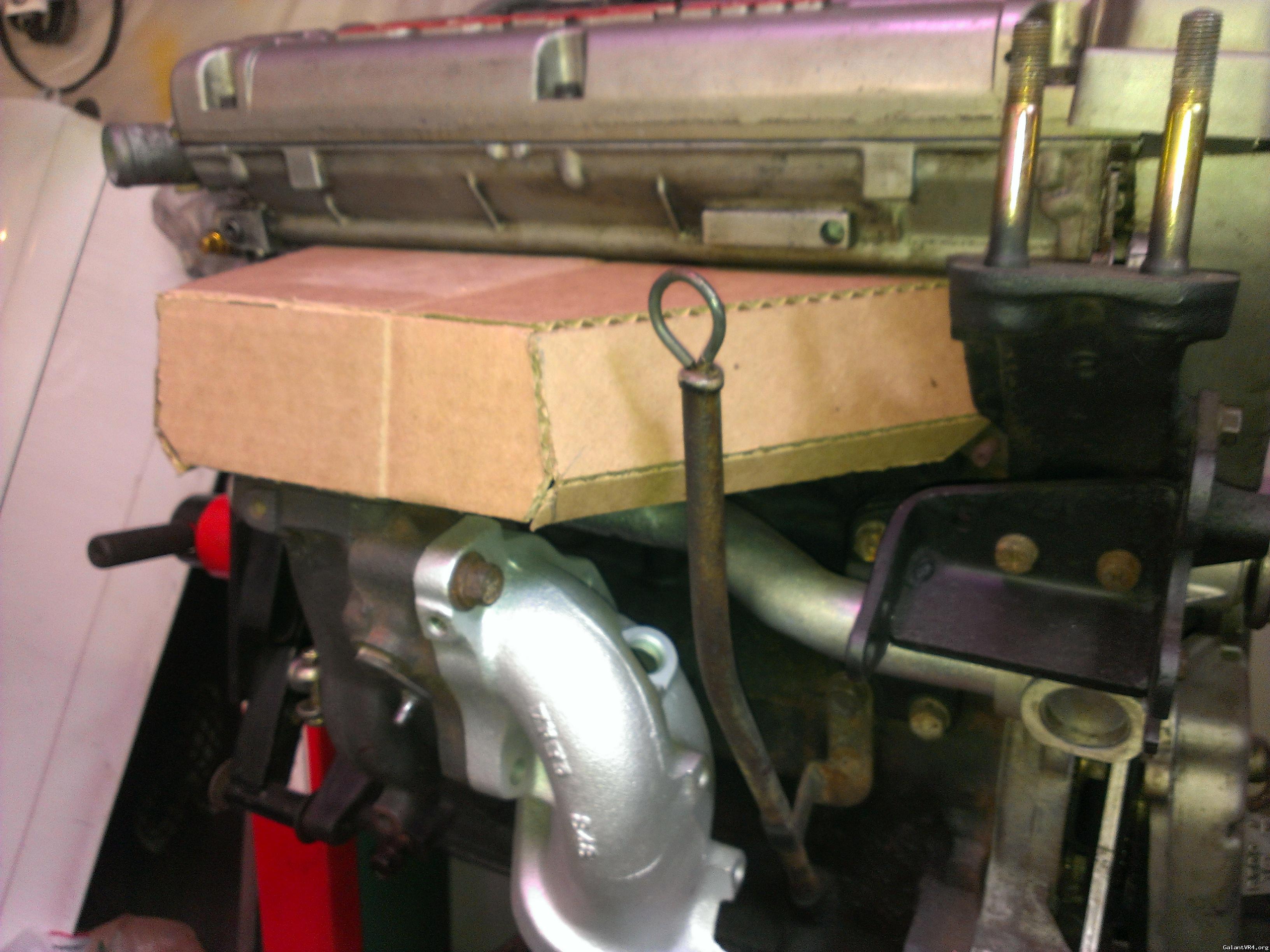

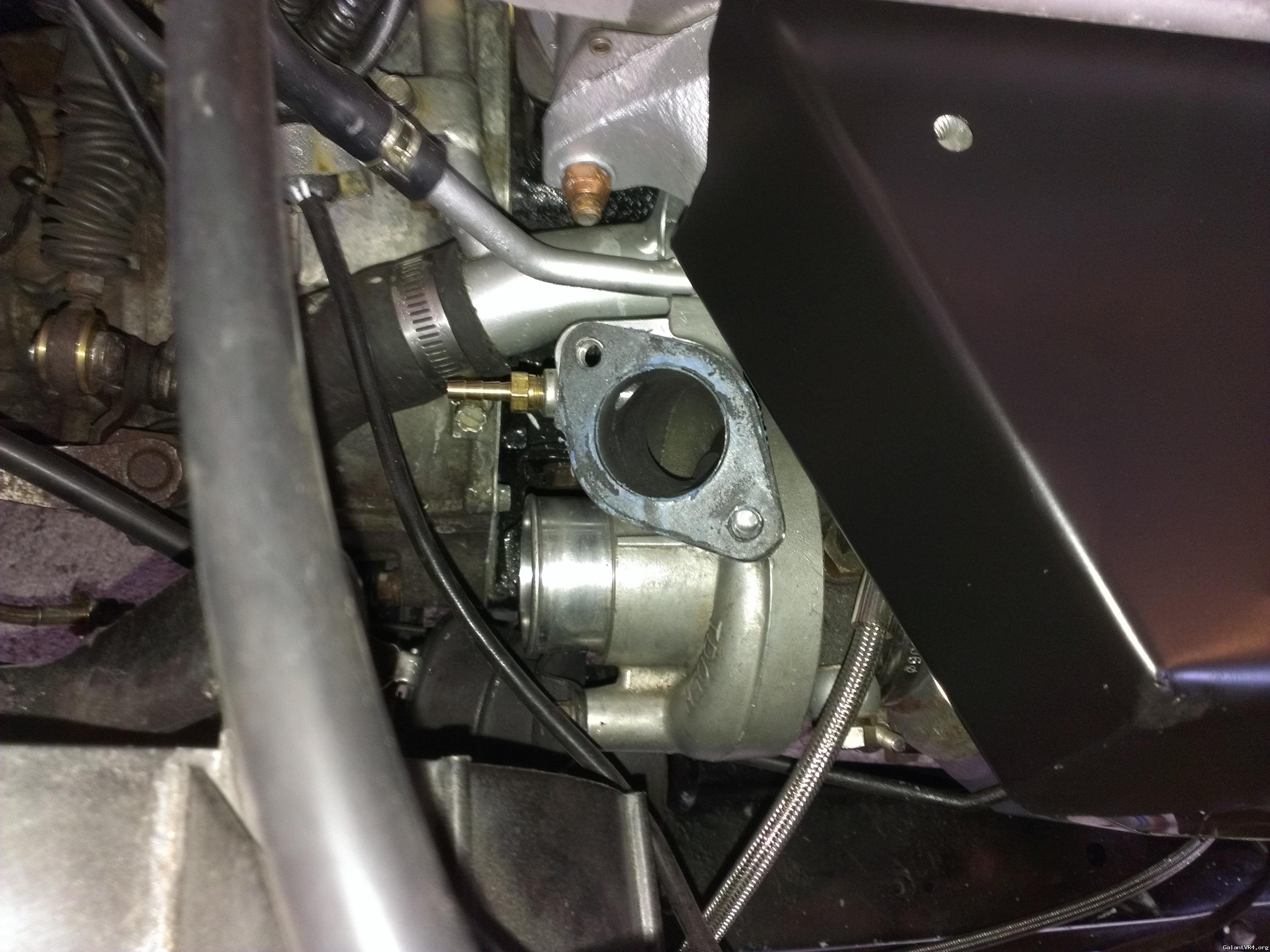

this is posted somewhere else on here. But this project was originally inspired by this thread, and dead alternators.
Also tapped my turbo housing today, but you can see the installed shield.
So now I have ceramic coating inside and outside and shields.every little bit helps. Would really like some hood vents next.
