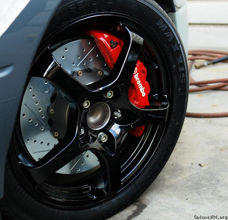

In the off chance I get a flat during a drive to Seattle or on any road trip, I need something that will allow me to limp the car to a tire place. For the past few years, I have had the stock 4-lug spare in the trunk and crossed my fingers that if I did get a flat, it would be a back tire since the front brakes won't clear a stock spare wheel. I could always swap a rear to front and put the spare on the rear if I got a flat up front, but what a pain in the ass that would be on the side of the road with a scizzor jack. Now that I have the 5-lug swap in place, I have nothing. /ubbthreads/images/graemlins/uhh.gif I suppose AAA would work also, but I'd feel more comfortable knowing I had a spare.
Would a stock Evo spare work since it should be able to clear their front Brembos?

The EVO VIII six spoke clears 3KGT four pot brakes and rotors at the front with about 3mm to spare using the whole 3KGT knuckle/hub. Consequently if a 3KGT wheel works, the EVO should too.
I wish I had bought a spare EVO rim for my car now, I am in exactly the same boat. I think my chances of picking up a single rim over here are minimal.

FWIW, I know FD RX7 wheels will clear the brembos on an EVO. There were several EVOs running 16" RX7 rims at the Shootout. I was surprised.
