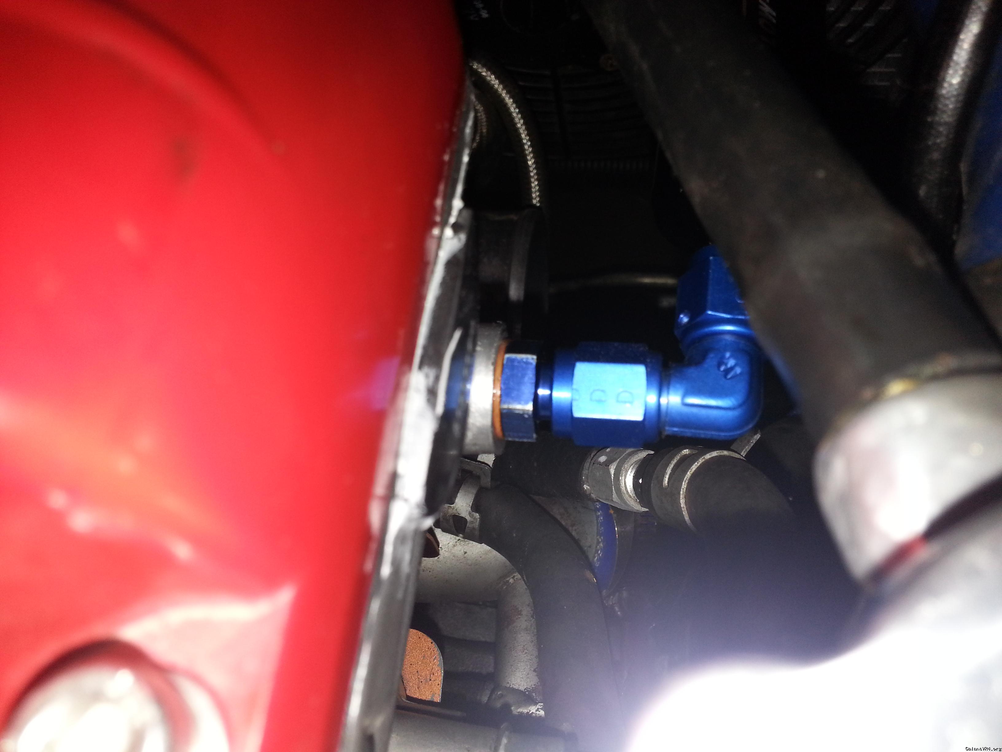

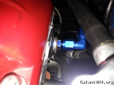

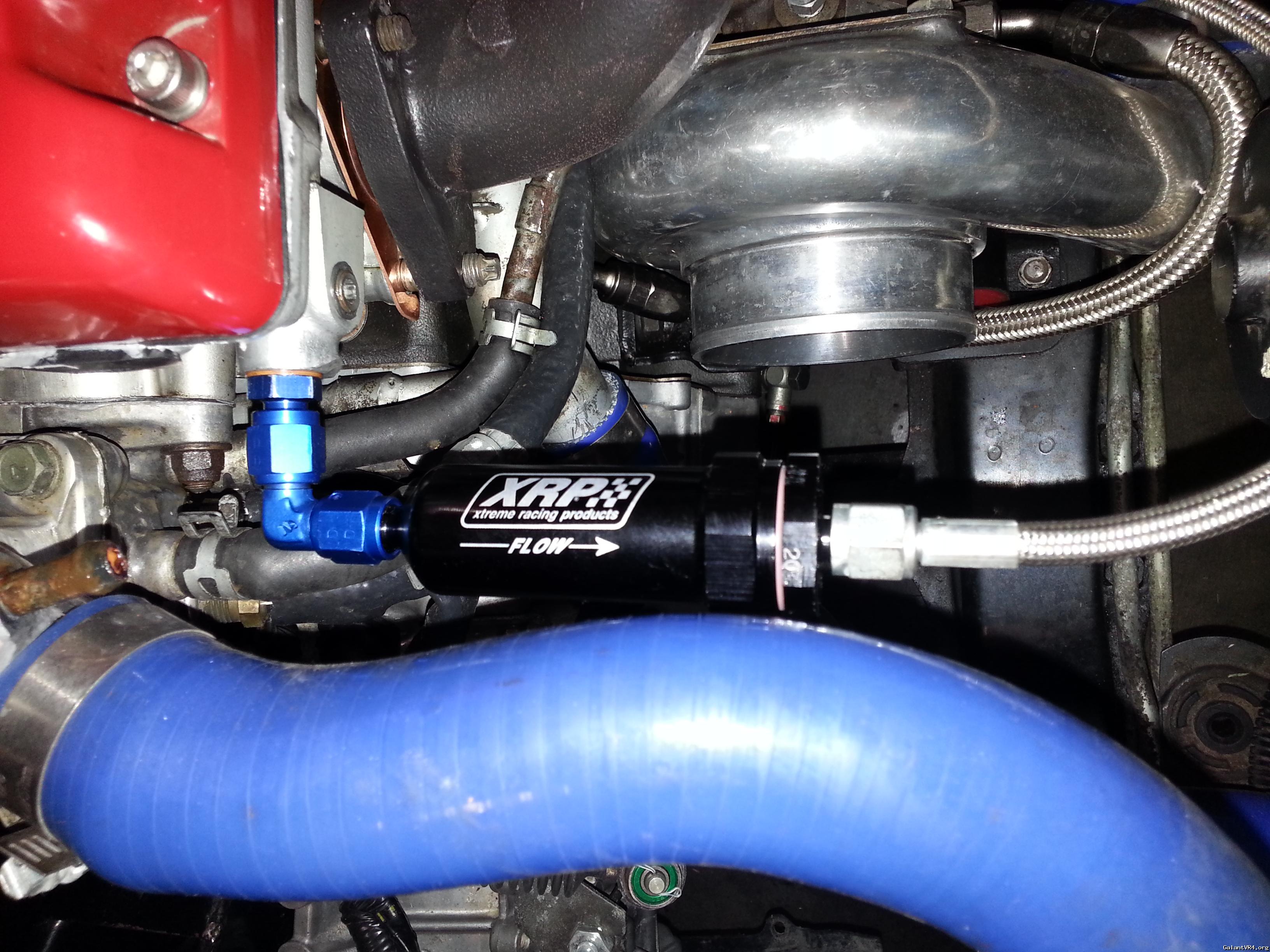

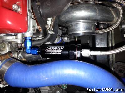

Even with new "crush washers" the banjo fittings seem to be crappy. The bolt that goes thru is weak, and tightening them to where things are snug enough often results in stretched banjo bolts.
So i did this:

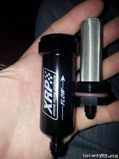

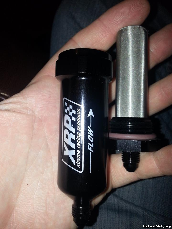

4AN to M10*1.25 adapter Blue - Plenty of these FS on Ebay from various sellers. I got mine shipped from Taiwan.
Russell 614504 Coupler 90 degree -4 AN Female--4 AN Female Blue
XRP 704404FS20 - -4AN inline 20 micron filter
I really like this filter. It's got a huge element, and seems to be fairly "free flowing". This actually looks like a better design than what FP is selling, and it costs a bit less.
I believe some vendors are selling these filters in the 10 micron variant. I figured the 20 micron might be slightly less prone to clogging (50% less, actually) and will still do the job. You can get them in 10, 20, or 40 micron and larger, i believe. The XRP filters come with 2 different O-rings, and instructions on what to use each one for, depending on what fluid is being transferred. (This is a FAR superior design to the blue Earl's inline filter i used before, which had aluminum crush washers for sealing, and a 100+ micron screen) If you wanted to get a 10 micron, you'd just change the last two digits in the P/N to 10 rather than 20. I got mine from a company called Western Performance Online.

Ball bearing turbos dont like a lot of oil pressure. Not only is it fed from the head, there's also a restrictor on the oil inlet at the CHRA.

I should also add that i did this primarily for the same reason you see the exhaust manifold is just sitting there. After about 200 miles of driving on this fresh build, i noticed some oil on the block behind the turbo. I'm not sure if it ran down from the oil feed and migrated across the HG, or if there is another issue. I wanted to make damn sure it's not an oil leak from the crappy banjo fitting i had with the -4AN nipple on it. This should seal far better and be easier to service/maintain if the head has to come off later.
