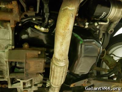

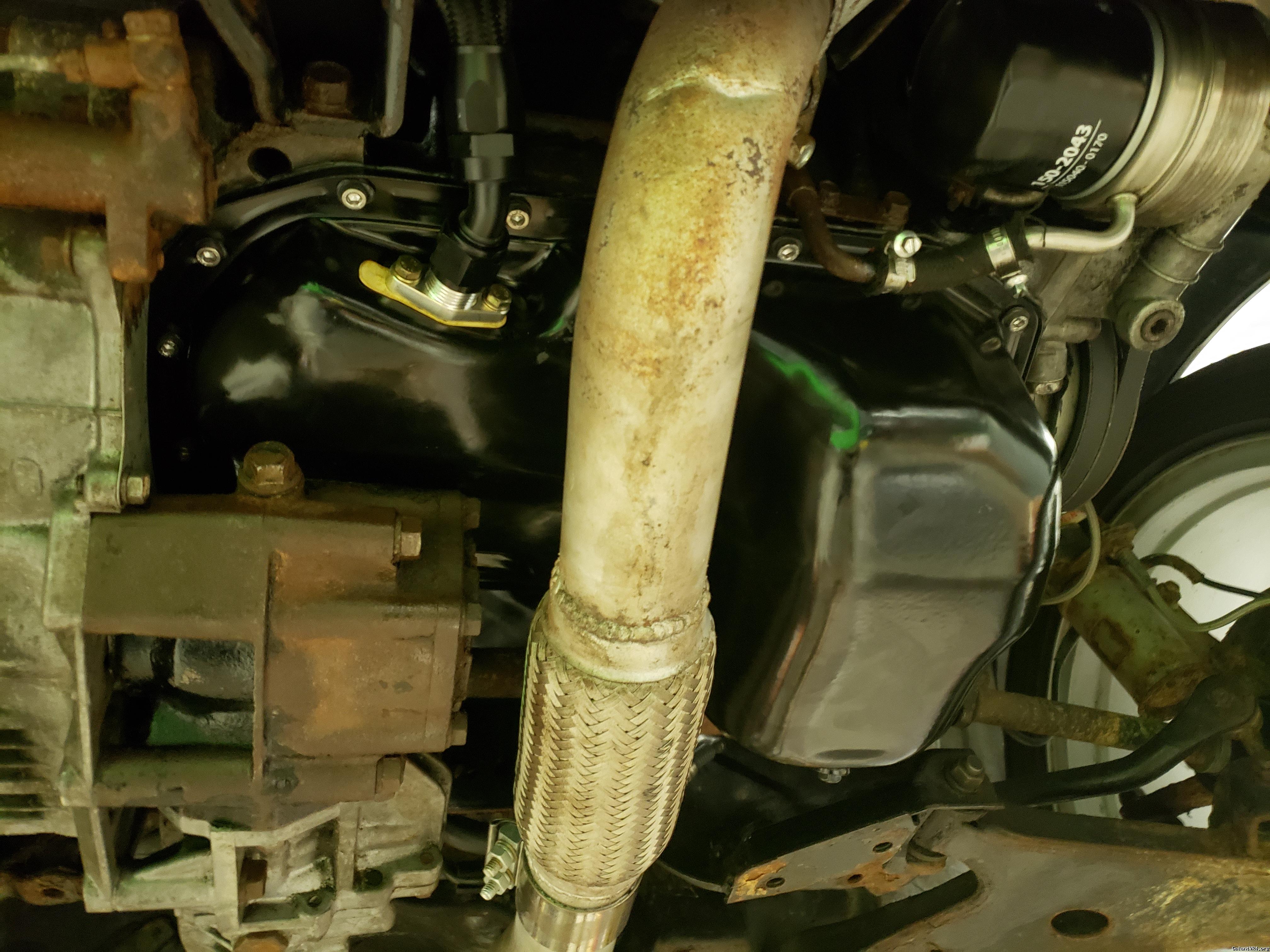

So I finally took some pictures yesterday because I installed Evo VII wheels yesterday that a got from a very nice USCG police officer on Staten Island. Wheels came right off his black Evo VII, super sick to see it in real life. Also wanted to install a new oil pan because my old one was leaking. I purchased an STM -10 oil return line setup and installed that too. I feel like I received a wrong 45 fitting though because it seems pretty hard to get the line to angle nicely to the oil pan and of course i kinked it. So tonight i went back to the shop again and installed the stock return line back on for the time being until i re make the other line. Besides that, the oil pan install was extremely easy, removed the down pipe, removed 5 17mm bolts out of the transfer case and slid that out of the way. removed the 2 13 or 14mm bolts on the axle bracket and from there i was able to remove the old oil pan. Very happy with the inside of the bottom end visually, cylinder walls looked nice and clean with no signs of potential destruction. Installation wasn't too bad, was a little pain in the ass to sneak it back on but not impossible. Very entry level DIY job, installed STM stainless hardware. Happy with the end result.

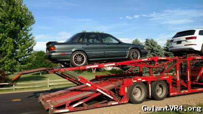

This is the car when it was picked up from iceman's house last summer.

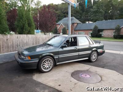

These are the Evo VII wheels I put on 828, I can not find any pictures of an E39A with them on.

Car looks great and progress is coming along wonderfully. I really dig those wheels. Can I ask why you are going to a larger return line? I can't find the for sale post, but I thought this car had a stock turbo on it.

You may want to get an AN fitting size a little closer to stock. You really don't want to go to big because allowing to much oil to leave the turbo to fast will cause starvation and eat up the journal bearings and your center section.

Good to know, well as of right now i have the stock return line on and will upgrade to the -10 whenever i upgrade the turbo. Thanks for the input sir.
10,992
Did you use a OEM pan or an aftermarket (Spectra?)? I had removed the OE, put on a Spectra which then proceeded to have the drain plug mounting boss come off later. Put the OE back on, but could never get it to stop oozing/leaking slightly.

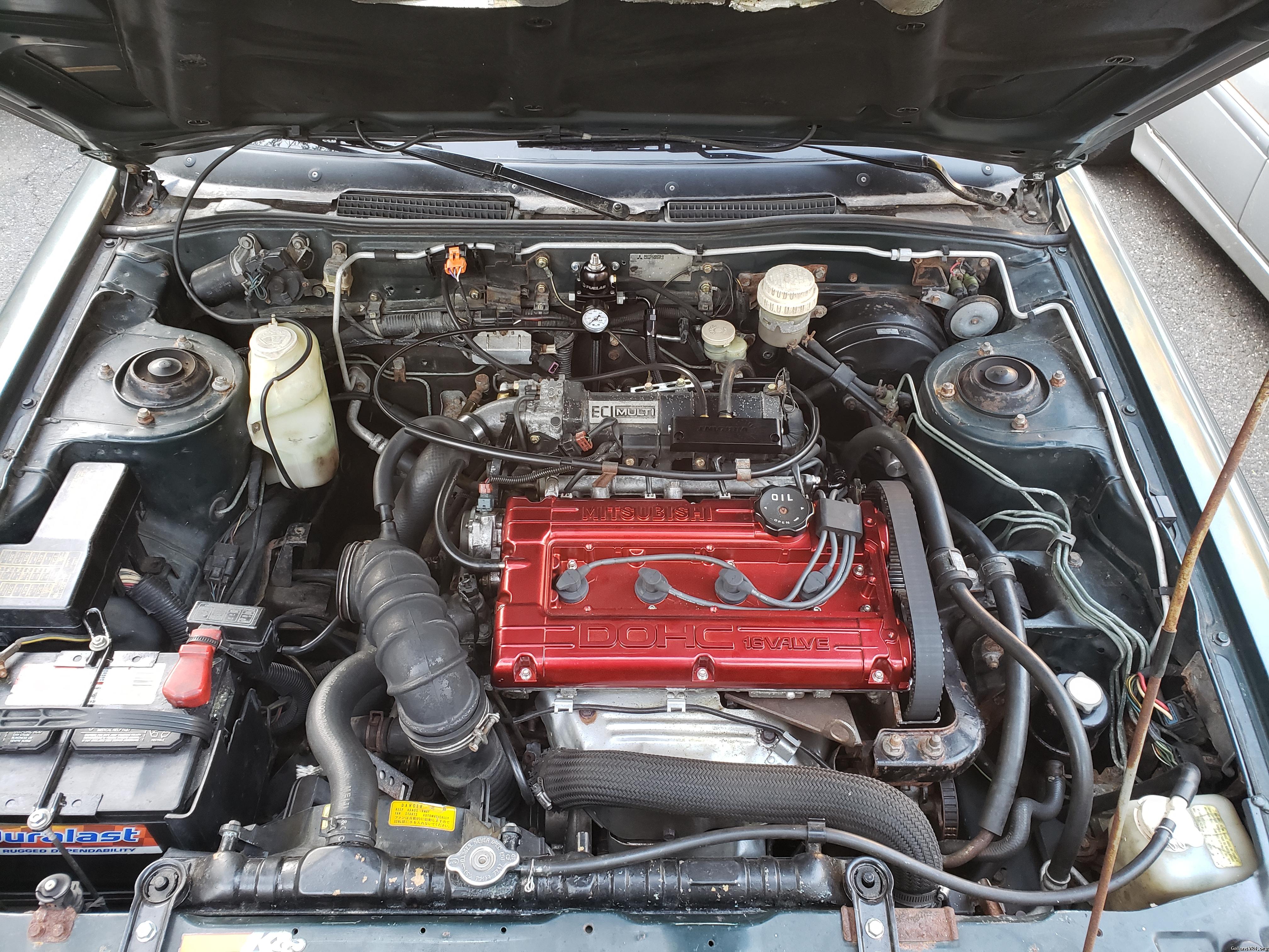

The engine should be clean inside as it as rebuilt in 2011, then the head was redone in 2014.

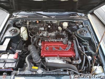

Yes iceman, and the inside of the engine is pristine. Took a little while to figure out all of the mechanical issues with the car but I didn't mind since it made me get to know the car pretty well. Still have a lot to learn but I've covered a lot of ground with it so far. Will post more pics of the car tonight.

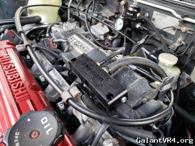

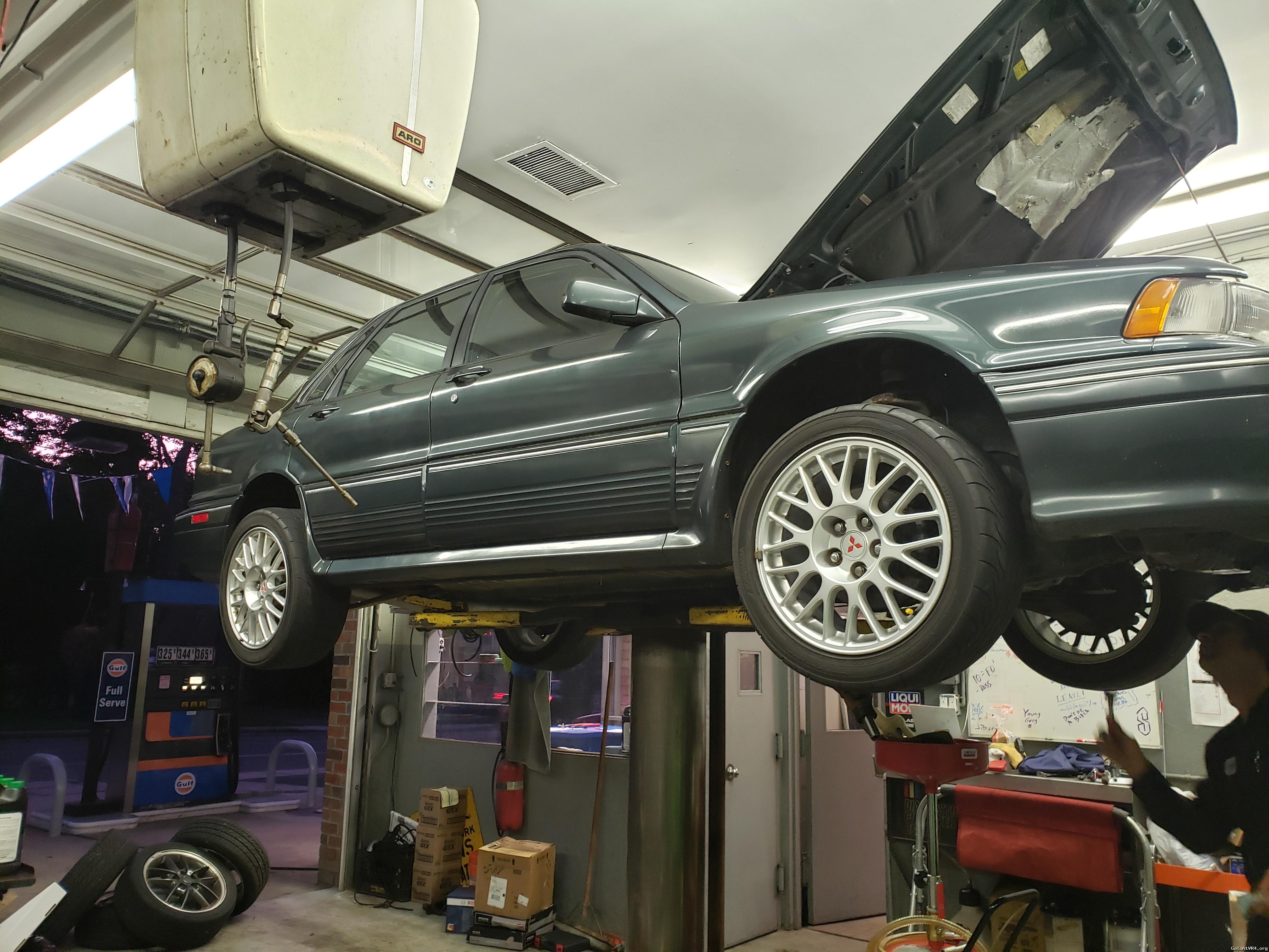

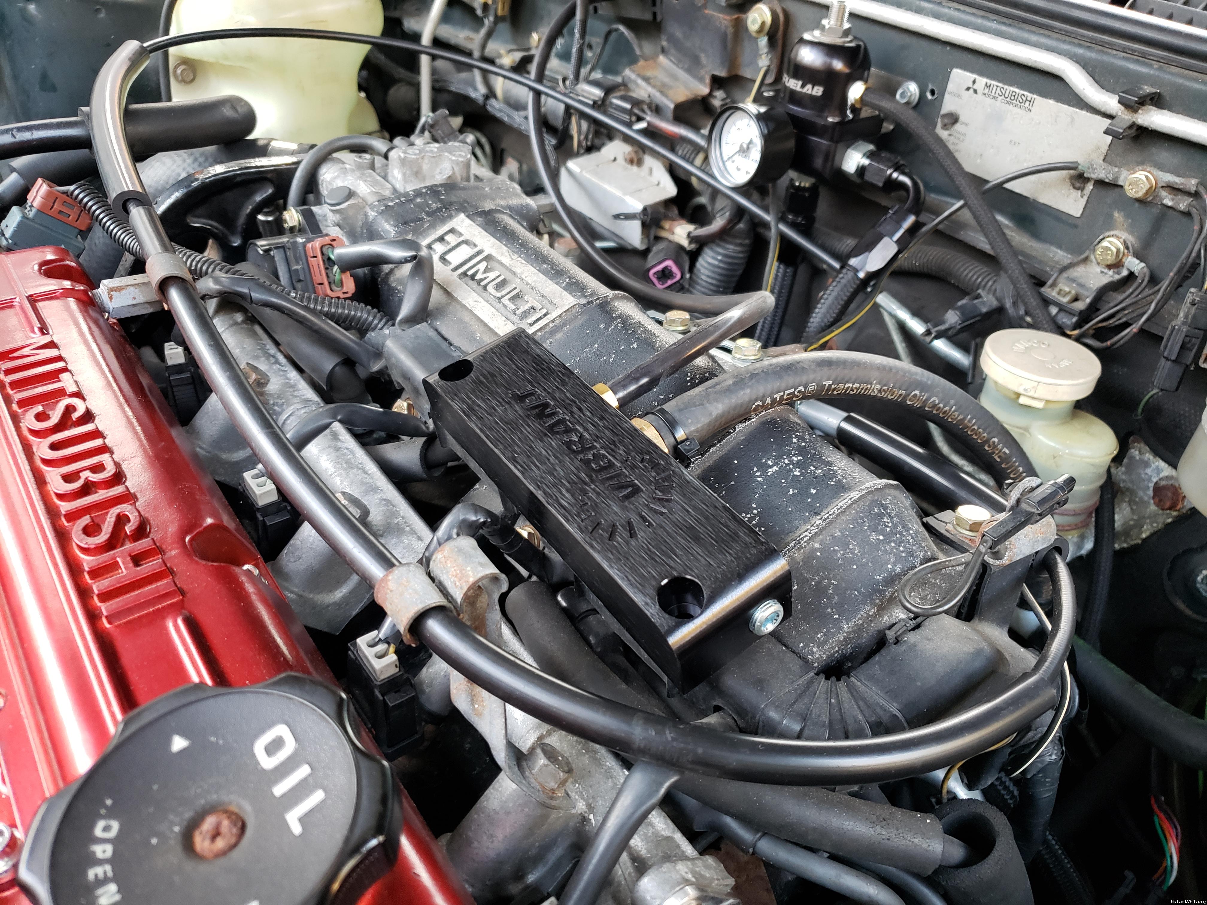

Went to the shop today where 828 is at, dialed in the boost a little bit at a wopping 13psi. Fist time the car has ever seen some sort of boost other than wastegate pressure since I've owned it. I know I haven't documented the journey this thing has been on since I've received it but it has come a long way.

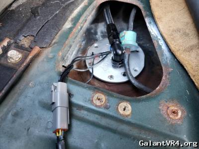

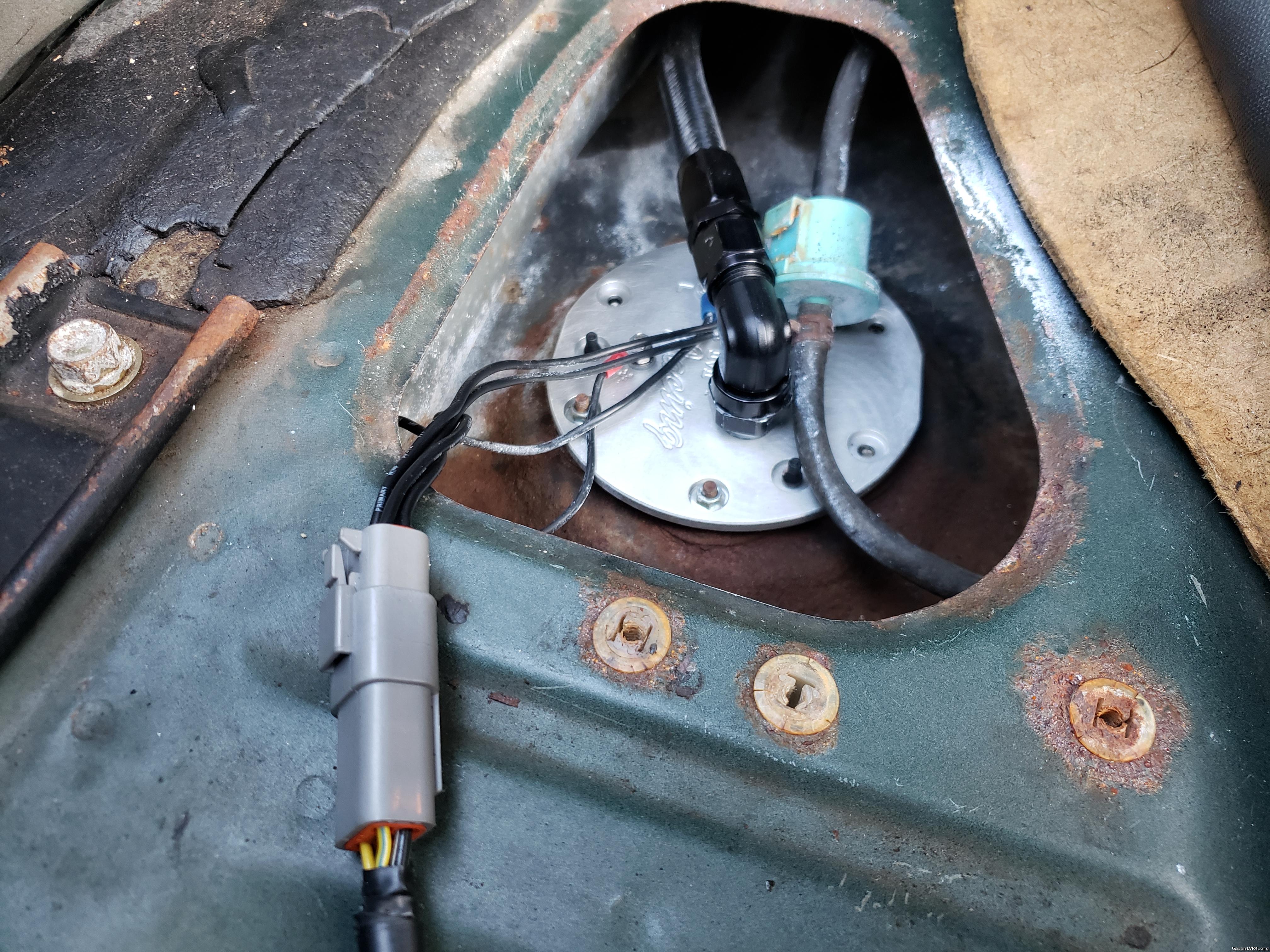

It's the RTM Racing single pump system, they also make a dual pump. It works with the factory fuel level sender and low fuel level light, and then i installed a new deutsch style connector.
