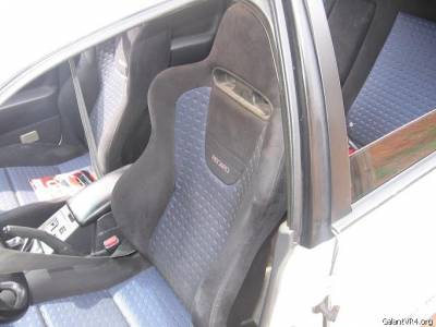

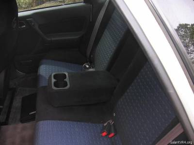

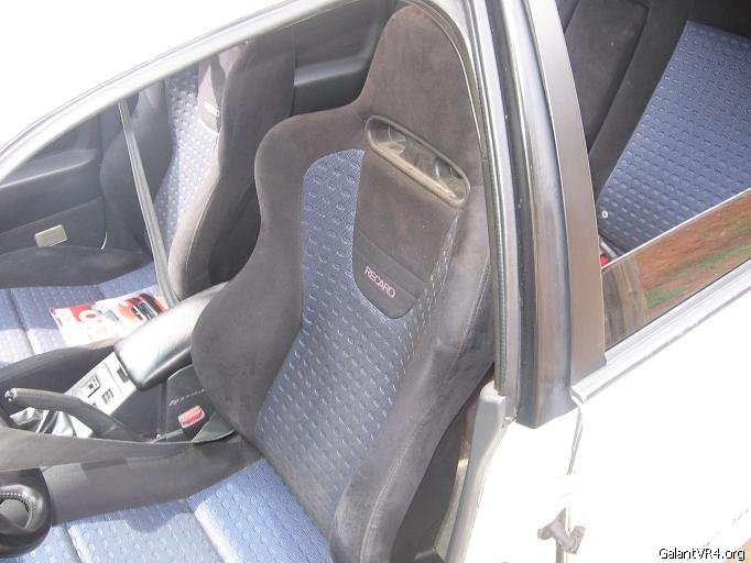

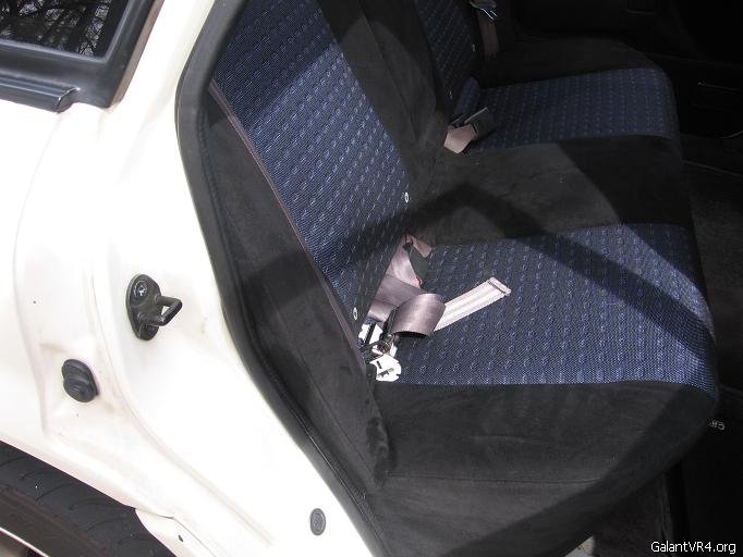

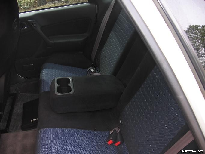

The Viii seats feel 92834902 times better than stock. The rear design is virtually identical to the gvr4 PLUS the armrest that folds down has a cupholder which kicks ass because I have been using it while driving. Its not hard to turn slightly and grab it out of the back.

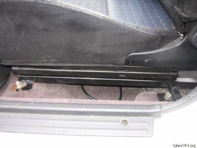

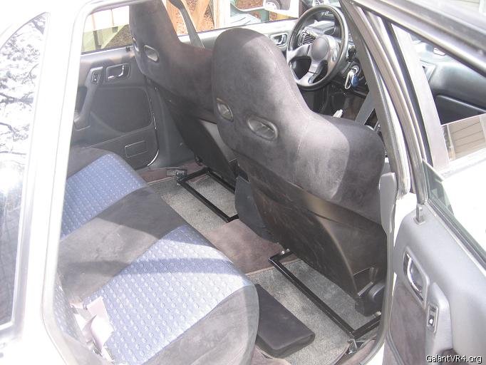

Made brackets and modifications for the front and rear seats yesterday with a buddy that does metal work.

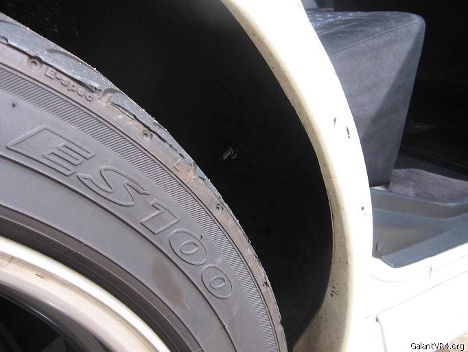

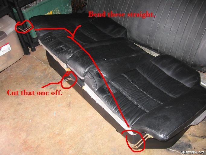

The rears werent bad. Just cut the middle prong out of the bottom and 2 stainless bolts with washers on the side prongs to draw in the side bolster gap. Drill through the back of the car through the back fender wells. Put the nut on the back side and as you tighten, the gap goes away. Make sure its stainless because they're exposed to the elements. Hope that makes sense to you guys.
The first pic is the galant seat, OBVIOUSLY do what I'm saying to the Evo seat.

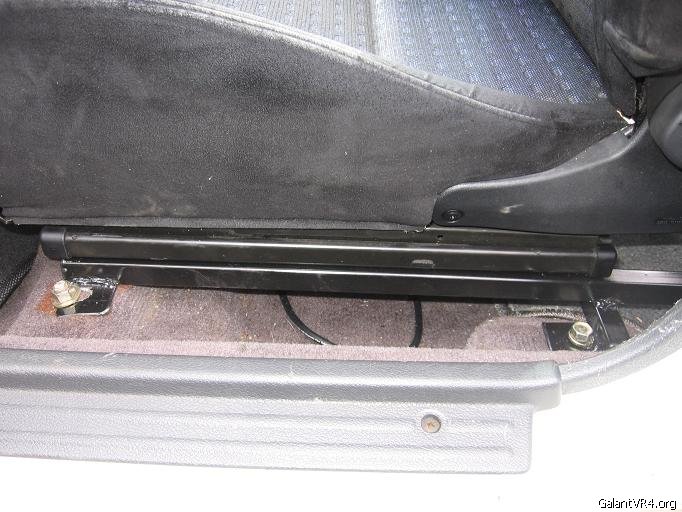

The front brackets werent bad, we raised the seat about an inch in the front and an inch and a half in the back. Decided it would be a cool idea to bring a bar out from the back of the bracket to add harnesses later on. Its about an inch of the floor so I could slip tthe harnesses on under it and put some skateboard grip tape on it so it wont slide. I dont care if its not the right or safest place to do it. It will be fine for spirited mountain runs, the car wont see a racetrack for tech inspections for that sort of thing just yet.
This was one of the top 3 things I have done to this car. Updates the look, seats feel awesome and are very comfortable plus my suspension is working much better than I thought it was previously. No more reaching over to hold on to the passenger seat in a sharp turn.

Do you have better pictures of the front seat brackets?
You are right this not a very safe idea. The harness should not be parallel to the back of the seat.
I'll keep that in mind.

How did you secure the bench for the rear seat. The last I had read, the evo seat didn't fit the same as the stock galant seat.
There are the two prongs [_]-----------------[_] on the underside and I took a grinder to the holes on the car and just made a tiny notch on them and they popped in.
