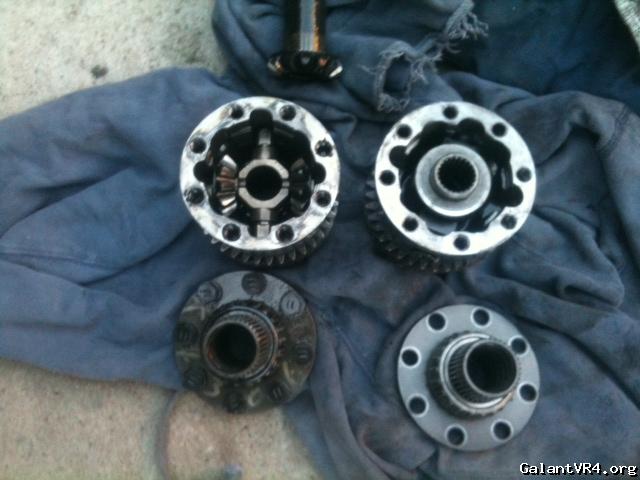

remove your center diff
throw all this out... its not needed
then weld it up... here is a diagram that shows it as well.
Remove everything with and X.... weld gear 6 to case 4, then weld gear 10 to case 12.
then simply reverse all the steps to reassemble and your good to go.

when you are all said and done, the top and bottom gears are welded to the case, and nothing else is needed. everything marked X gets thrown out.
