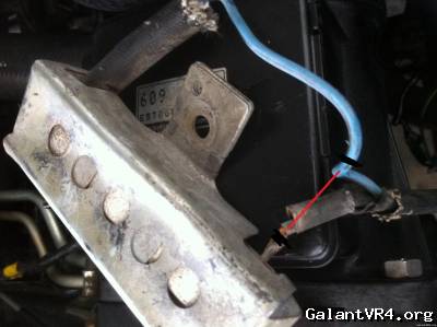

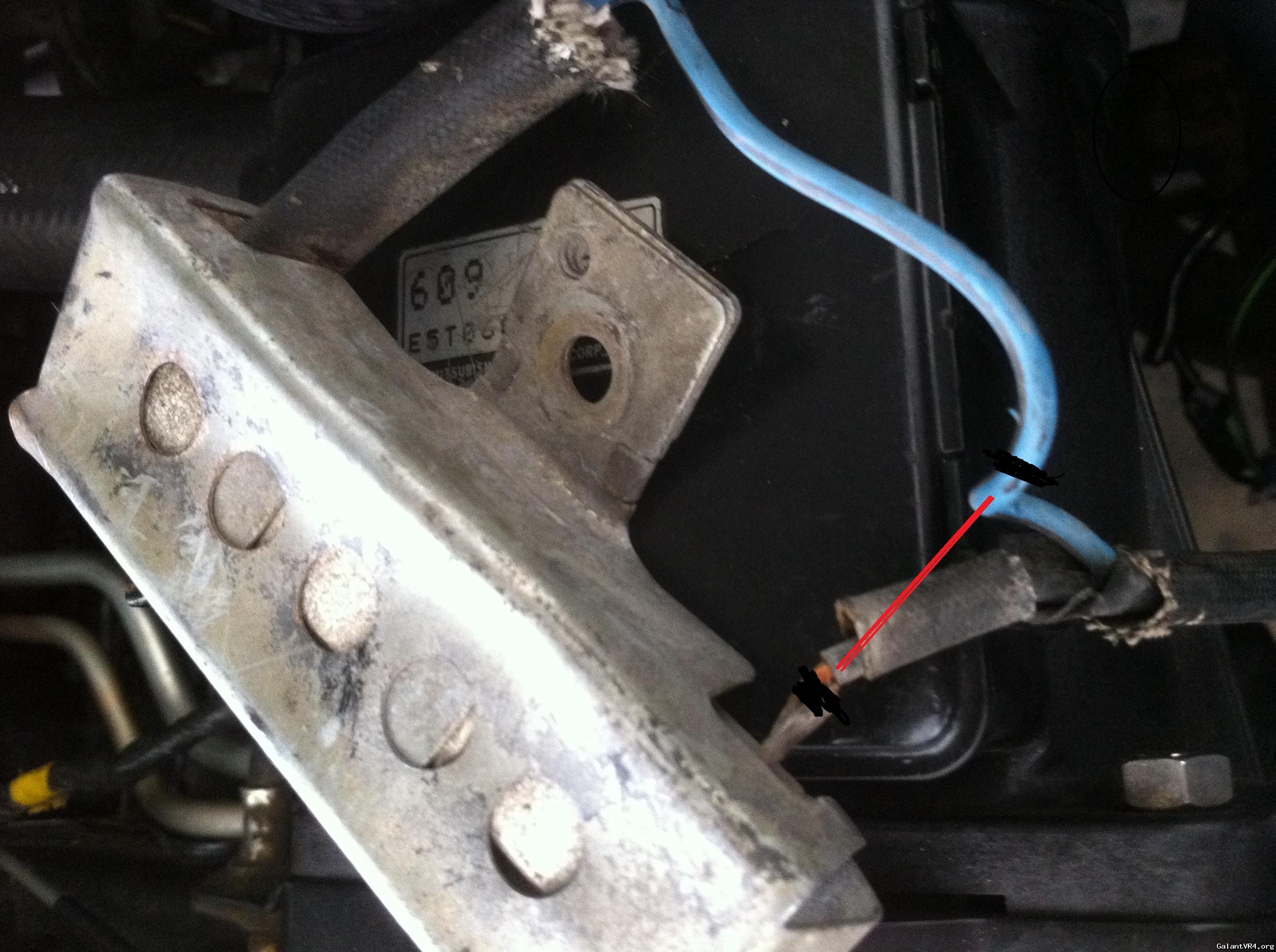

fastfalcon94, So I just need to cut the black and blue wire going into the resister and connect them? That simple? Please correct me if im wrong, I just don't want to mess up any electrical things.
