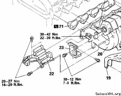

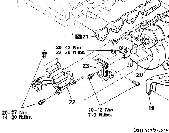

Hey guys, I cant find a picture of the Coil packs, and how its installed. I forgot how to put it back on -_-, I have reinstalled the Resistor but I need to figure out how the packs are bolted up. if someone can take a pic of theres please do. Thanks a lot
-shane
on the 1g intake manifolds the coil packs face the driver side and are mounted on the driver side of the intake manifold. on the 2g intake manifolds they go basically in the same spot but the coil packs face towards the front of the car. if the mounting bracket is the original one for the intake manifold then it only bolts on one way.
