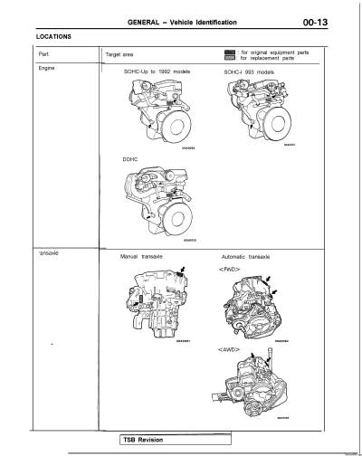

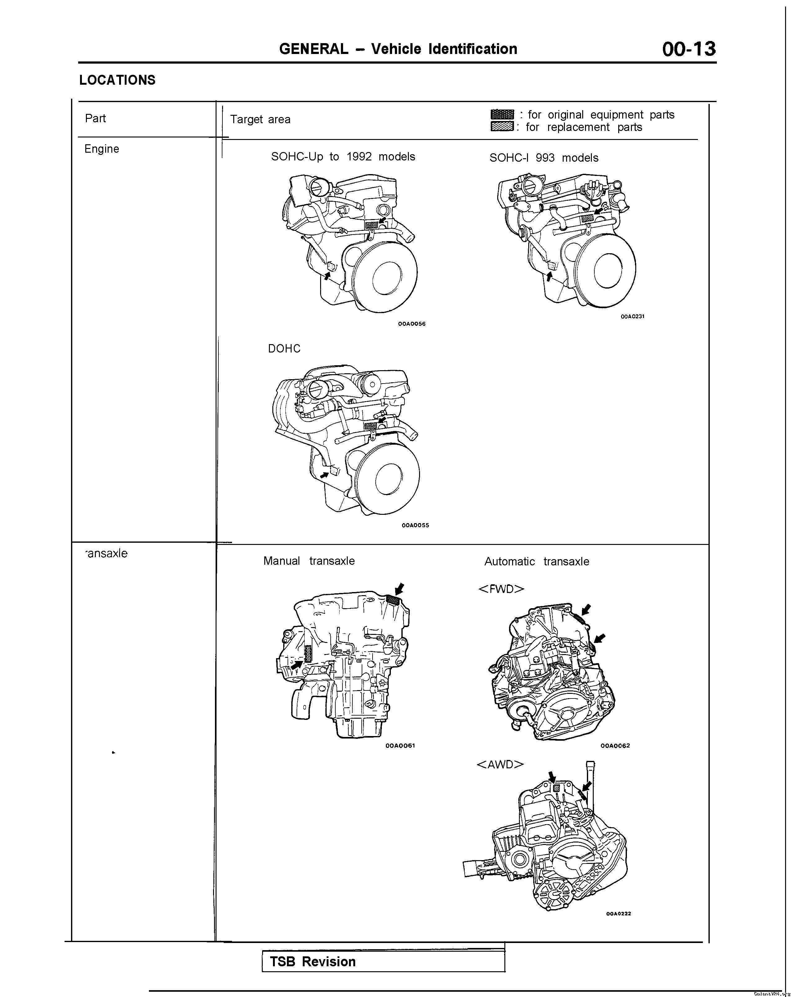

Does any body know how many labels with the VIN number ours cars has and where??????
Tranny and block has VIN number too???
10,992

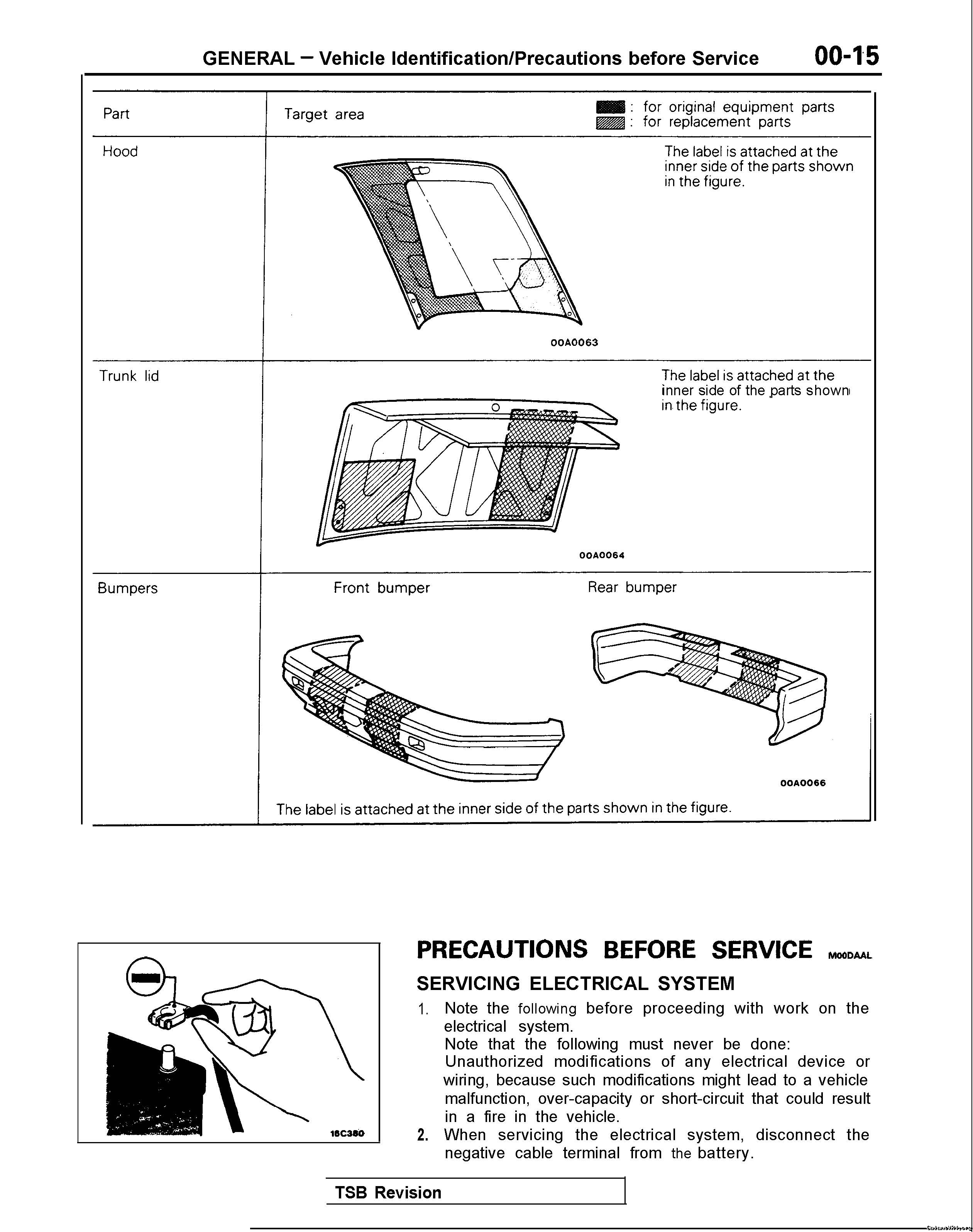

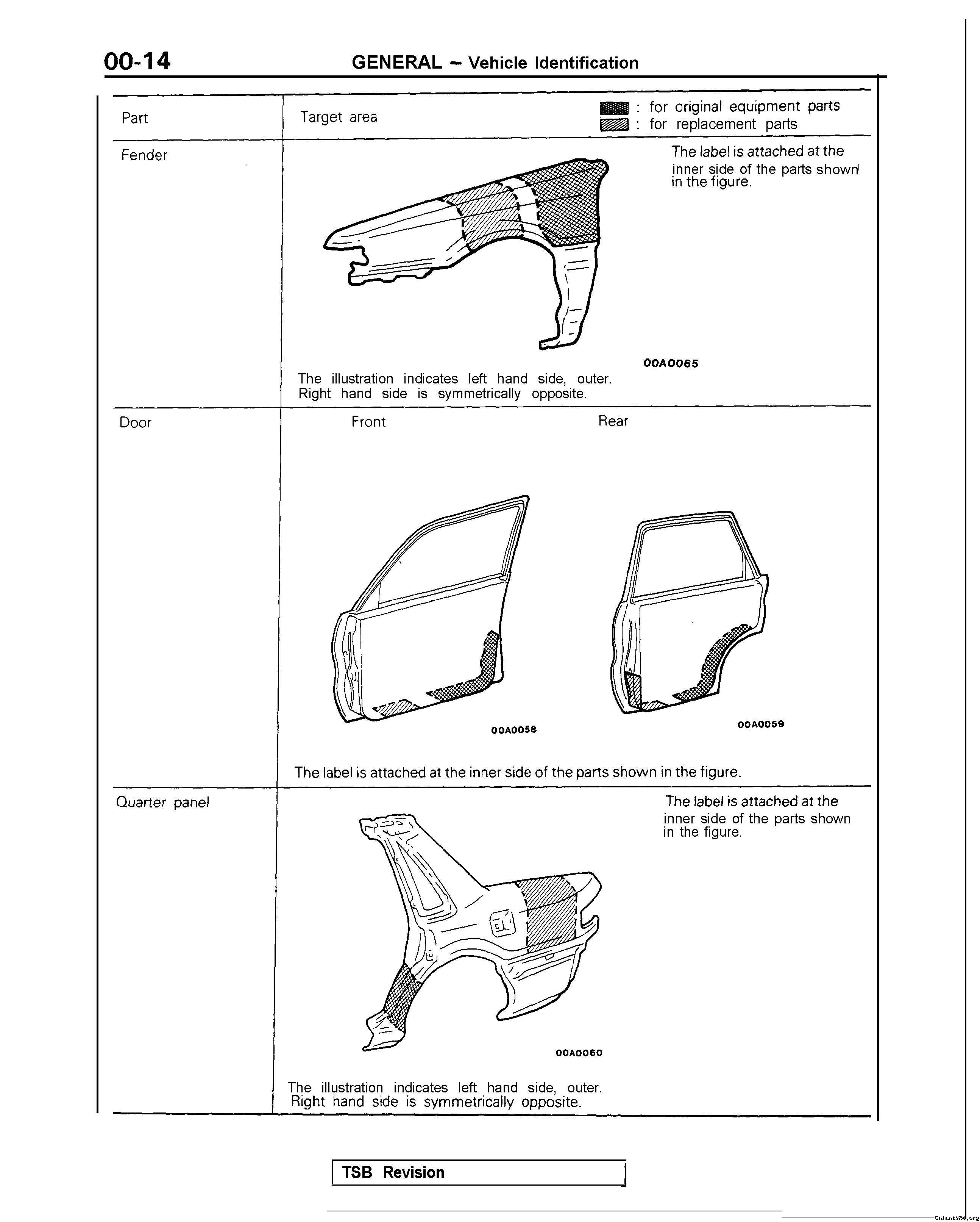

Easily removeable parts:
Hood, fenders, bumpers, trunk lid, doors.
Eng and trans have the stamped or etched VINs.
Service manual probably shows all the specific locations.
