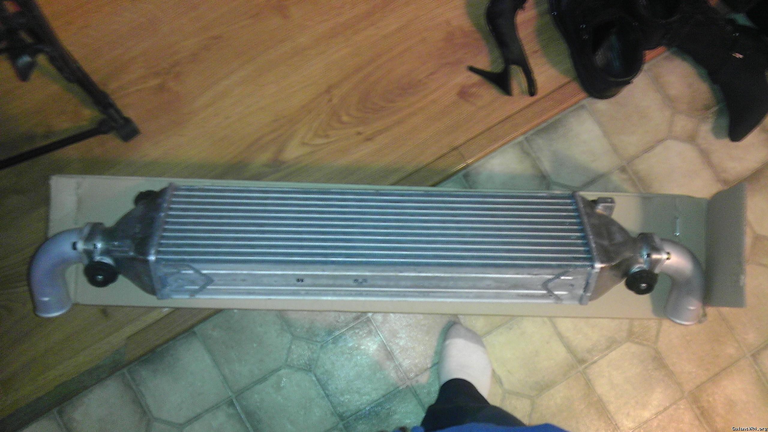

How does this look for an intercooler upgrade over stock.

Anything can be made to work. Looks a little on the small side, but it really is impossible to tell in the pictures. Take some measurements and go from there......

Sorry for the crappy pics.
So I know it is small compared to most, but it is huge compared to stock.
It is off a hyndai genesis. I only ask because I couldn't beat the price.
I am new to pretty much everything so I am sure it will be a learning experience.

The stock intercooler is HORRIBLE. I'd argue that almost anythign that isn't stock is an improvment. That particular intercooler looks like it would be a VAST improvement over stock.

At my old job, we had an intercooler that looked like that but was universal and probably flows better. I've seen Galants flip them around and run them end tank side up, instead of down, and they bolt on almost perfect. Infact, a buddy of mine runs the type 1 or 2 which is the same length, different height.
Check it out:

If it fits and seals, it's better than stock. End of thread. The stock IC is a huge joke that the bumper laws forced us to have over the jdm style.
As long as you have a 14b, 16G, or similiar, this should work great.

The stock one is what really chokes our cars. I upgraded to a evo 9 fmic but I only modified the stock plumbing to make it work. So essentially, I did have a more efficient fmic but I was still choking it with the plumbing. If you can get some good even size pipes, you'll be alright and the it will work well.
