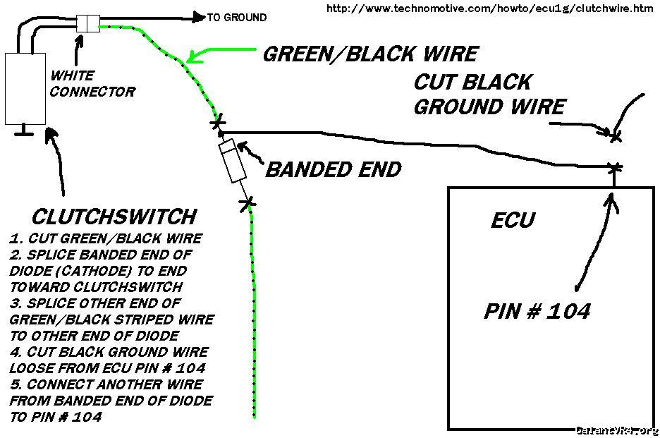

John
If the chip has BOTH NLTS and the stutterbox launch rev liters, you need the clutchwire to get either of them to work. If you need to build your own clutchwire, here is the diagram, except the GVR-4 clutchwire you cut is black/red striped:

Quoting keydiver:
I guess my chip doesn't have NLTS then cause my stutterbox works fine and I never installed the clutch-wire.
Yes, that is correct. Your chip does not have NLTS, so it doesn't need the clutchwire for the stutterbox launch. /ubbthreads/images/graemlins/wink.gif
