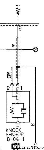

but here it is on a ckt diagram:
i've done mine like biglady112 did, since my harness was basically an NA 92 Galant's and my ECU and some engine sensors (o2, knock, maf) were early Evo (III)...
hth...
so to answer your question if there's a difference, basically, there is not...

Just to be clear, according to this diagram, the signal wire is shielded, and that is not going to ground at pin 9. That is not a ground symbol. The "B" (black) wire is the ground there. wouldn't be much of a circuit if both were grounds.
I would suggest that wire is shielded because the signal from the piezo electric knock sensor is probably weak and interference could cause problems like, oh I don't know, "phantom knock"? /ubbthreads/images/graemlins/grin.gif

Yup the BW wire is connected to one of the dotted points on the shielding.
The other dotted point on the shielding [B wire] is connected to the grounding point #8 which is the main grounding point of the ECU on the passenger side kick panel...
It is not connected to the W wire going to the ECU as the knock sensor signal...
Your call...

a little more background on how that system "works"
Quoting iceman69510:
^^^ this guy "gets" it /ubbthreads/images/graemlins/smile.gif
It's a lot like the rca cabling in car stereo systems that use external amplifiers.
The head unit produces a low amplitude signal that is passed to the amp thru the rca's
... any "noise" that gets into the signal path will be amplified
... you hear it as alternator whine or clicks n pops in your music
... assuming you listen to music and not the crap that kids listen to today
... sh*t sounds like a buncha disgruntled youths on their way to do community service in a plumbers van /ubbthreads/images/graemlins/devil.gif
The knock sensor is a piezo electric crystal that is "tuned" to resonate in the same frequency as "knock"
... much like a microphone, it passes a low amplitude signal to the ecu
any "noise" passed down the signal pathwill be amplified by the ecu
get "unlucky" and that noise *may* mimic something the ecu will interpet as knock and pull a buncha timing
... leaving some horses on the table
... and increasing the egt's
why chance it?
