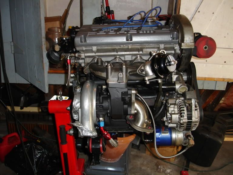

This is how I hooked up the feed and return on mine if it helps
