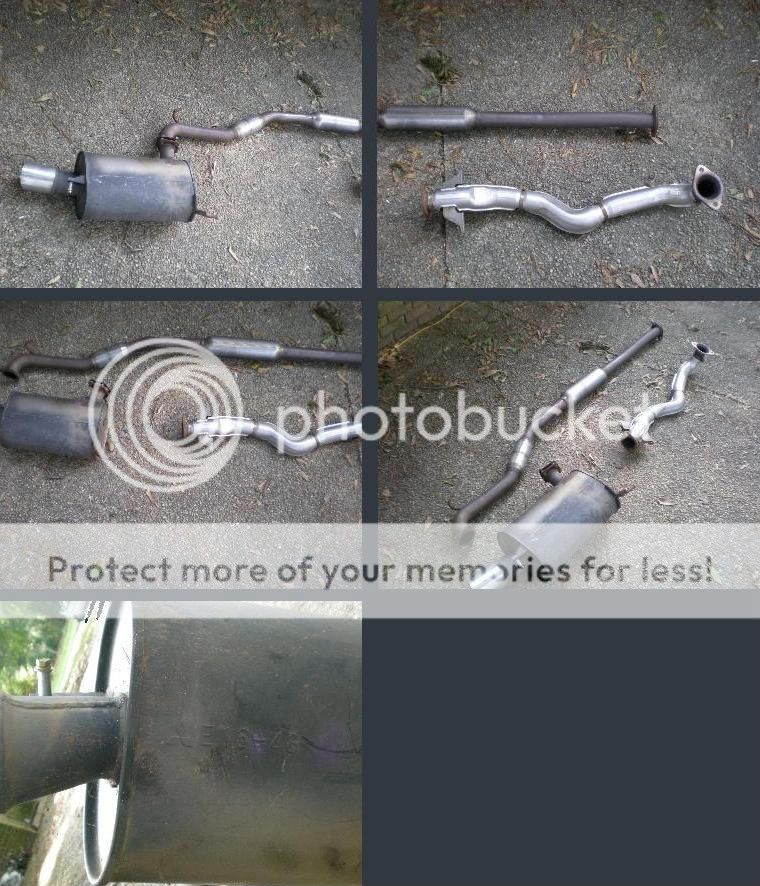

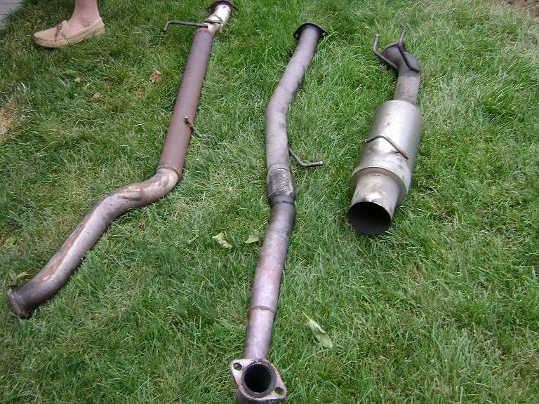

wont work without major modifications.
1G exhaust
EVO 8/9 Exhaust

awesome! I just see cutting and welding to the evo exhaust to make it fit better. so for me at least its less of a headache starting fresh. I have done it both ways with past cars of mine. made due with what i had on hand. more work but the outcome was still the same.

I see your point, to a point, but Im also looking to have as few bends as possible to promote the best flow possible. I've built an exhaust for my old 1G a loooooong time ago that had 2 bends in it; one where the downpipe met the O2 housing, and one back just before the diff to clear everything. Best par of all is it didnt rattle or vibrate audibly at all. sure, clearance was closer than factory in a few spots, but nothing that would become an issue. I also had a small flexjoint section near the tcase/oilpan as typical, and used 2 3" but joint band couplers to hold it all together.
Sure, it was loud because there was no resonators or anything of the sort, but i could've easily added a few inline glasspacks to use as resonators if I so desired.
Basically, the Evo exhaust is the closest pre-made exhaust to the exhaust I made for my Talon years ago, and was curious why nobody had thought of modifying one to fit our cars, yet.
I have a buddy coming by the shop tonight with his 9 to let me take some measurements and so-on, I'll update as I go!
