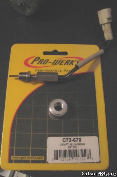

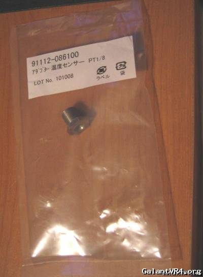

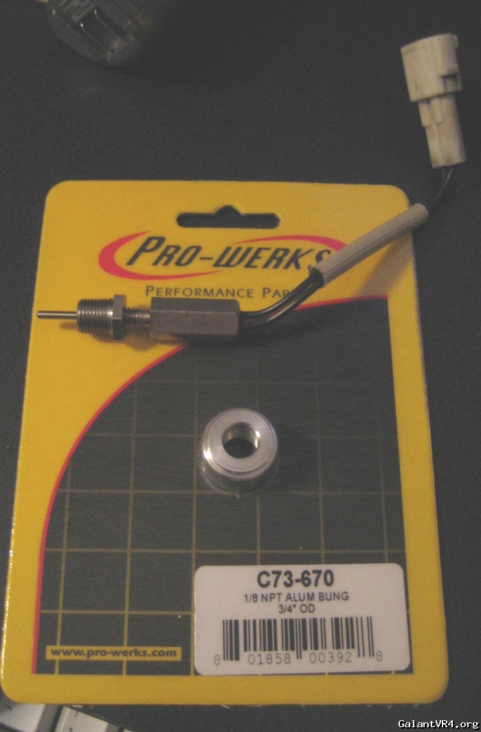

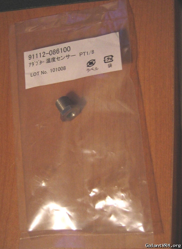

The proper way to install an iat sensor. HKS part number 91112-086100. Took 5 weeks to get this damn thing.
Why should I sift through over 480,000 items and possibly order the wrong item when I can just call one company and say here is what I need and heres the part number?
The only problem is since the vpc is ancient now no one stocks them so they are special order.

Because it wouldn't have taken five weeks to get the part? If you have the sensor in front of you, you should know exactly what adapter you need, making "searching" through their catalog pretty straightforward. /ubbthreads/images/graemlins/dunno.gif

i just installed the VPC in my car and instead of spending $15 or whatever the bung is and having to wait forever for one for the IAT sensor i just made my own out of round aluminum stock. Turned Out Perfect, ill post some pics tomorrow
