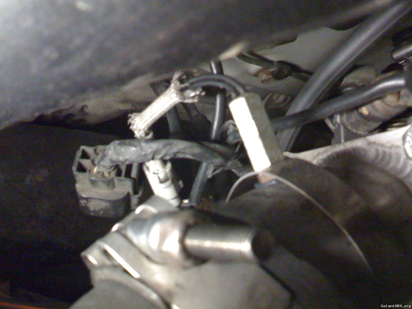

Sorry I am so late posting up.
I had the same problem with sensor not having enough to thread into. It happened at Watkins Glen while at the track, so I needed a quick solution. I ended up taking a band clamp, drilling a hole in it, and using that as that to sandwich the retention nut in place. Of course the intention was to get a bung welded on, and 5 years later I have only upgraded to a much nicer looking band clamp.
Hope it helps, but it can at least hold you over.
