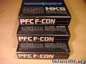

I won a few hks f-con's, guy says it is d version what is this, and if rom does not go to my car is there a way to change over can i get a link with info on this and if its worth using please give me some info on it. /ubbthreads/images/graemlins/banghead.gif
HKS can explain what the difference is between the versions, so you should call them. The units are all universal so if the ROM that's in there is not for your car so can replace it with the one that suits your application. You're also going to need the specific harness for the ECU you're hooking it up to.
As far as usefulness goes.....it's useful for a beginner as a way to add fuel when turning up the boost, but a better bet would be to sell all of those units and buy a used HKS VPC. With the VPC you'll have greater control of the fuel, it coverts to car to speed density and if paired with a GCC or a SAFC you could control more fuel and run bigger injectors. The FCON was good in it's time (mid to late 80's) but that time is now long gone. The newer FCON VPRO is light years ahead of the older units in functionality and price.

i have a friend that wants one that i have so i guess i can sell them for decent amount of cash. but where can i get a harness for it to go with a vr4 or 92 talon and also link followed is this what they consider the d version. /ubbthreads/images/graemlins/confused.gif it looks exactly what i have and i have tried to contact hks but there sales dept are not avail.
click here hks
I'm not sure what you consider a decent amount of cash but I wouldn't pay more than $100 for one of those. Used VPC/GCC combo's can be had for around $300 and they offer way more tuning potential.
HKS no longer sells that harness for the 1G DSM/Galant VR4, so you'd have to buy a used one on here or one of the DSM forums.
The version is not really relevant so I wouldn't get too hung up on that.
