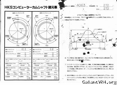

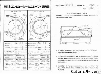

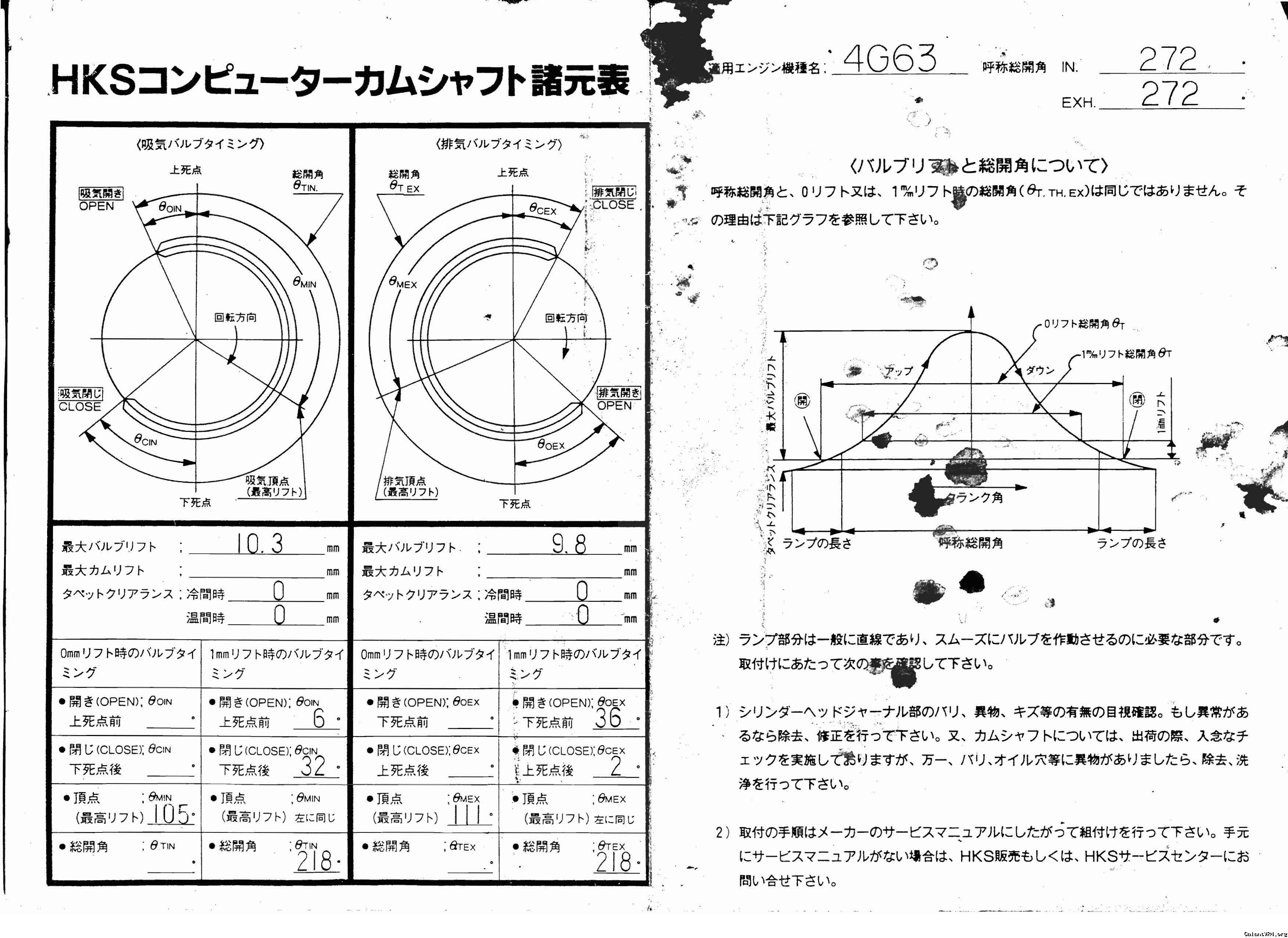

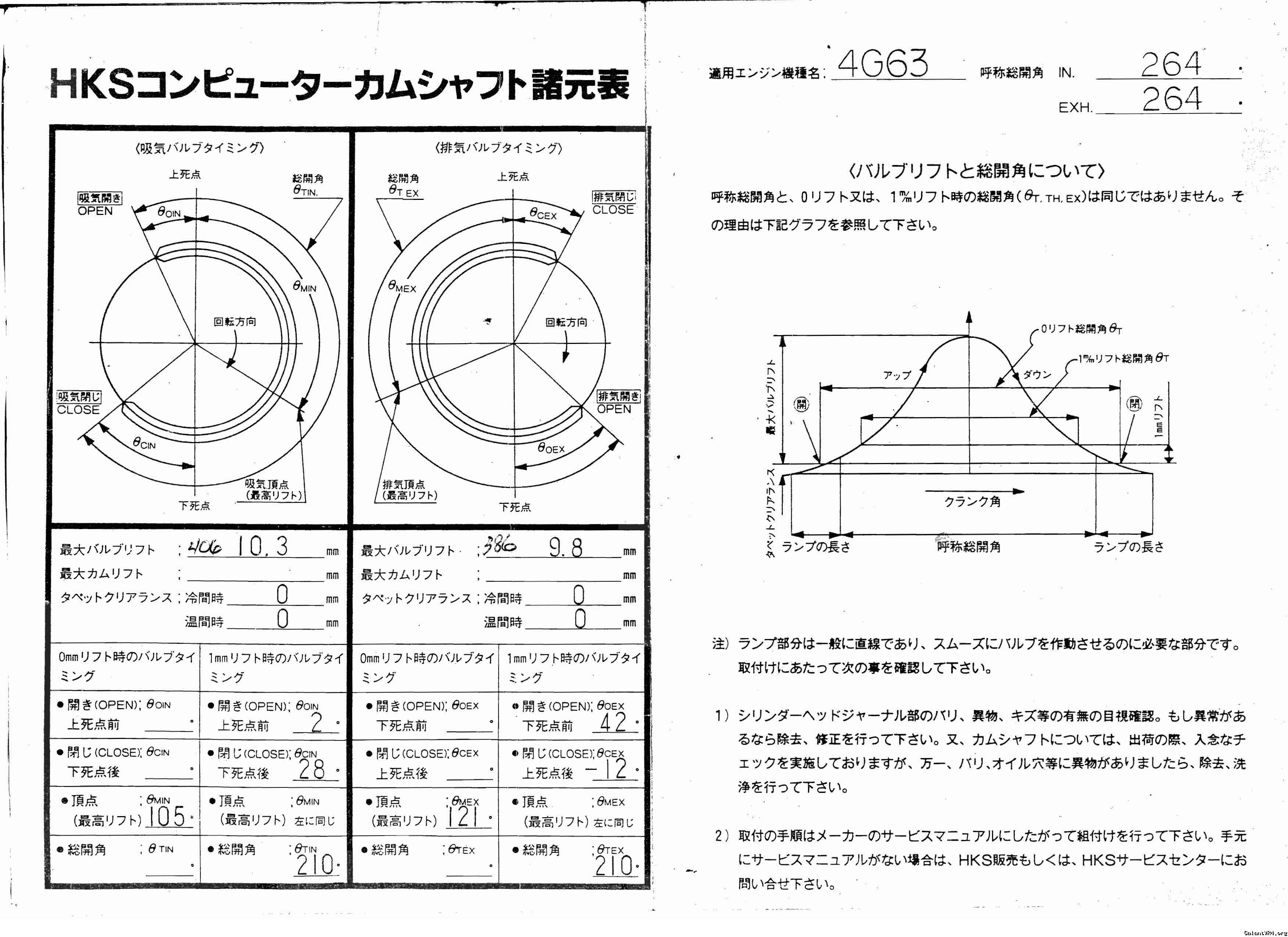

bazeng
Feb 6, 2003
2,520
Melbourne, Australia
Does anybody have HKS 272 spec cards? Even if you have any cards for the 264/280 cams, post them up!
They will be good for future use!
Let me know if you have anything or know where to find them.
I've attempted a quick google search but with no luck.
