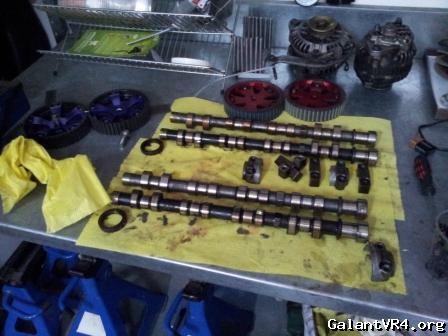

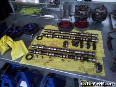

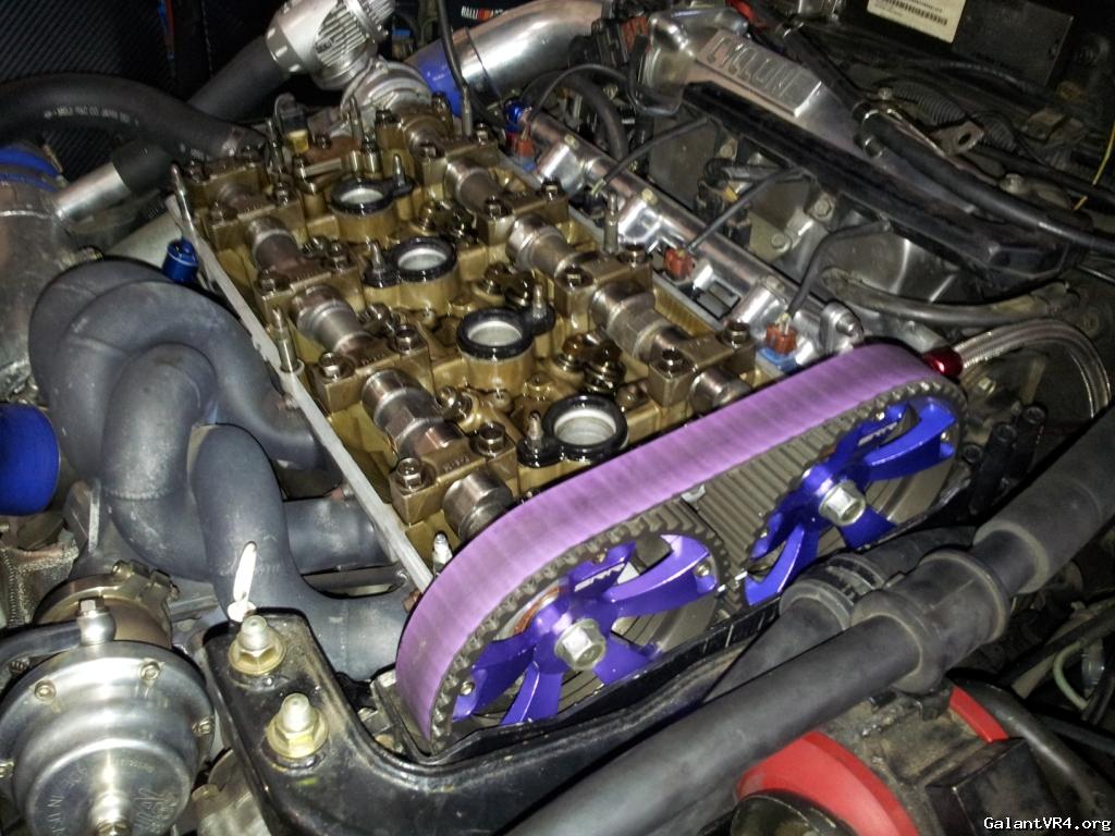

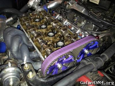

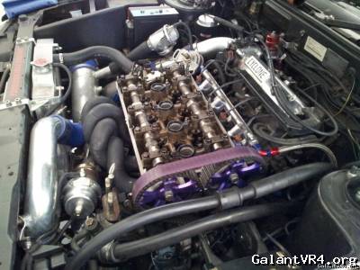

Hi Guys,
Just an update.

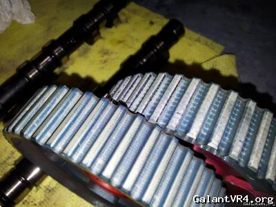

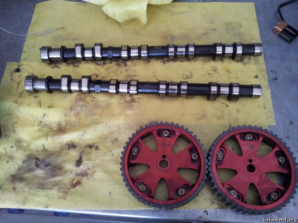

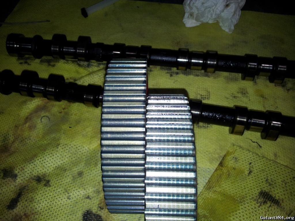

I decided to do a full removal and swap because I needed to change the cam gears.

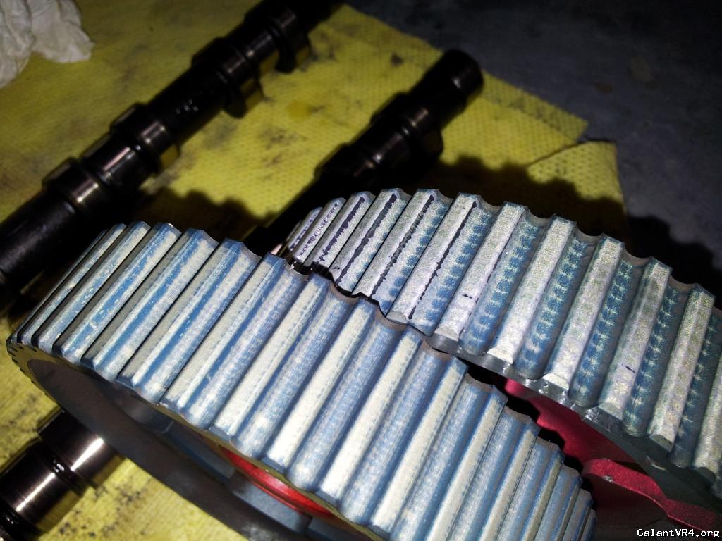

I had a set of Tomei Adjustable cam gears installed and the coating had worn through to the metal.
Check out the photos.

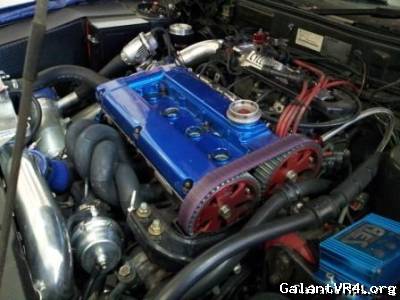

It now idles much better with the Tomei 260 / 260 cams and smaller injectors.
My quest for a more drivable car is coming along nicely.
I cannot recommend enough the AMS timing belt tools (cam gear tool). This allowed me to align the marks without the belt and simply slip the timing belt over without any fuss. It usually takes a bit of playing around to align the cam gears, not hard but can be annoying.

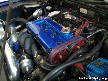

Before with Tomei cam gears and HKS 272/272 cams

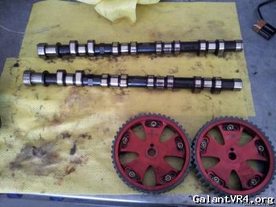

Old setup and New setup

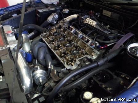

Lifters bled and reinstalled

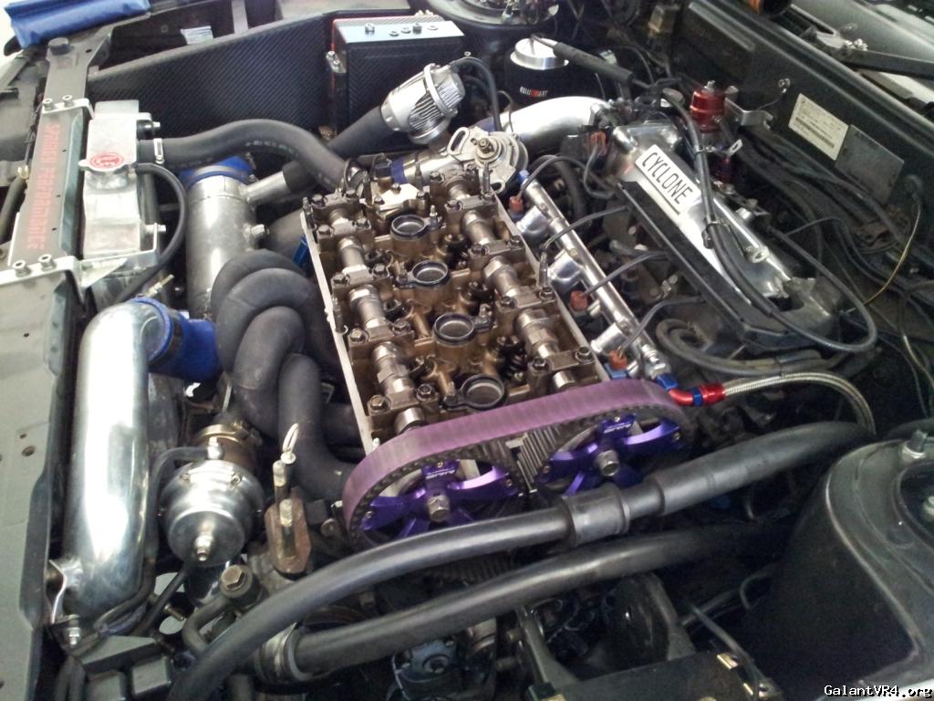

New setup installed (Tomei 260/260 with SSR cam gears)
HKS 272/272 camshafts
Tomei cam gears - note metal visable through coating. Timing belt was OK though, no damage. HKS Timing belt was used.
New setup with timing marks all OK after a few rotations.
4mm drill bit used to gap tensioner.
AMS camshaft tool used to aling marks on cam gears.
Jay Racing tool used to rotate tensioner pulley.
How long does it normally take you guys to do a belt from start to finish?
This is the 5th timing belt I've done on these cars and it gets easier each time...
