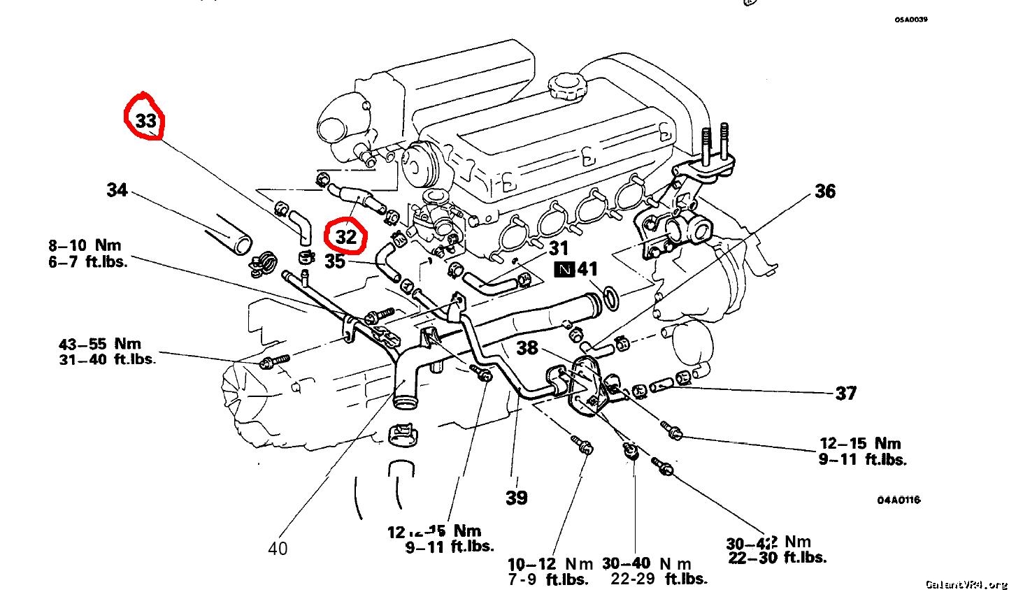

As for their lines that were previously there, where do those route to/from?
You want the ones I circled below in red. #32 connects to the thermostat housing and #33 to a nipple on the water pipe. The pic shows how both of them route.
I checked the wires leading to the sensor, Turns out that the original connector was probably bad and this new connector took its place. I had to sodder and heat shrink them since they were just twisted and taped. I got some new lines and reconnected the deleted hoses. Idles like a champ. you guys are the sh*t!
