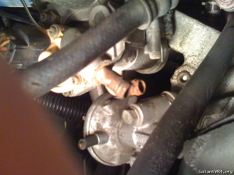

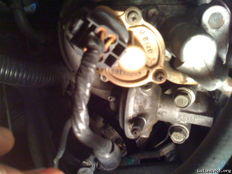

Recently the weather here's been in the 10-15degree range. I'm not too sure what's going on, but for some reason, 23's been idling around 1800-2500rpm which bugs the crap out of me since it's already hard enough that the gears won't engage smoothly. Also, the stock temp guage has been on and off on operation. What i noticed is that the idle is high when the temp guage is reading at zero, and the idle gets lower when the temp is nearing normal range. But with all this, it still won't idle

Sweet, that's your ISC motor. /ubbthreads/images/graemlins/hsugh.gif
You can't tell if the FIAV is blocked off from a picture. Obviously, the bottom half of the TB is still there though, and that's the part that houses the FIAV. If it hasn't been blocked inside with JBweld or with a plate in between the throttle body halves, then I think we found part of your issue.
If it wasn't blocked of in any way, would i be able to feel any pressure (in or out) through those openings? I wasn't feeling any at all with the engine running

No, those nipples are for coolant only.
I don't see a blockoff plate sandwiched in between the two halves. If you could find out from the guy that deleted the coolant hoses whether or not he blocked the FIAV off with JBweld, would help a ton and you wouldn't have to remove the TB to find out. If he didn't block it off you should pick up the factory TB coolant hoses and hook them back up. Get some coolant flowing in there and if the FIAV is working properly you should be in better shape than you are now.

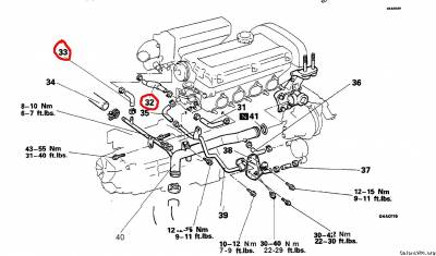

As for their lines that were previously there, where do those route to/from?
You want the ones I circled below in red. #32 connects to the thermostat housing and #33 to a nipple on the water pipe. The pic shows how both of them route.
