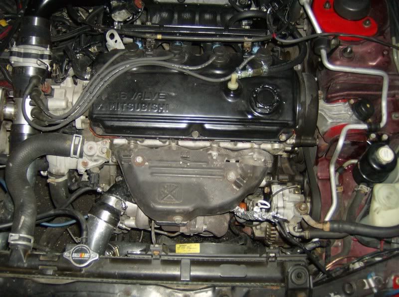

So, I did a few things today. I was trying to eliminate things one by one on top of what Ive done so far.
Switched back to my OEM fuel filter /brand new/ and filter to rail line, installed different TB and just in case I switched to 510cc. Well, the thrill of 510cc acceleration felt nice, but my hiccup problem still persist, and its driving me crazy.
Things Im doubting that might be the problem:
Aeromotive FPR, distributor and HG.
Here's a little picture of what is up:
