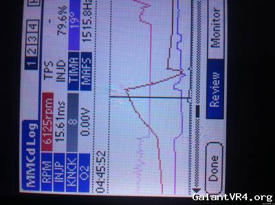

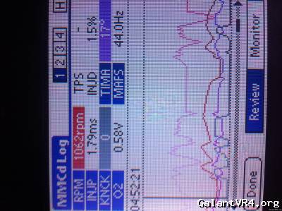

Still looking for assistance here. Haven't figure out how to post a full log. So here's so key points I took a photo of.
This is just running through the gears. You see RPM/FTO2/KNOCK/TIME ADVANCE
This one is during a third gear pull starting around 3k
11,982
Hard to really tell what's going on with just a couple of screenshots, but 8 counts of knock ain't that bad.
