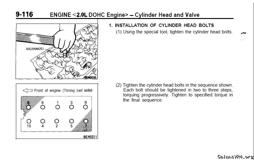

Is this correct?
Studs are ARP.
So, the image is upside down if I'm standing at the front of the car, right?
AllanL
Aug 4, 2008
298
NV
yes. facing the engine, if timing belt side is on your right, bolt #1 should be radiator side.

As long as you start with the bolts in the middle, it doesn't matter if you do the one facing the radiator or the one facing the firewall.

Prior to tightening the head, I spoke with ARP, and,I did the following :
Chased the holes using a 12x1.25 tap, using "Ultra Torque" lubricant, I hand tightened the studs,using 3 steps I tightened the studs in the correct sequence to 30,60,and then 90 ft lbs.
"Ultra Torque " went on stud threads, washers, and nuts.
I used Mitsu gasket.
