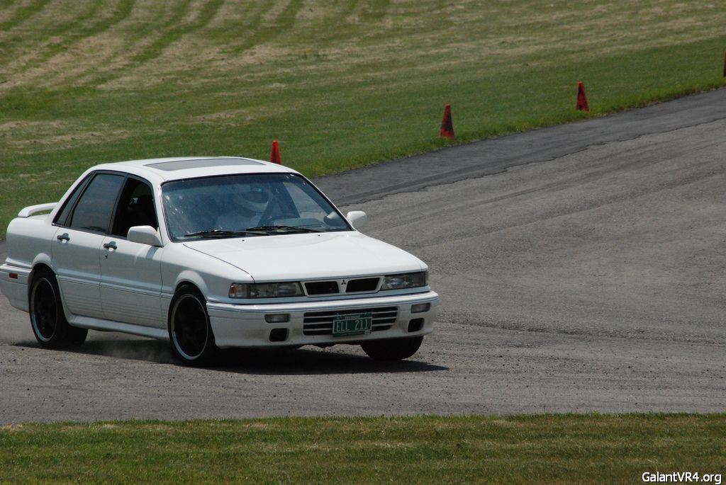

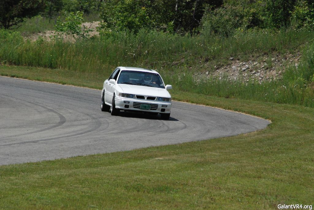

Sorry to resurrect an old thread, but I was back at this track yesterday. Normally it's a two-day event but other committments limited me to 3.5 hours of driving each way for just 8 timed laps on Sunday. /ubbthreads/images/graemlins/rolleyes.gif Oh well. Next event there I'll get there early on Friday evevning and get more time in.
Ran a 58.41 which beat my best time in the old car from last year by 1.02 seconds. 6 of the 8 laps were better than the best time in the old car. If I'd had Saturday to practice I'm sure I could have gotten the time a bit lower. Ran about 14-16 lbs. of boost and between that, the FMIC, the 16G, and the 3.5 GM MAS, the car does feel a good bit quicker than the old car. 2-3 shift points were happening sooner, meaning higher top speeds before braking.
Ended up 4th out of 22 cars, beat only by a Turbo Miata, a heavily worked Mini Cooper S, and nipped by a tenth by a brand new Audi TT 3.2 Q running the same sticky Bridgestones as my car.
Cy's Ferodo race front brake pads were great, and never faded, although they did burn off a bit. I could feel the pedal get a bit longer by the end. This track is murder on brakes. Thanks for the pads, Cy!
Bridgestone RE-01Rs held up well, but the LF needed about 34 psi cold to keep from rolling past it's optimal point on the tire shoulder. This track is also murder on LF tires. These tires are very communicative at the limit, have the same or better grip than Azenis, and don't get greasy when hot. I love 'em.
Now the driveline's making more noise, though, I've got a small clunk from the LF (braked to late and had one grass excursion where I think I picked up that clunk). Got to take care of those two items before the end of July when I go back, and go to the track at Tremblant right after that.
Go-faster mods by then will mostly be lightening up the car (AC, swap out stock seats, hopefully hack down the front and rear bumper supports), and perhaps tweaking the suspension with some poly bushings, a bit more front neg. camber, and rear upper pillow ball mounts (using Hot Bits with stock upper rear mounts is noisy/squeaky). Not sure if I'll get a dyno. tune between now and then, but I know this set up can make a lot more power, esp. if I start using the methanol injection system this car has. Goal by the end of the year is to be getting close to the 56s that the modded Evos and STis have historically run at this track. We'll see!
May have some pics and video up soon...

Are you getting rear lockup like that at the longer, faster tracks (Calabogie)? What rear pads are you using? Is that video with the DS3000 in front?
