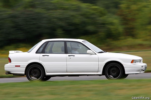

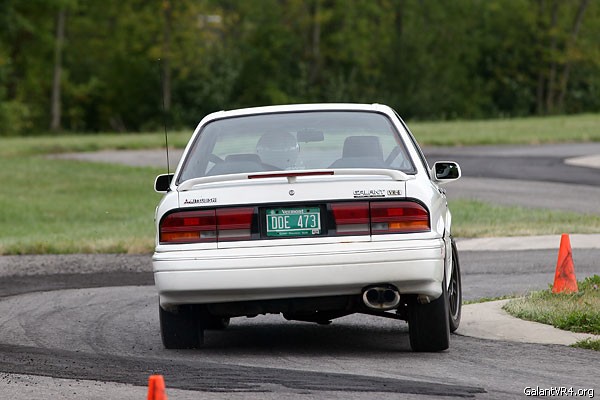

Here's a nice picture from that weekend that shows the need for camber plates!

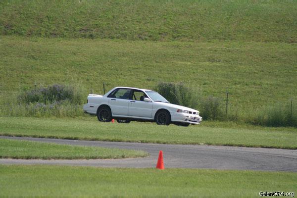

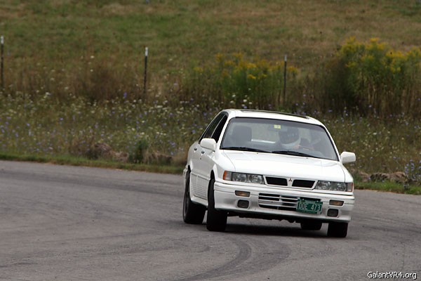

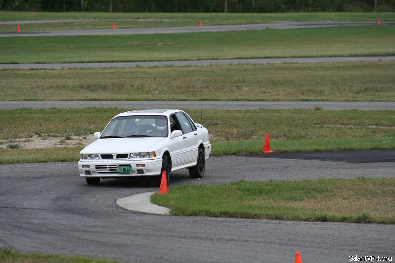

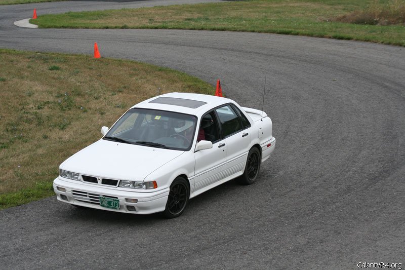

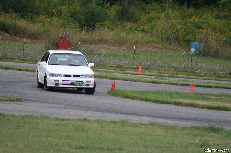

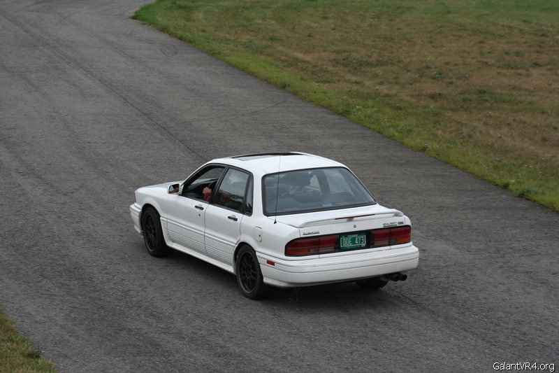

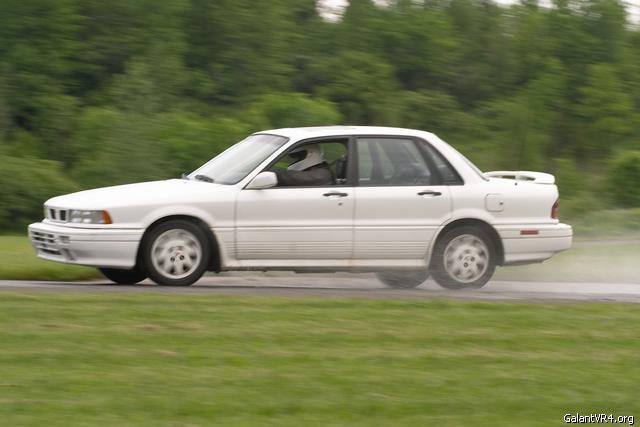

Still hoping for a day at Lime Rock or NHIS before the season is out, but the fuel tank replacment must get done first. Here's a few pics and couple videos from the weekend:
