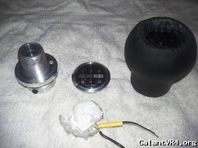

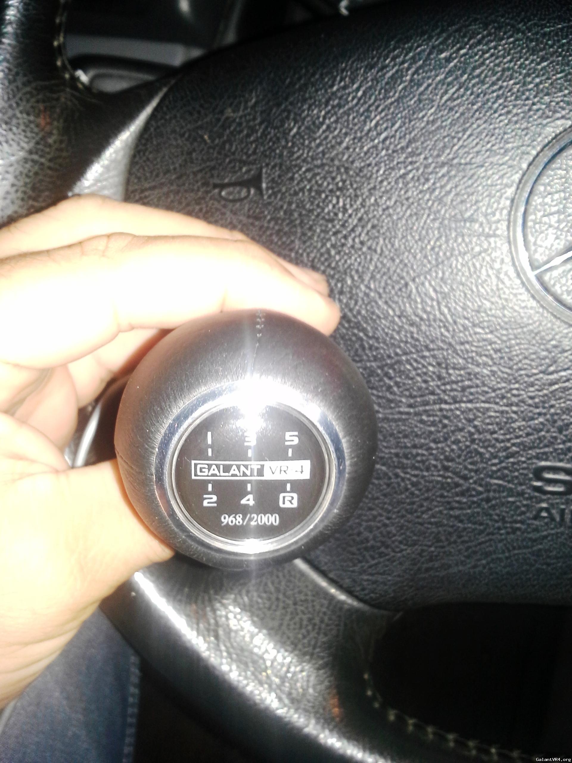

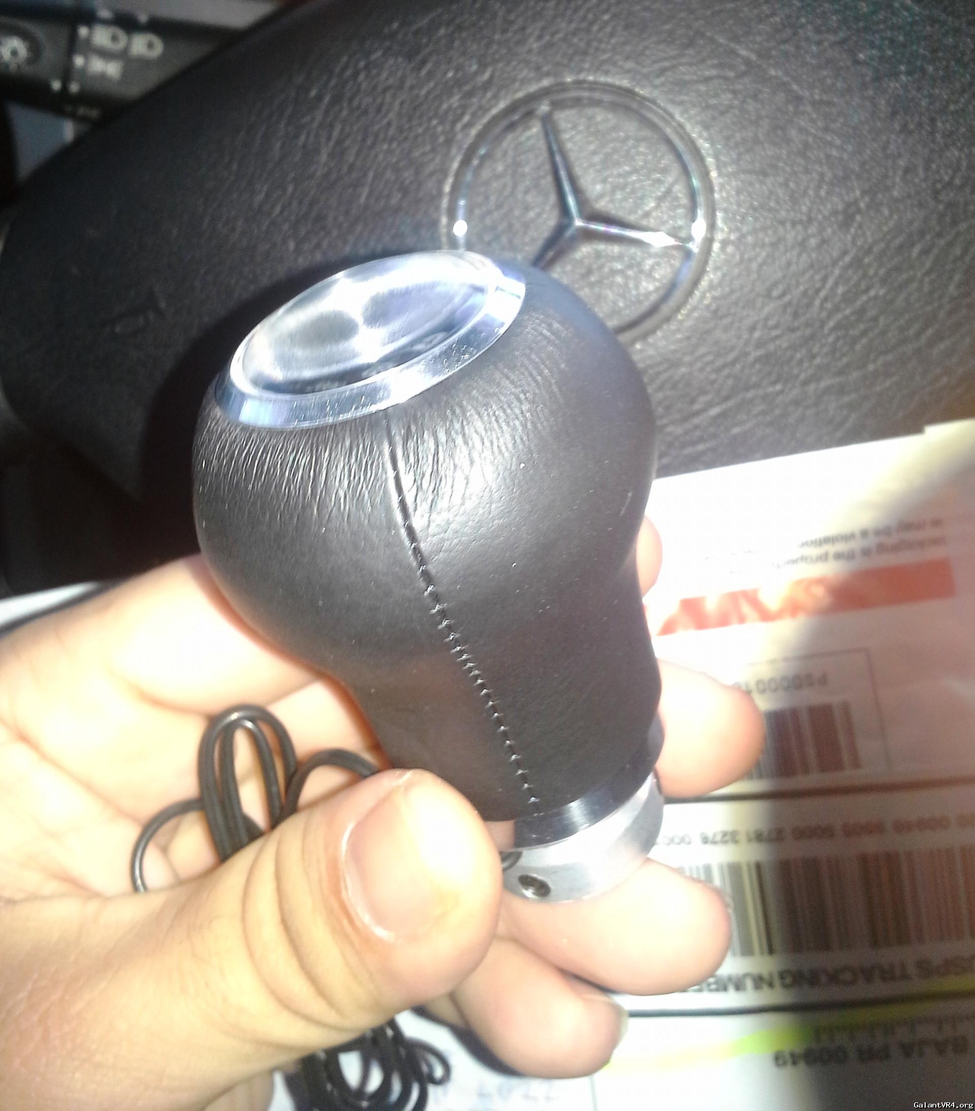

Hey guys, after receiving my knob, like everybody else i was happy with the part /ubbthreads/images/graemlins/rofl.gif. That was until i connected it to power to check out how the LED illumination looked but to my surprise it didn't worked /ubbthreads/images/graemlins/bawling.gif It wasn't due to a connection mistake or anything of that sort, it's a plain and simple two wire set up, black/white (positive) and black (negative). After testing a few times with no results i realized that i only had two options:
1. Contact Racah15 to see what could be done (which i first did but declined soon after reading all the controversy that has emerged from this buy) or
2. Fix the problem.
So i went for the second option, risky but i fixed the problem. Obviously not before having to completely "dissect" the shift knob. So with the purpose of ensuring our "little" investment i will share the procedure (of shift knob dismantling) i did with all of you, just in case anybody happens to encounter the same issue at some point. That being said, i want to make very clear that by no means it is my intention to discredit Racah15's (thanks again) efforts on this group buy nor contribute to the aforementioned controversy. Again, my only intention with this info is to help others if the same issue as mine arises to anyone. I will also point out that in the following pics, every aspect of this shift knob will be disclosed including: quality of fabrication, materials, and overall end-product which like in my case may bring you some new judgements about the product/value. I did came to my own conclusions (regarding value vs quality of the knob) after doing this procedure, which i will keep to myself and with all due respect, i ask you to keep yours (opinions about value vs quality) to yourselves also. As for not to bring any type of unwanted and/or unintentional controversy. Thanks for understanding.

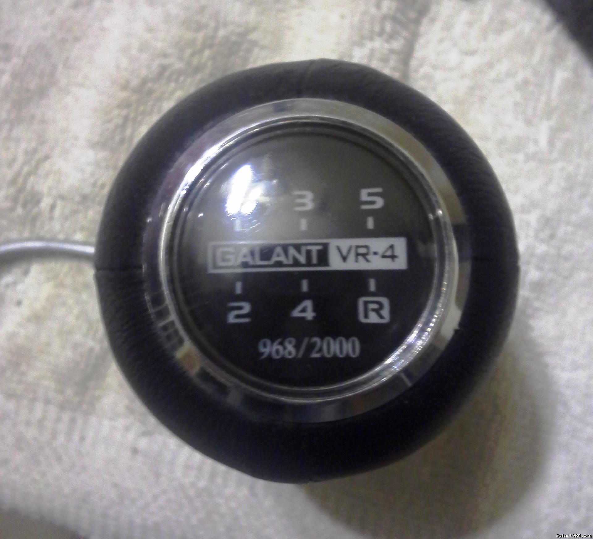

This is when i got the knob

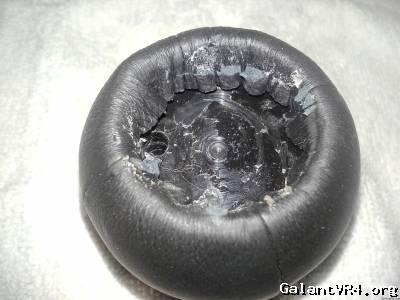

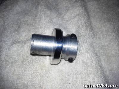

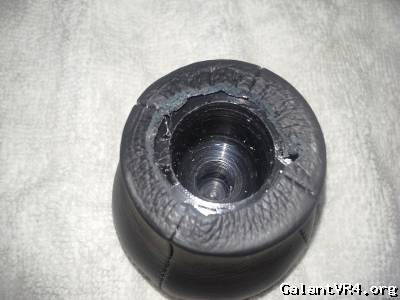

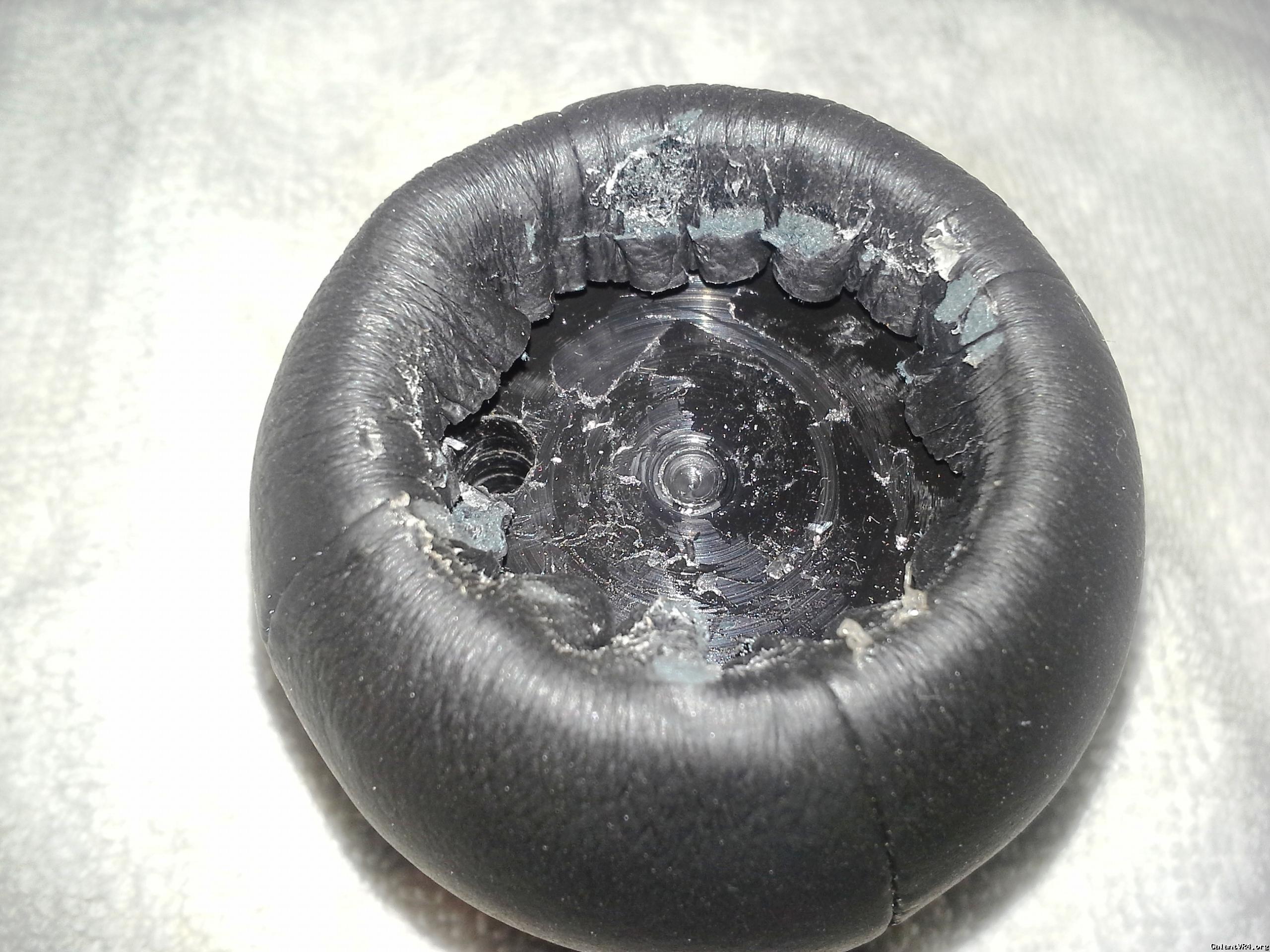

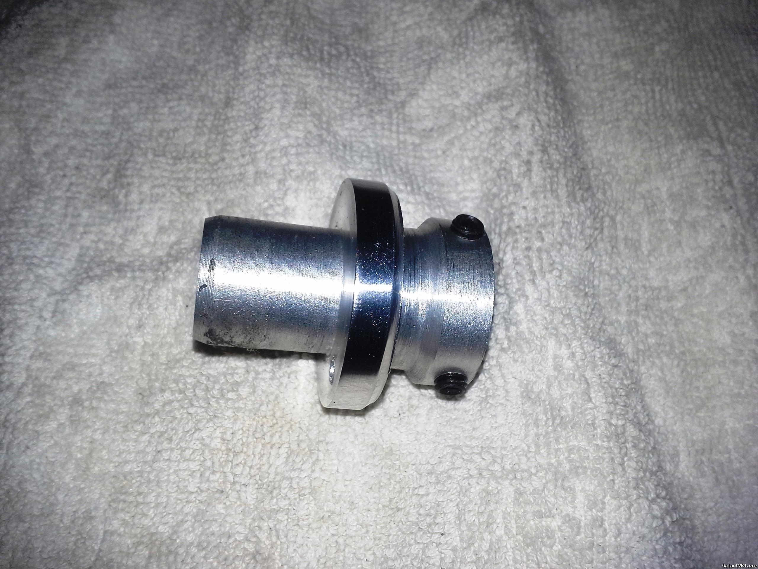

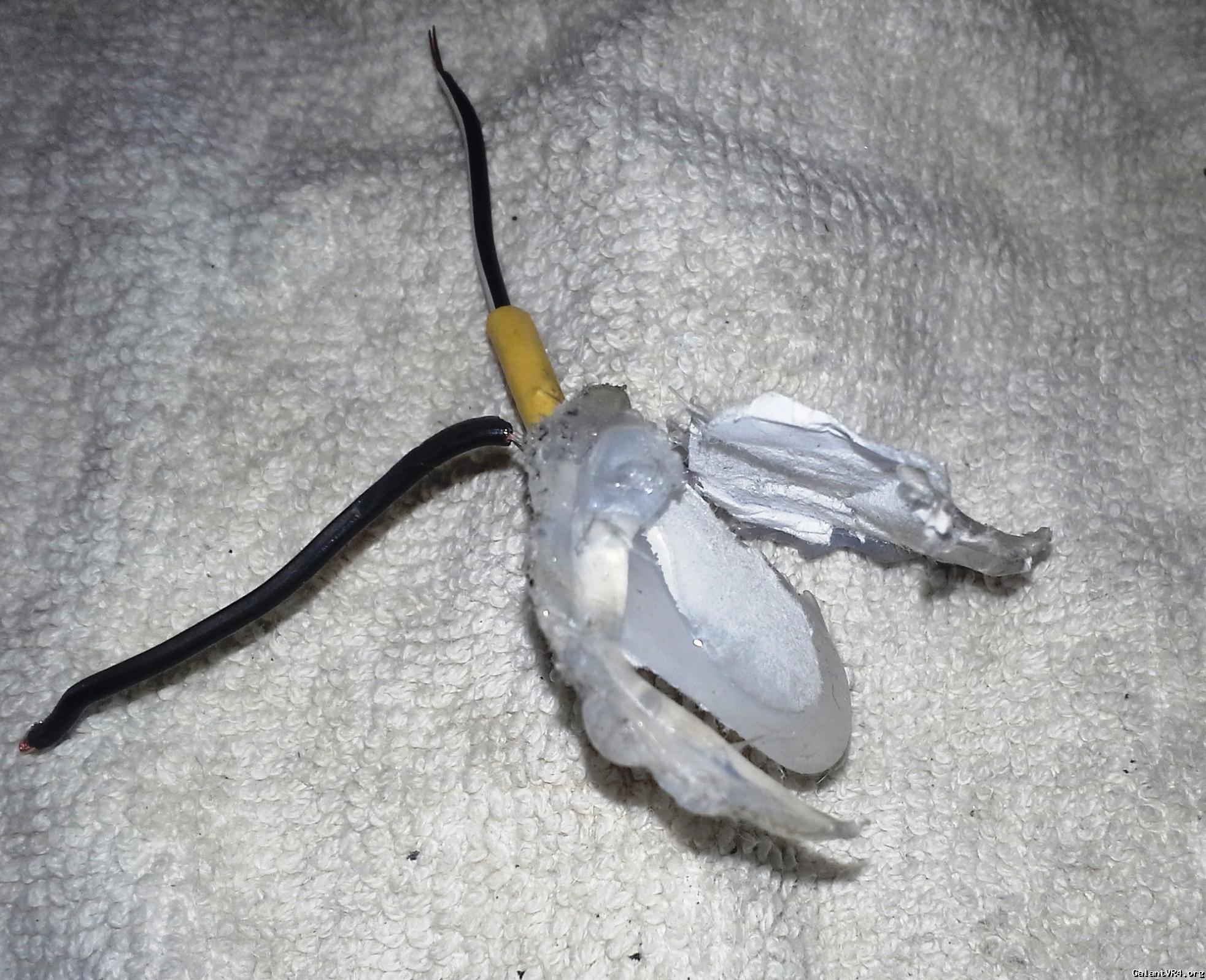

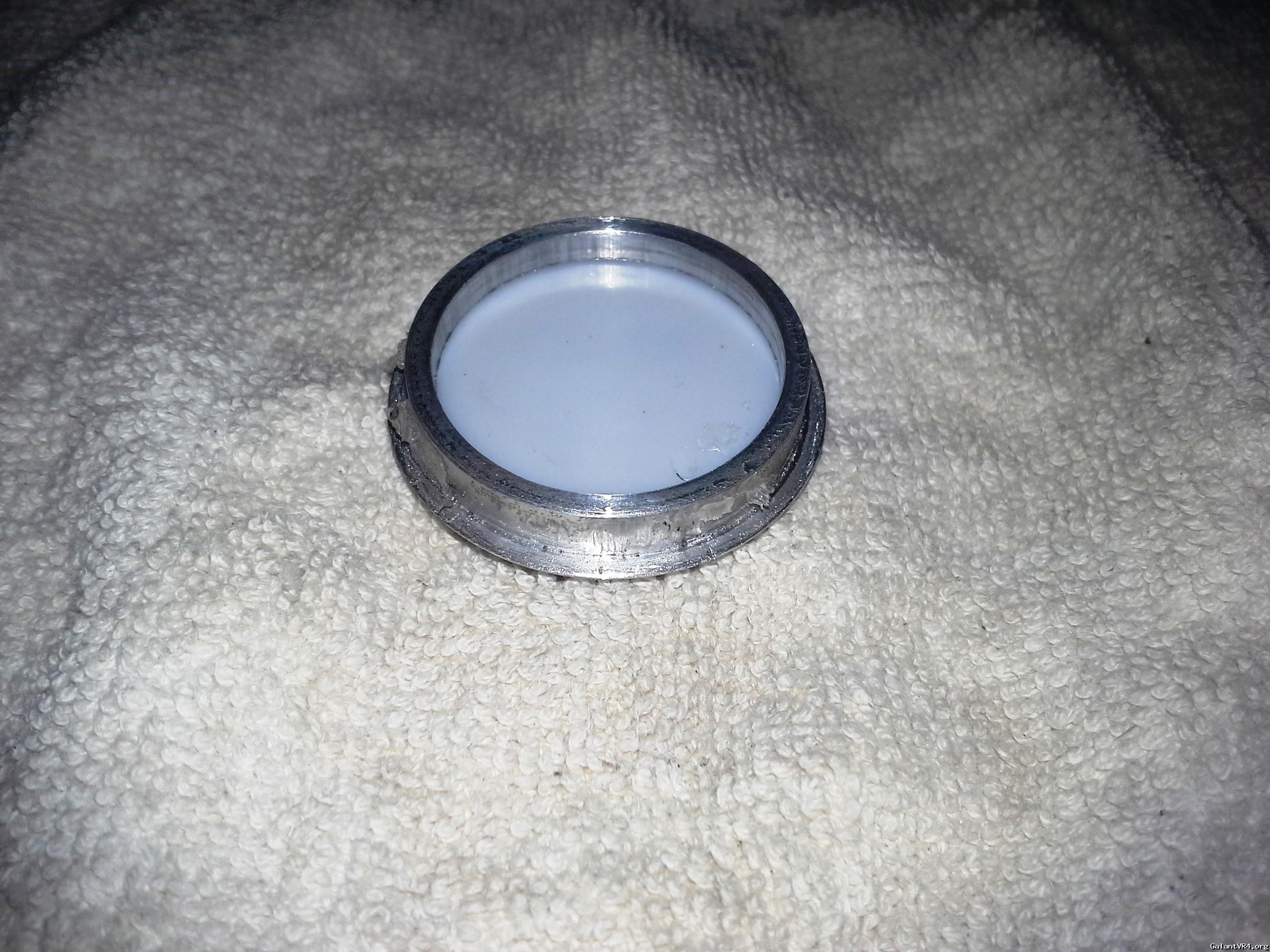

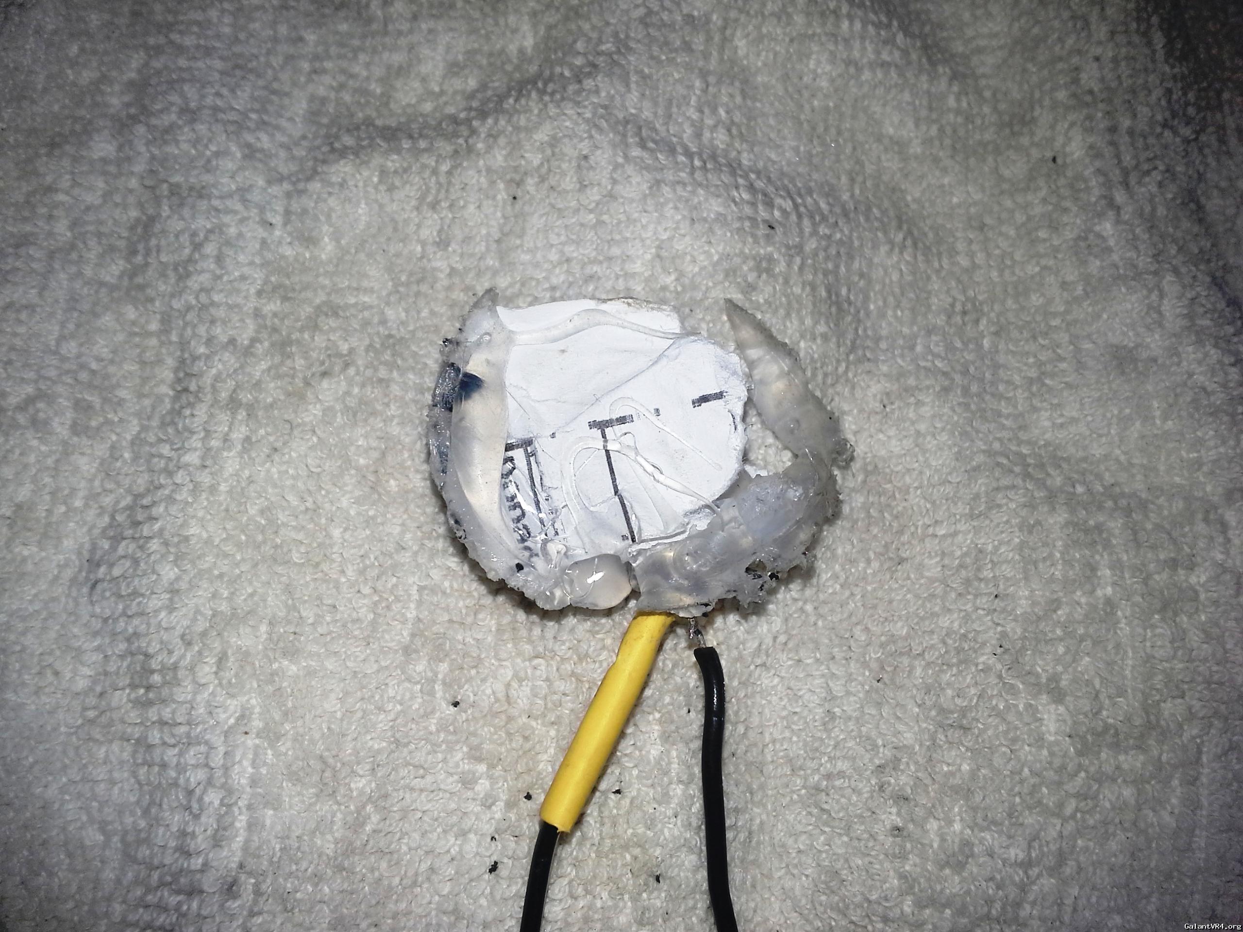

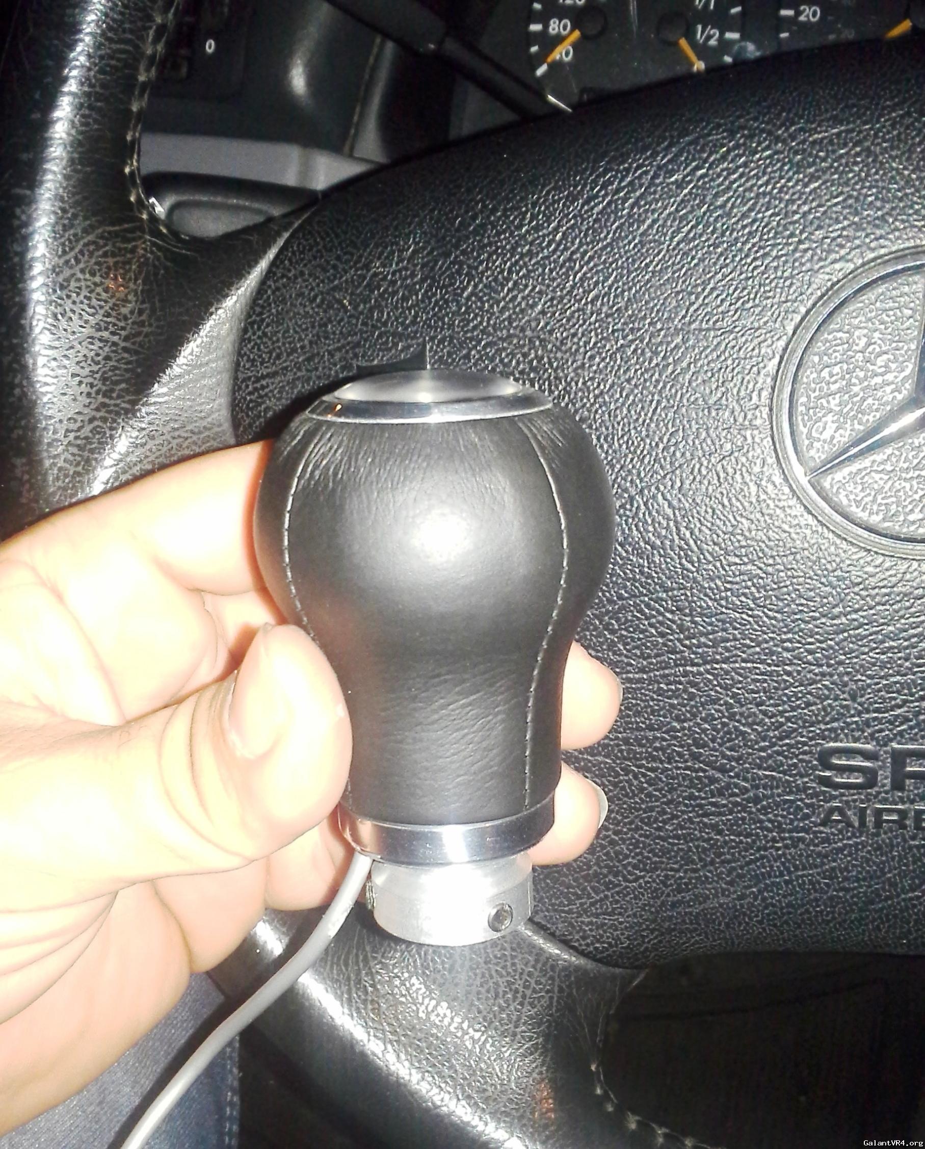

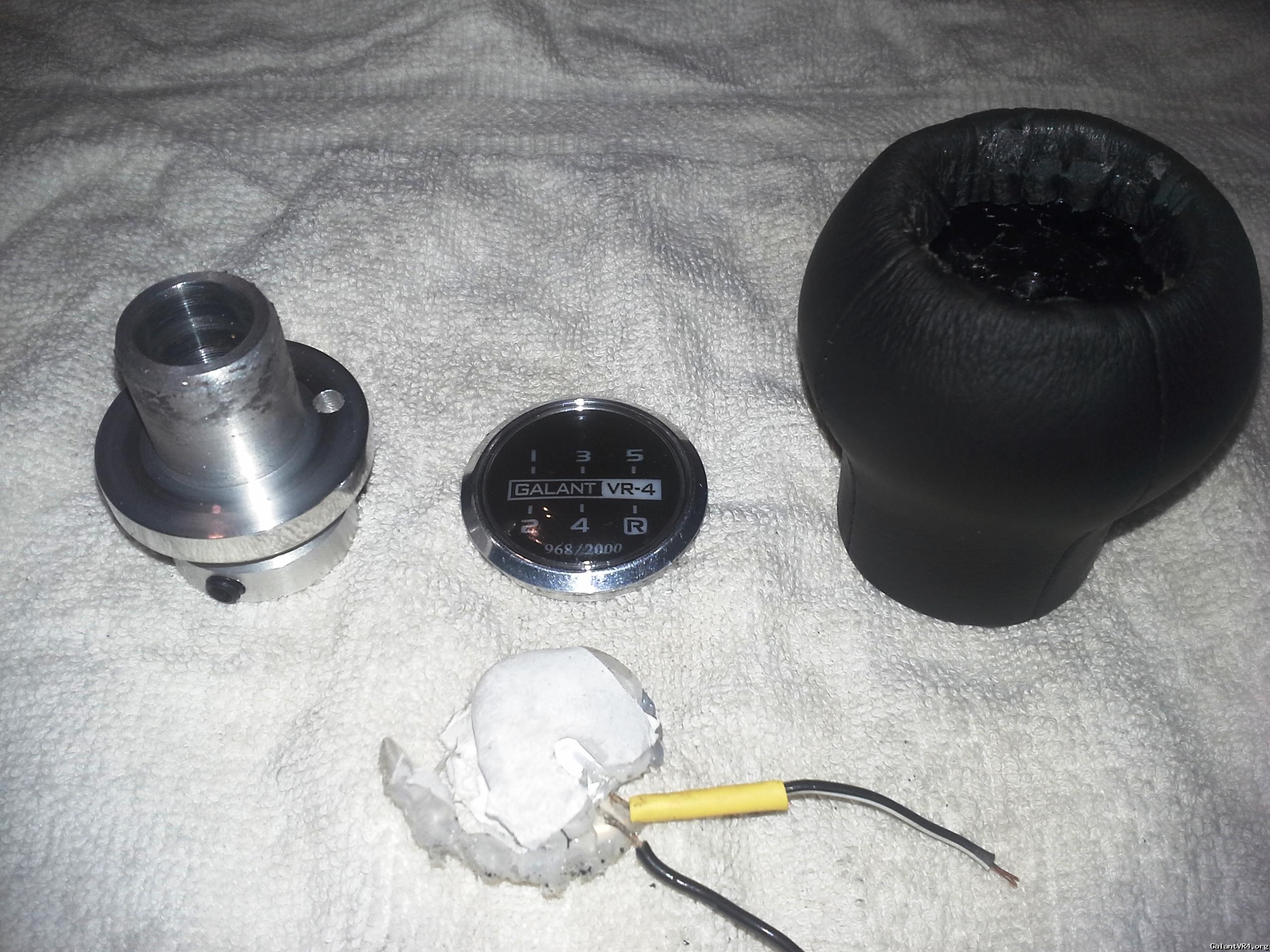

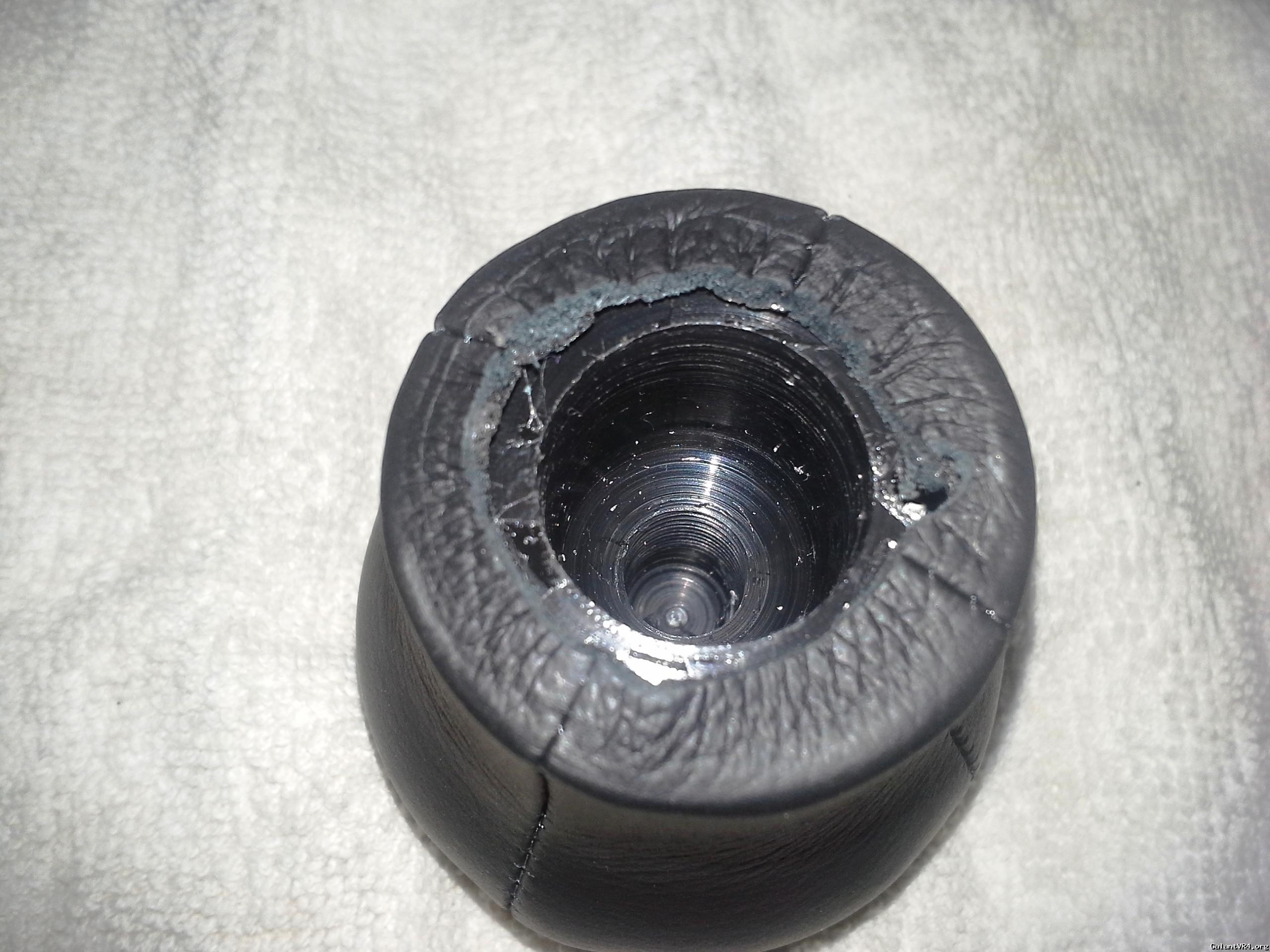

After LED not working i decided to disassemble the knob completely knowing that it wasn't necessary but since i was at the task i just decided that way (curiosity and learning reasons). And this is how it came out to be:

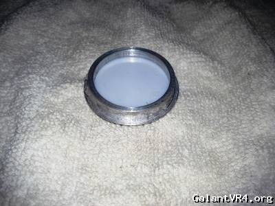

In a case where the LED needs to be replaced you don't have to take all apart like i did. You just carefully (with a plastic spudger or similar tool so you don't damage the aluminum ring) pry open the top cover (where shifts #'s are) and carefully pull it out.

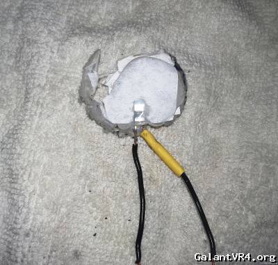

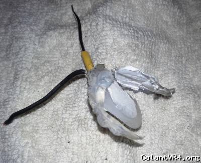

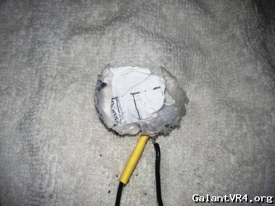

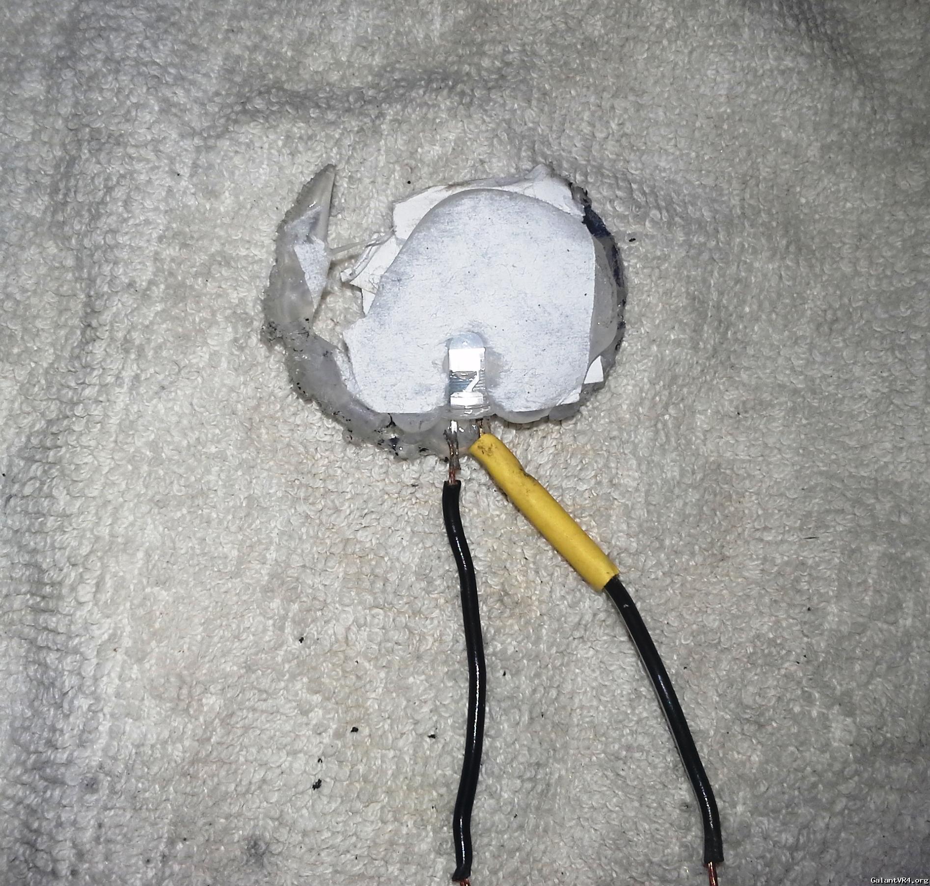

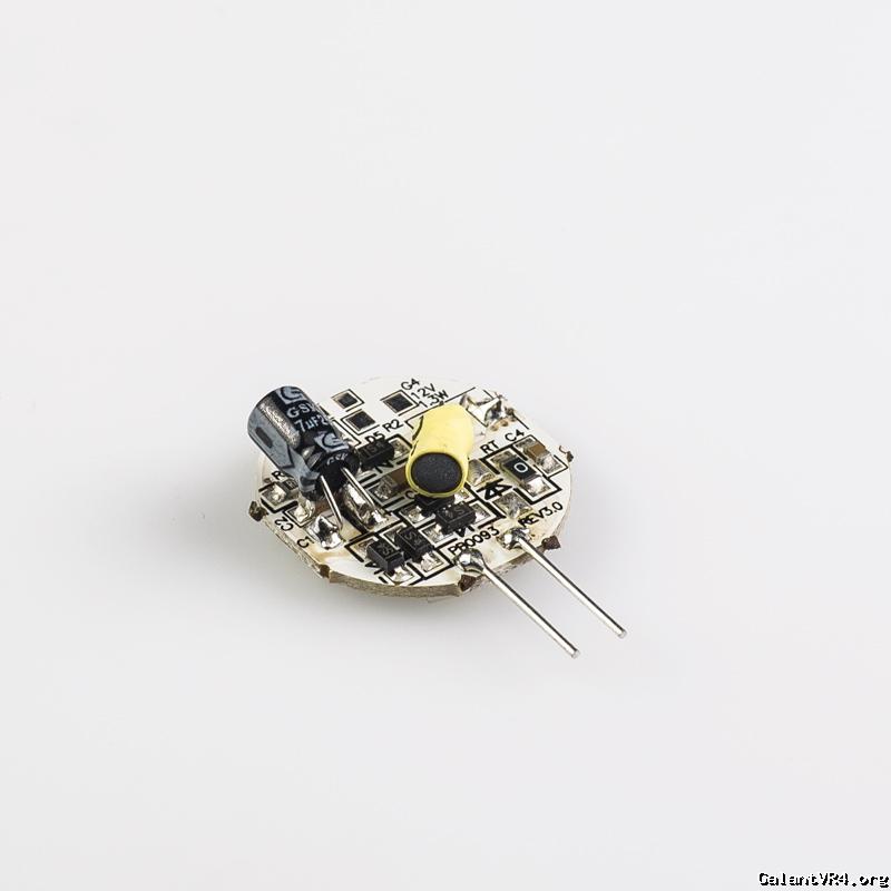

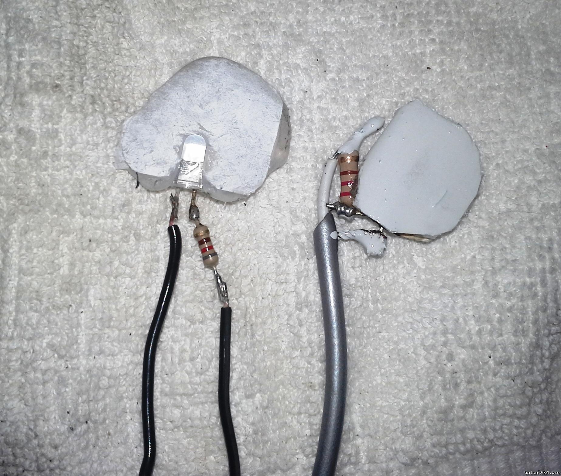

After that you will surprisingly find a very simple single LED "bathed" in Hot Melt Adhesive (HMA), also known as hot glue sandwhiched between pieces of used printed paper (see pics if you don't believe me). After scratching my head /ubbthreads/images/graemlins/confused.gif for a few seconds i realized that the purpose of the HMA and paper was to create (obviously) a bond and some diffusion/spreading of light to "cover" the whole numbers and letters area on top. How ingenious! /ubbthreads/images/graemlins/uhh.gif
Anyways, after thinking for 10 seconds i decided to stick with the same "german engineering" (makes me wonder the difference between this and a chinese fabrication? or who's pirating who?) so i searched for 1 minute around my work area for parts and within 10 minutes i replicated this:

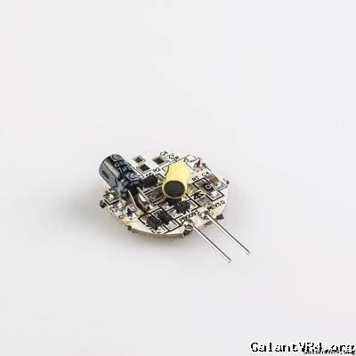

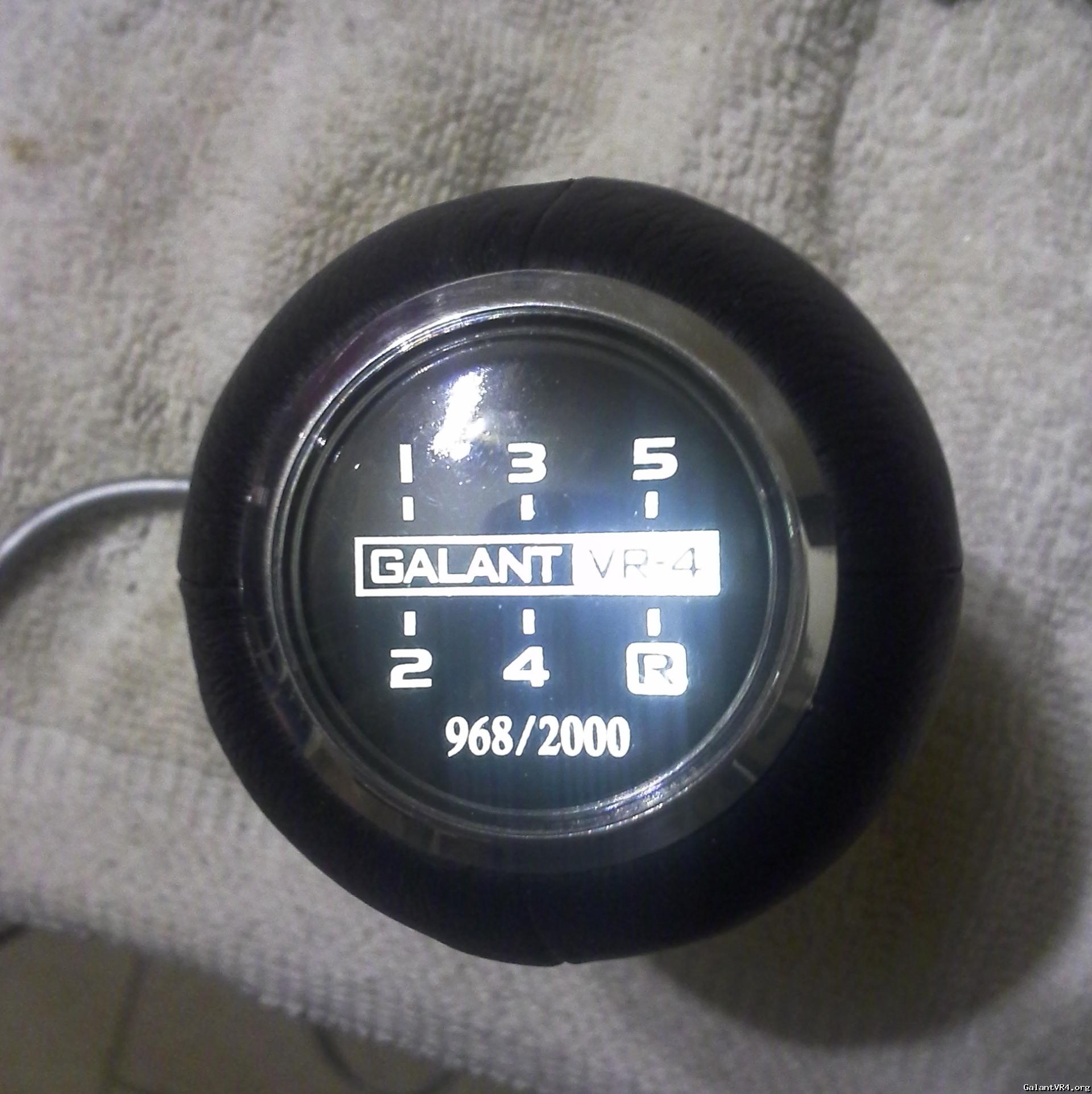

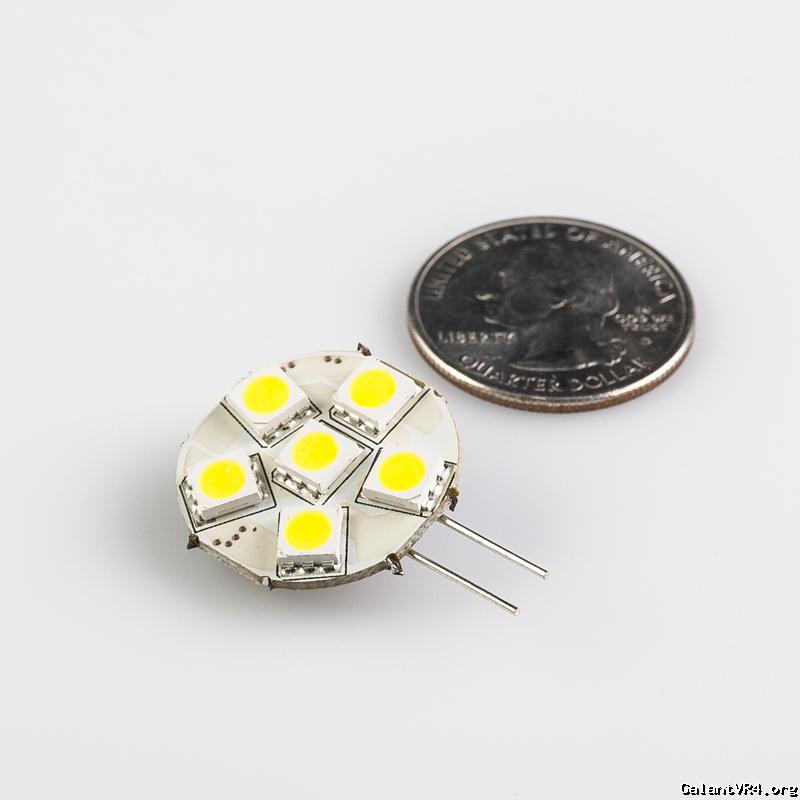

My 4 year old son told me that i could get something like this better:

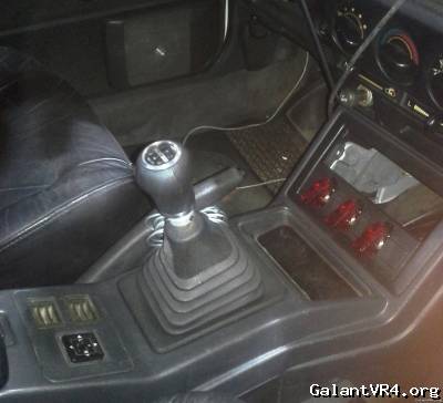

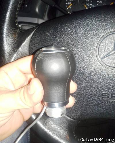

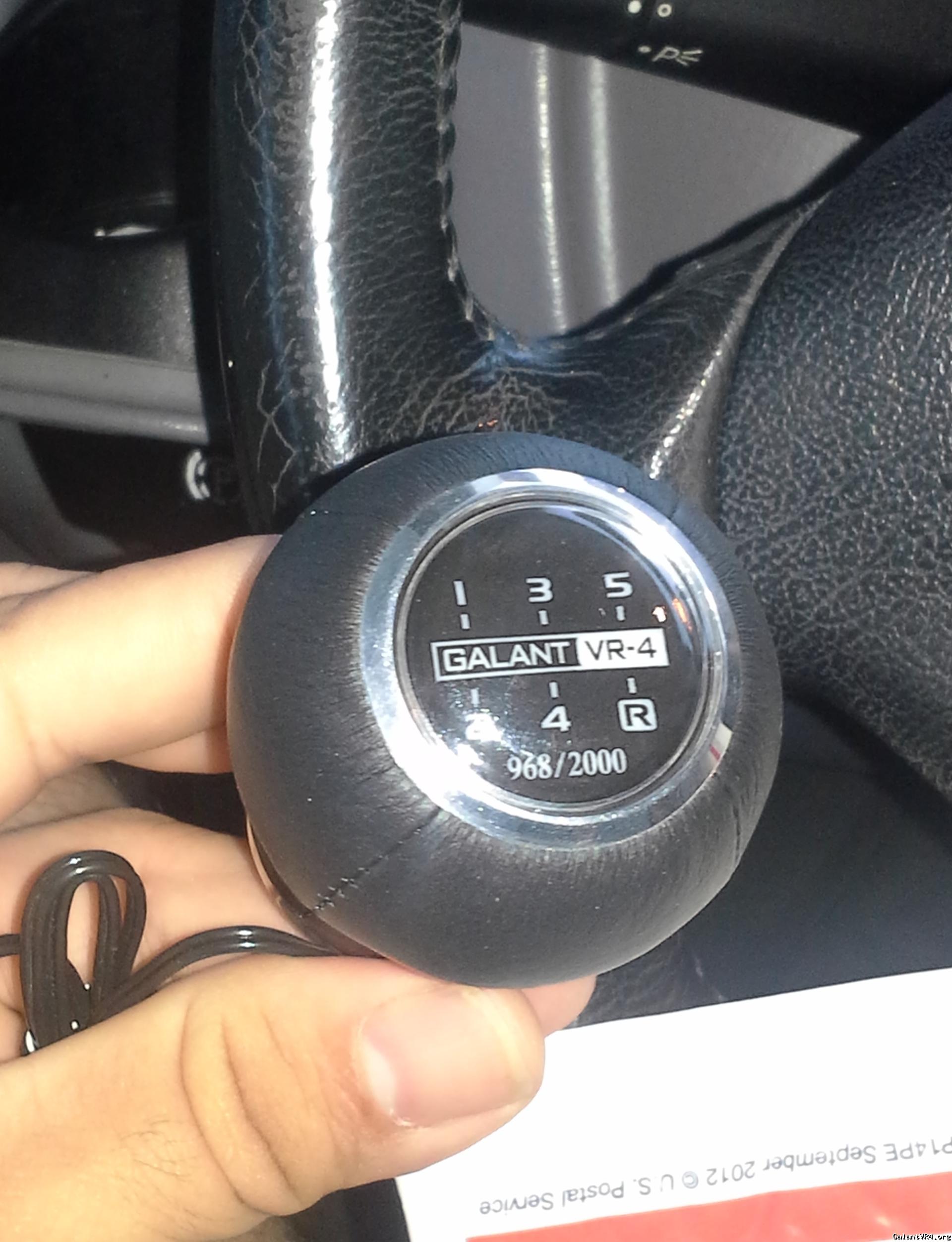

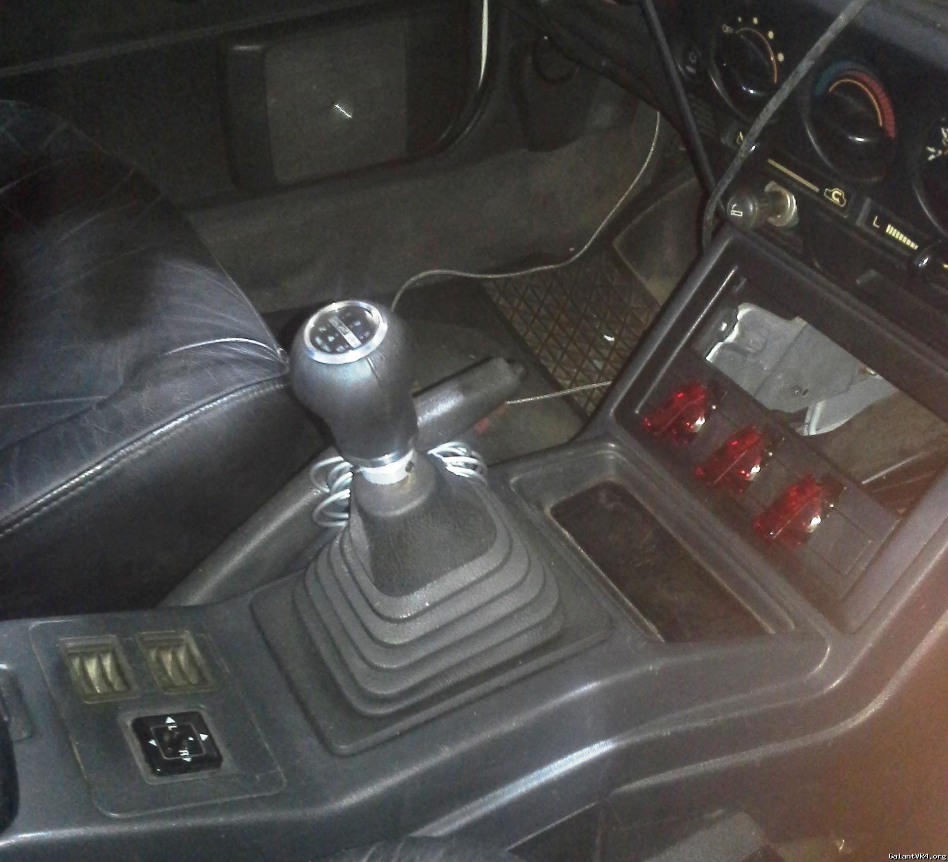

But i told my son that i wanted to K.I.S.S. also. So this is my fixed knob results:
Hope this helps. Thanks.

^^^ Holy Crap!
No fault on Racah's part here but damn I think this German Engineering design ought to get more exposure on other forums LOL. Should keep the tree hugging hippies happy, since they at least used recycled paper.
Any links to the 4 year old real LED solution? I am quite tempted now that you have shown how to do this to completely redo mine. I think the knob would benefit from more weight and would look better with the top ring anodized/powder coated black. Might as well fix the diffuser led whilst I am in there.

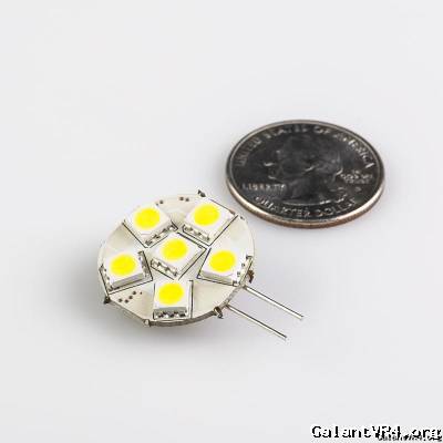

Paul.
Hi Paul, here's the link to the round REAL LED. That site is a LED superstore. And if you're planning on disassembling the knob, to pull the bottom aluminum piece (where the 3 allen screws are) i recommend to double wrap the area with a microfiber cloth or anything that comes to mind to prevent scoring or marking the aluminum and then use some vise-grip pliers to "grip" the wrapped part. Then using a pull (hard) and twist (left & right) motion you take it apart. Also be advised that the wires will be cut during that procedure but anyways they will be replaced. Good luck. /ubbthreads/images/graemlins/idea.gif
