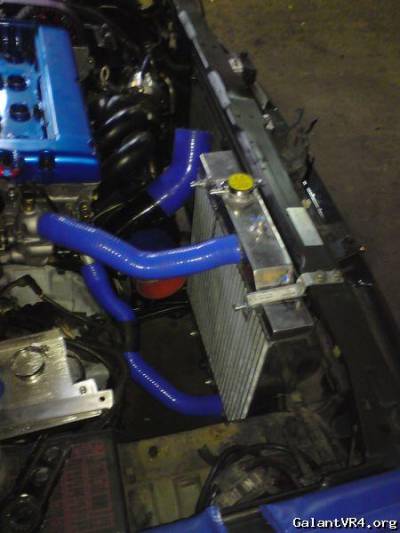

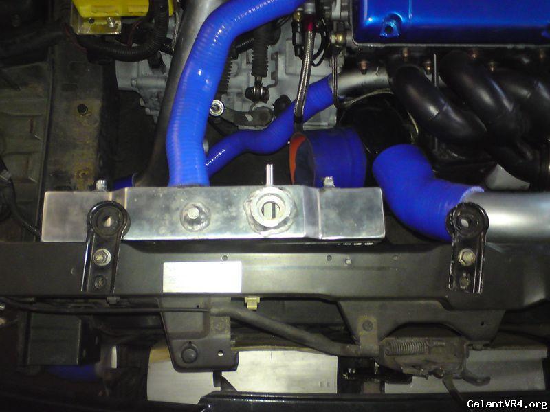

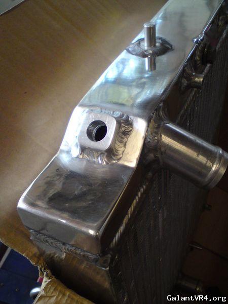

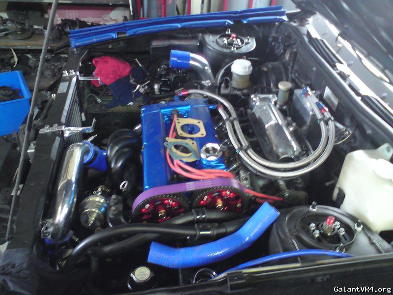

bazeng
Feb 6, 2003
2,520

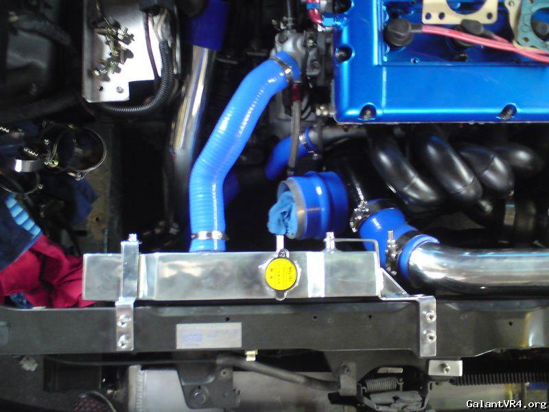

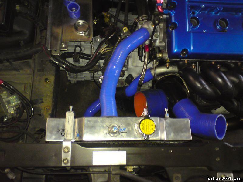

Melbourne, Australia

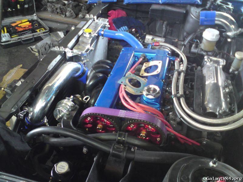

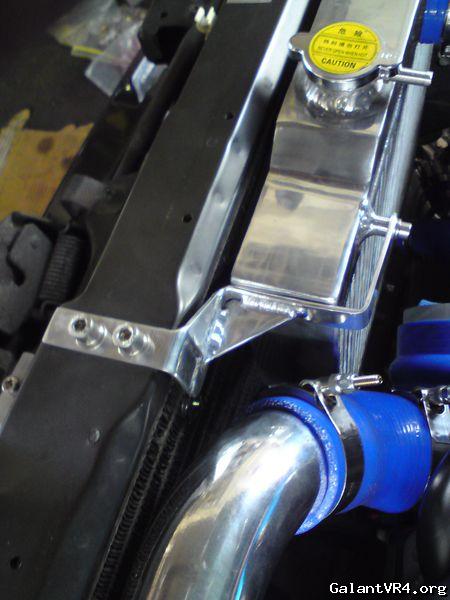

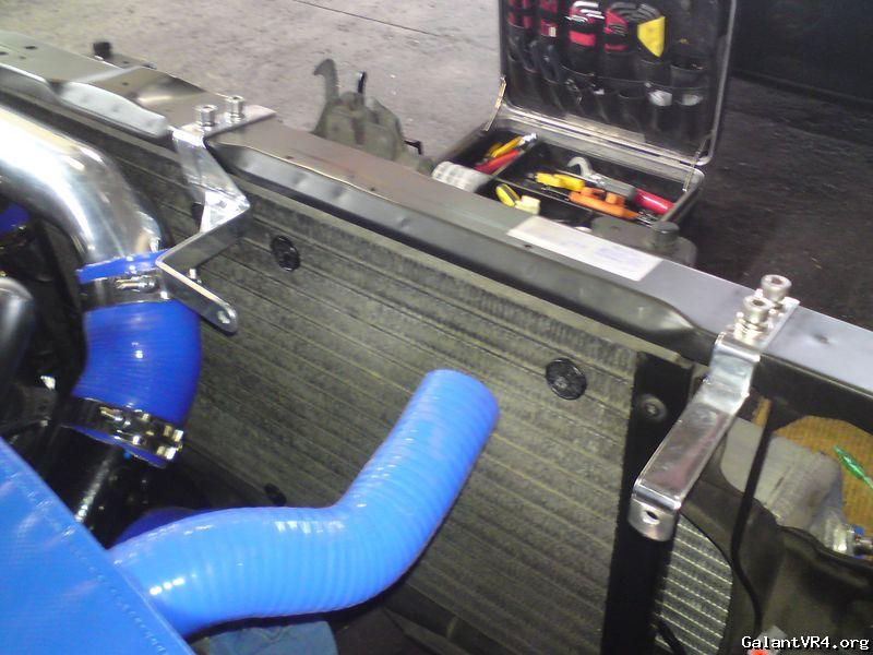

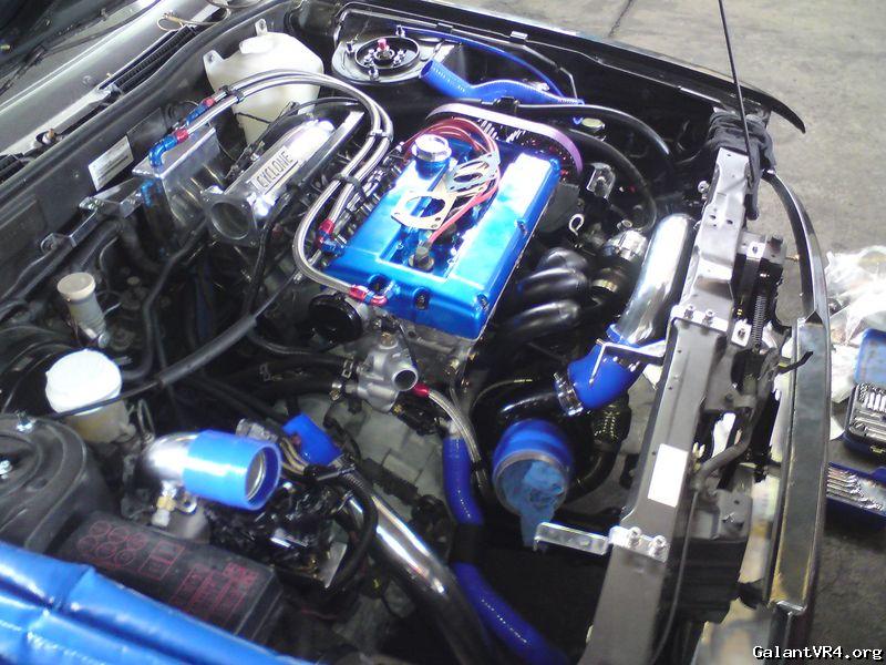

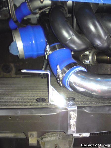

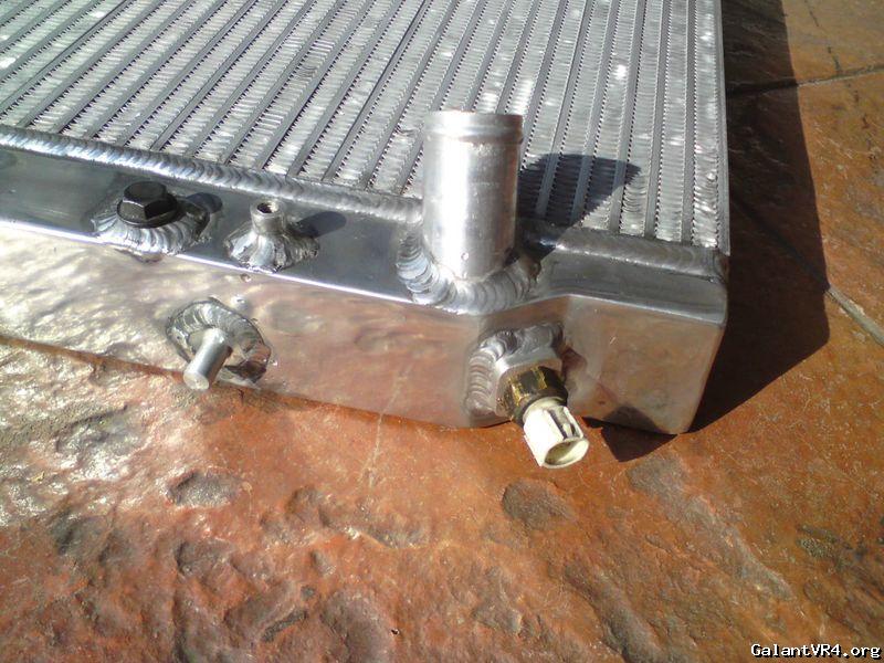

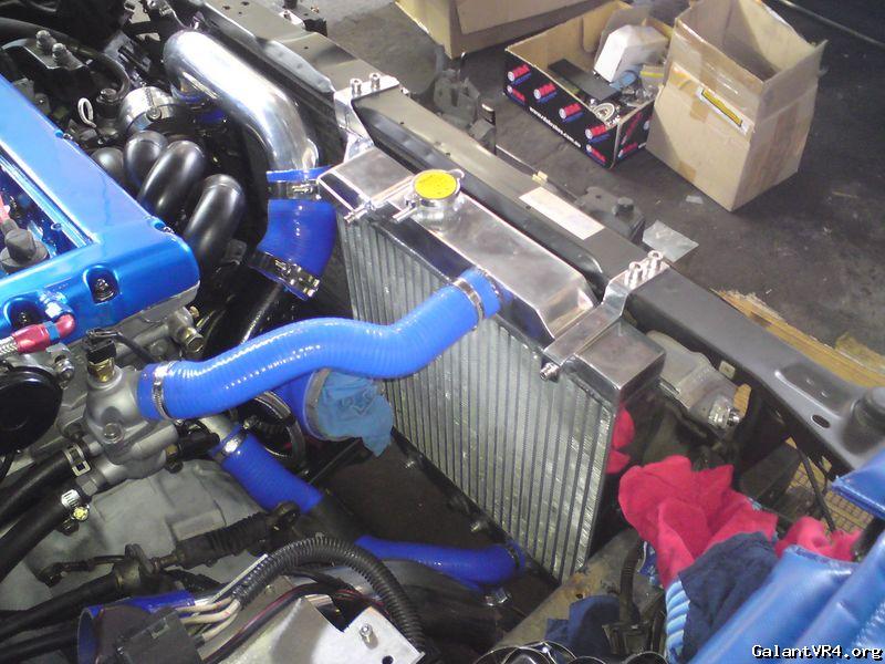

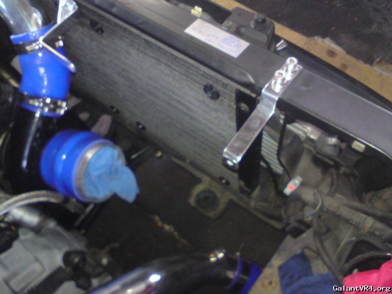

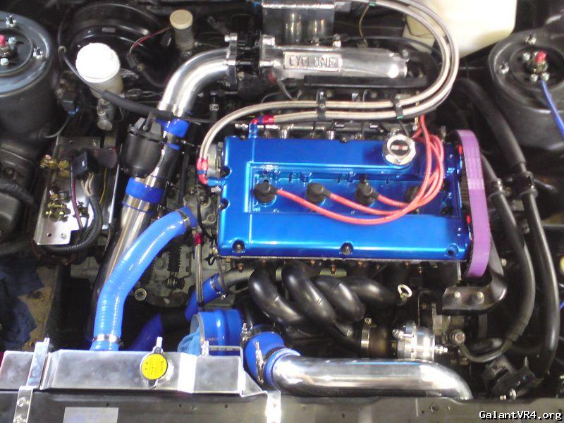

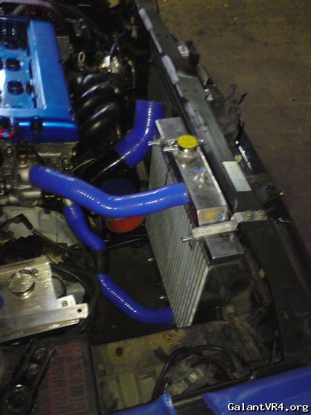

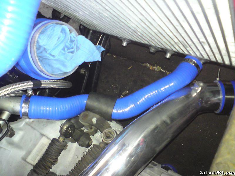

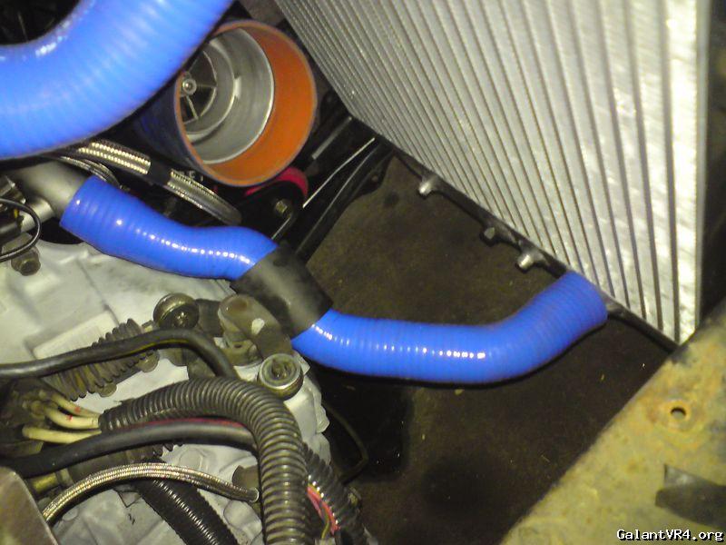

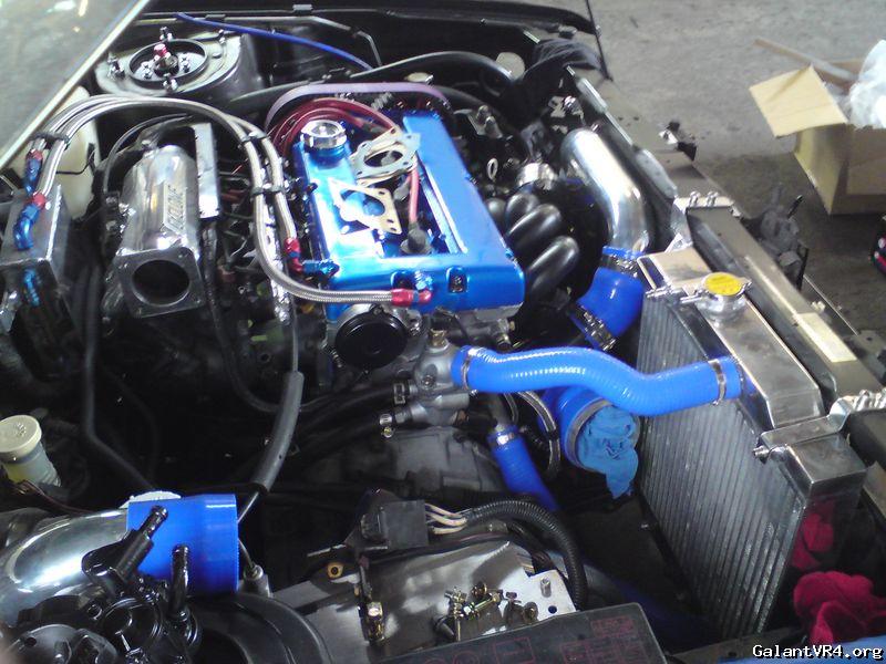

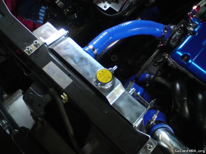

I used the stock fan mounts on the civic radiator as the radiator brackets to the chassis.
I didn't want to drill any holes in the AMG so I decided to use the existing holes in the rad support.

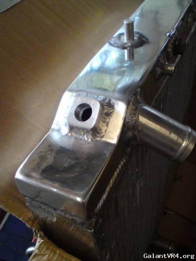

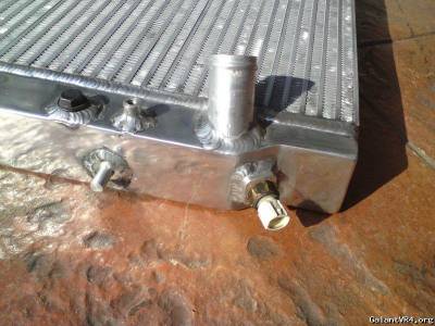

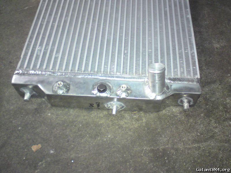

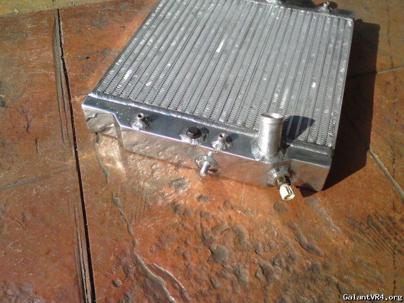

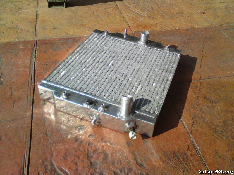

I also decided to minimise the welding on the radiator so I grounded off the civic nipples/rods and gave it a polish.

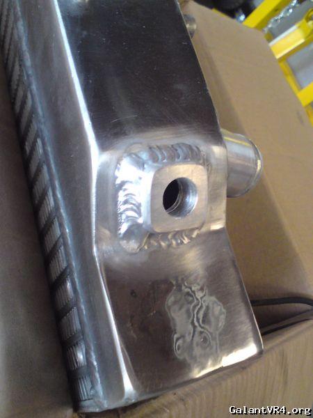

As for the temp sensor, the tank thickness is thick, but not as thick as I would have liked, so I just had a little boss welded underneath and then tapped to suit the stock temp fan sensor.
I also retained the stock lower nipple on the civic radiator (lower tank) and used it in the stock galant mounting bracket grommet.

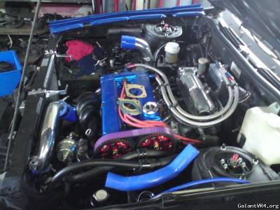

The overall performance is good on the street and dyno.
I am using it with a lower temp thermostat though (78 deg)
Here are the pics of my install.
