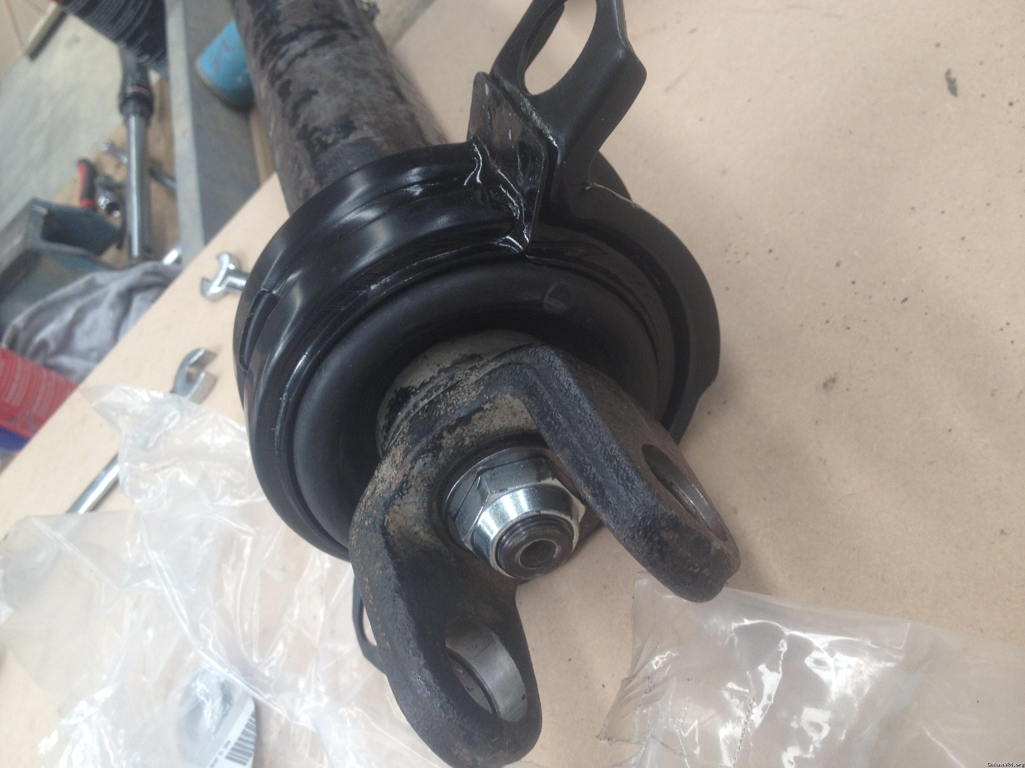

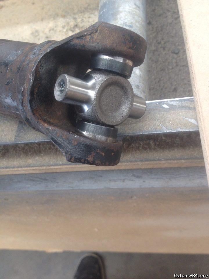

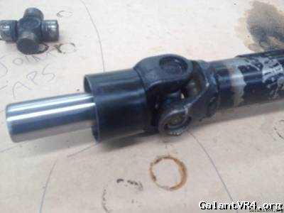

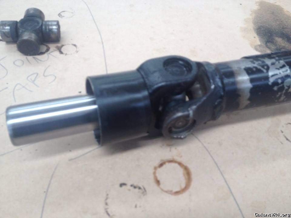

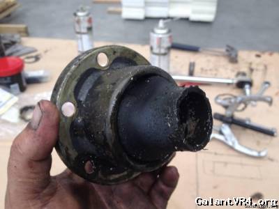

here some pics, not a big deal im sure al
ot of you are familiar with it

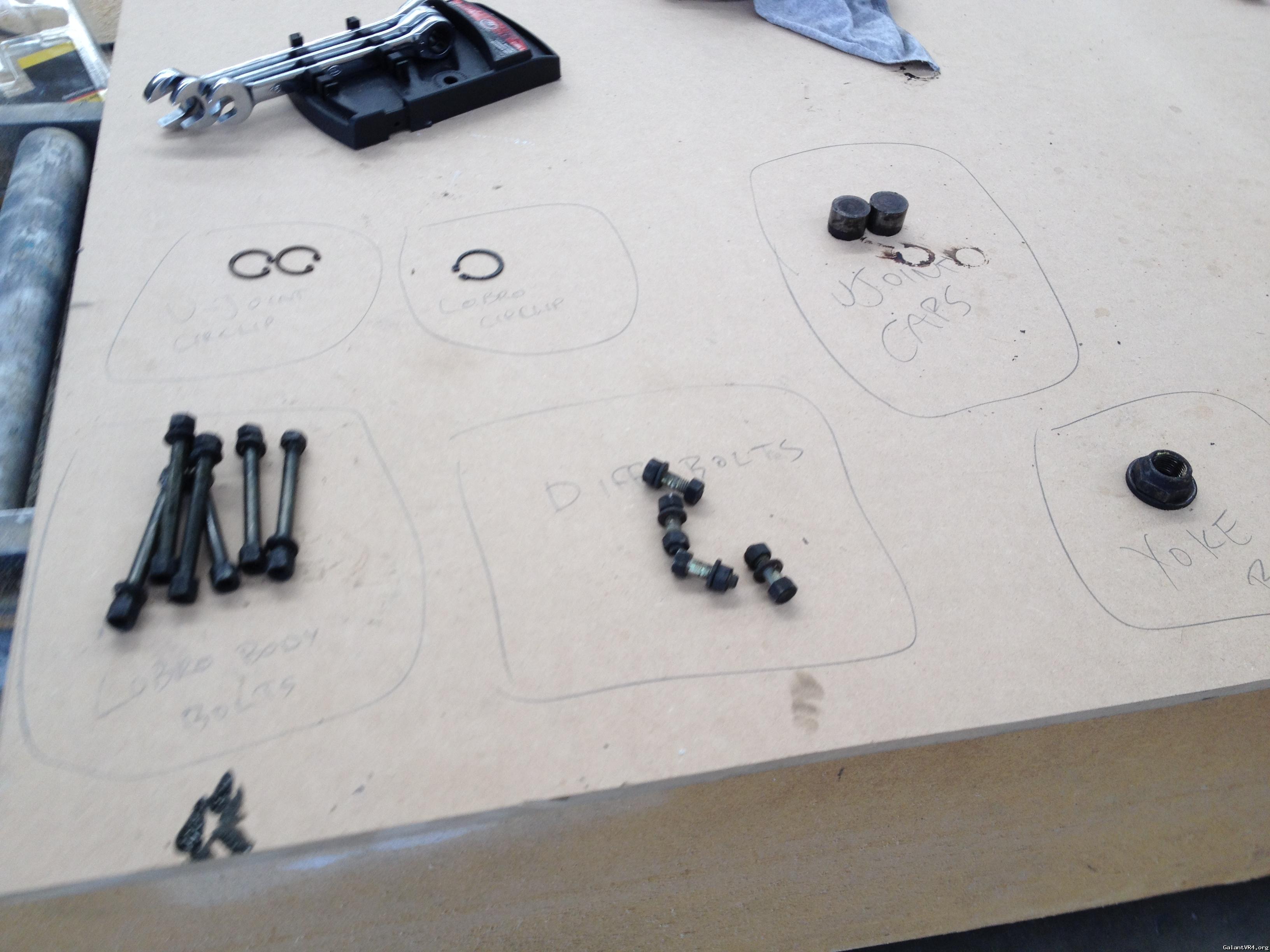

here me trying to be organised

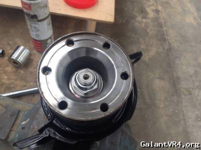

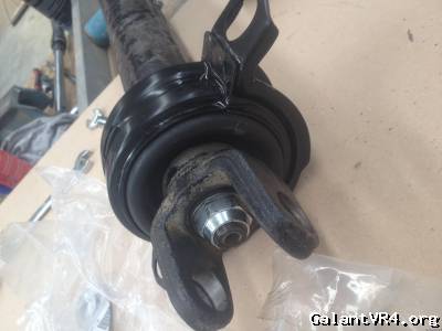

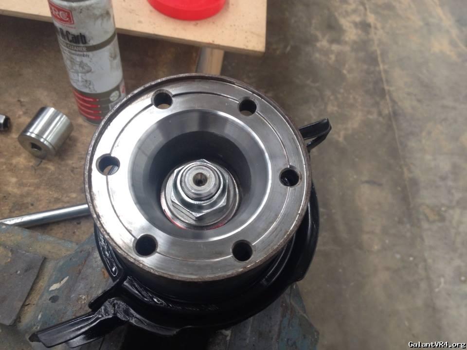

splines thoroughly cleaned new hanger bearing and new washer and nut. (new nut is a must)
my old one had a groove worn in

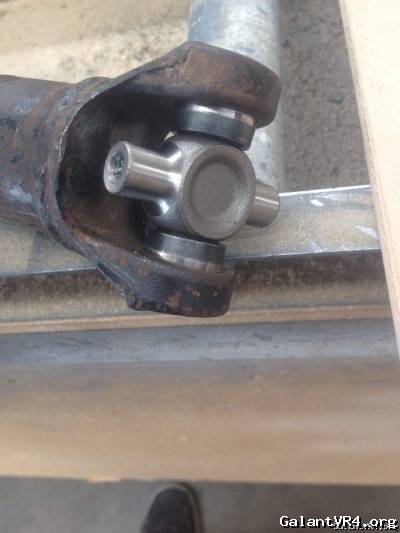

new universal joints

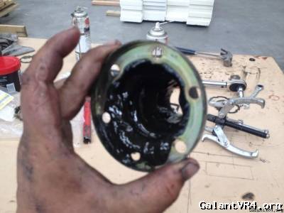

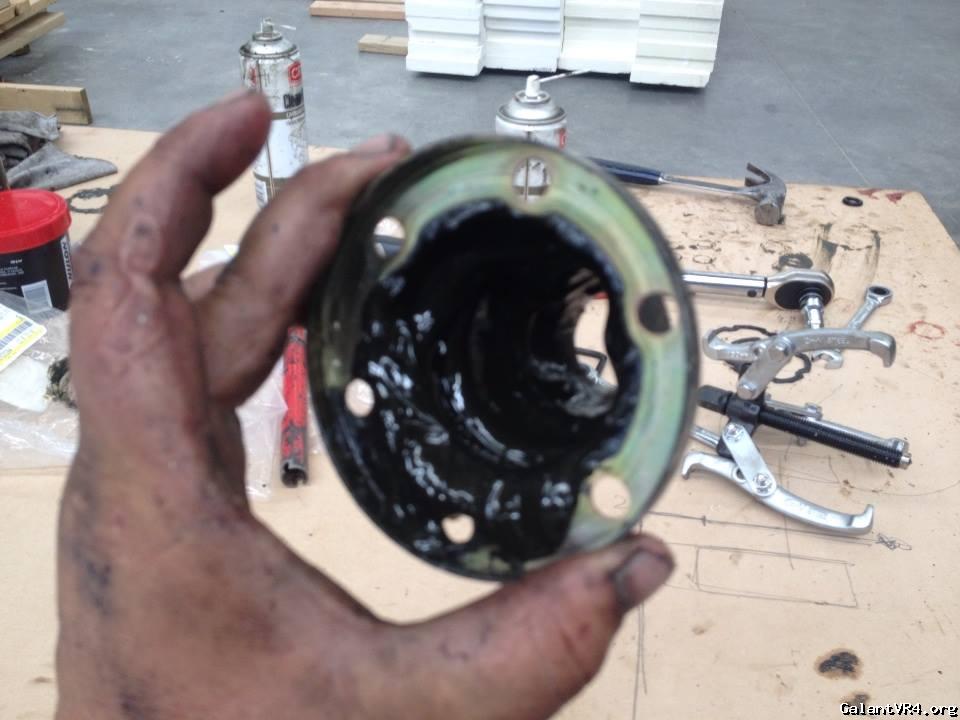

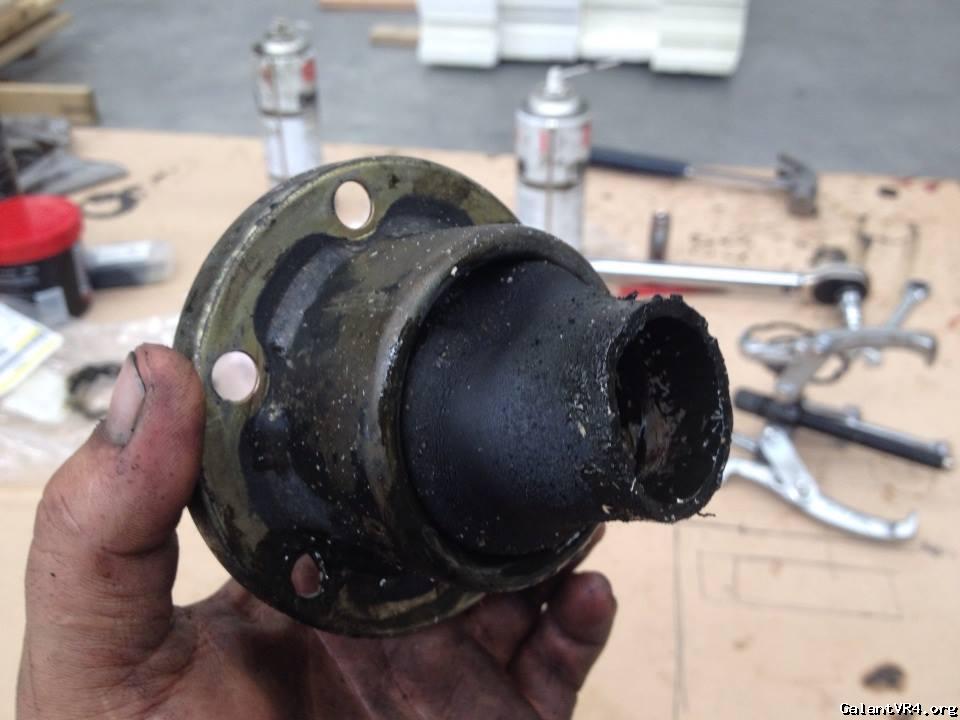

old scummy 22 year old grease and split lobro boot

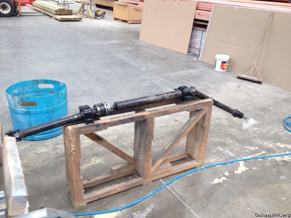

and complete
was a great project to do and fairly easy, a few key things are to not re-use the x2 nuts they wont torque down again, and use the same coloured circlips on the universal joints (the packaged mitsubishi units were mixed up). im sure there is alot more you experienced guys have to share also
thanks.

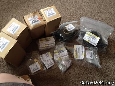

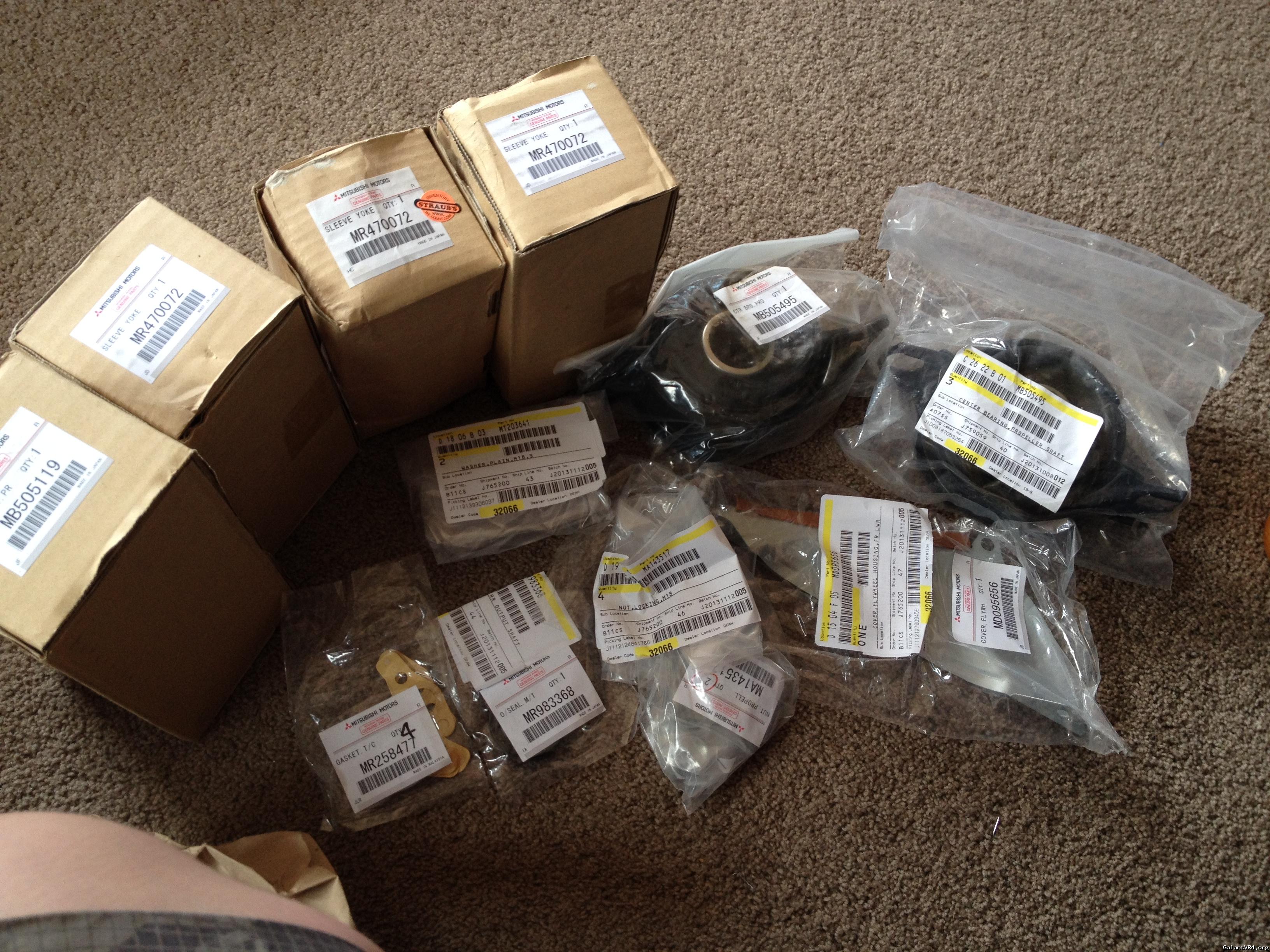

Thanks for the write up. Can you put up a list of all the parts/part numbers you used numbers to do this?

He's got a lot more parts in his photo than what comes in JNZ's kit.
How many U-joints do you see there?
maroonmetallic
Jun 10, 2004
2,100
central WI
Quoting GSTwithPSI:
If you click on the original poster's pictures you can see all of the part numbers.
He has "more parts" because he also got t-case gaskets & the inspection plate by the t-case.
Can't you read the JNZ link? The link clearly states you get 3 t-case yoke kits.
"Surprisingly" that is the exact same number shown in the poster's picture.

I clicked on every picture in this post and every picture in links and could not read any part #'s. Picture in original post is too small to read.

hey man sure thing
x3 yoke kits MR470072
x2 washers MT203641
x2 nuts MA143517
x2 carrier bearings MB505495
x1 T-case seal MR983368
x1 boot kit MB505119
i ordered x2 nuts and got x4 not sure if they are sold as a pair or if it was an error because the washers come as single, you have gone to all this effort so dont stinge out with the t-case seal buy it and do it, the boot kit will more than likely be buggered if your car has done a few miles or kilometres so replace it and you get the 60grams of grease you need and the gaskets, some people will be unlucky and the lobro joint itself will be stuffed, its expensive but here it is if you need it x1 lobro joint and boot kit MB837300 if you need the whole joint dont order MB505119 unless you want a fleshlight.if you have corrosion or bad piting you will need to replace it.
i bought all this from mitsparts.com online along with a few extra gaskets and inspection plate for $388 US thats excluding shipping, if you need to watch a video youtube jafromobile i watched the videos a couple of times, jafro makes a good video, was easily accompliched with a basic toolkit, a great day project
