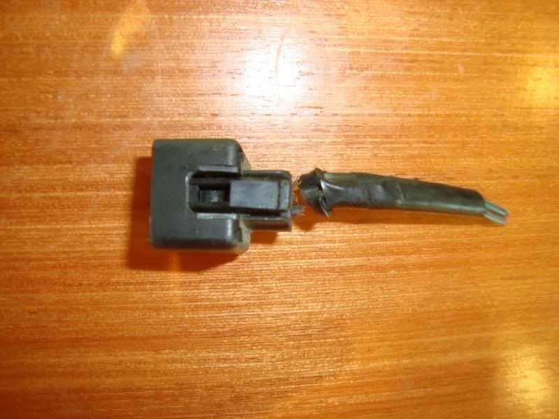

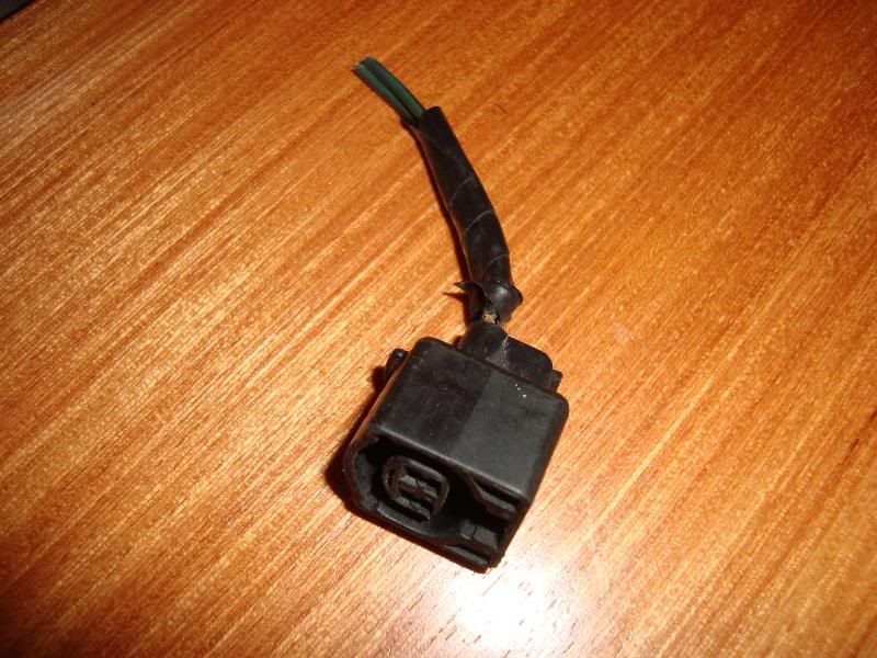

Grrr! Broken 2 prong connecter on top of thermostat assembly
I noticed that the plastic connector [2 prong] on top of the thermostat assembly has a broken wire, and the other wire is hanging on by a couple of threads,

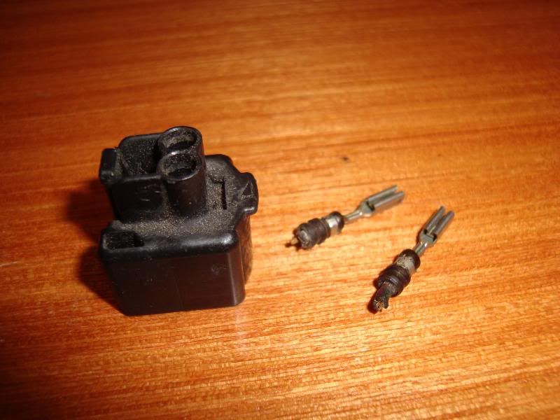

I managed to pull the pins from the connector, and wanted to know where I could get NEW pin connectors and start over with new pins and fresh wire.......

I ended up using two small, insulated spade connectors (that fit snug on the terminals) and butt-splicing onto the factory connector, until I get a replacement. Just make note which wire goes to which terminal, to not mix them up (may not matter on this, but still)...Not the best way (I want to get an oem replacement and eliminate the butt splices], but works for now...

Well, your plastic housing is in good shape (I think mine was cracked, iirc), so if you're tricky, you could undo the factory crimp on those spades and put in the wire (oem, if you have enough slack) and re-crimp...as you're probably aware, since you took them out, they have little barbs (or maybe it's those black, notched 'sleeves' in this case) that snap into place...This is the way I would've done it, if my housing was alright...
Another option is to look at an AMP catalog (or similar), as most oem's use various styles like that, although many of them are proprietary, for obvious reasons...
Yeah, there was a plastic locking lip that just needed to be pressed downwards while I pulled on the wire and the connector slid out of the plastic housing!!
I'll check online under "mini spade" conntectors.

If it uses the same pins as the ECU plugs, I can send you several of those.

Does your AC work? If it doesn't then you don't need that anyway. In fact, you might not need it anyway. I think its just to turn the AC off under an overheat condition. I could be wrong but I think that's what its for. You can carefully disassemble the spades and solder new wires to them. I rebuilt my CAS plug like that.

I have a few of the connector bodies that will work for that plug, but no pins. I resoldered mine onto the original pins when I fixed it.
If someone knows where to get those pins, that would be great. IIRC, I did not have the right size in my selection.

Are they the same size/type of lins that are in the plugs that connect to the ECU? If so I've offered to send him several. We just need to verify that the ECU pins will work for this application.
