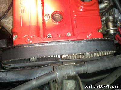

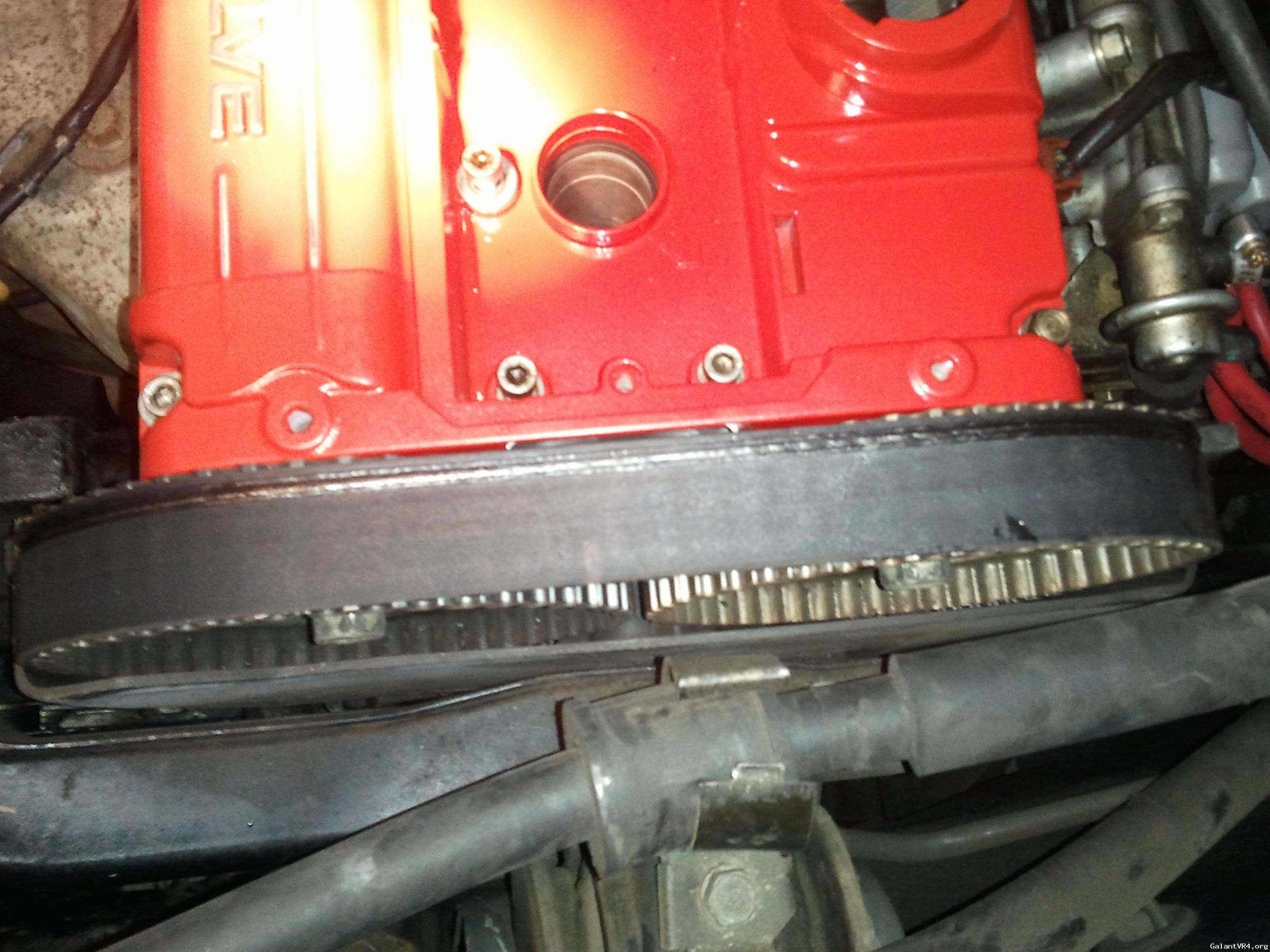

I replaced my Valve cover the other day and obviously had the cam cover off to do it and noticed a quarter inch wide groove that looks like was evenly dug into the timing belt on the inside just before the inside edge. It's cut maybe an 1/8" deep into the timing belt. What would cause this and is the timing belt compromised to the point that it will need replacement?? It would really suck if it did because I can't imagine it would be cheap to fix. Here's a pic. Thoughts??

On the oil pan there are 2 bolts that are shorter than the rest. My bet is that they were mixed up and the longer ones used in their place. They would be located near the oil pump gear.

You should not drive the car. Replace the belt now. You should be able to remove the offending bolts easily from the bottom of the pan without pulling the whole thing off, but the damage is done.

A)The belt is toast
B)It is now very prone to failure, no matter how you drive.
Your choice, a $75 belt and an afternoon of work OR up to 16 bent valves, broke pistons, etc etc which will cost you WAY more.
