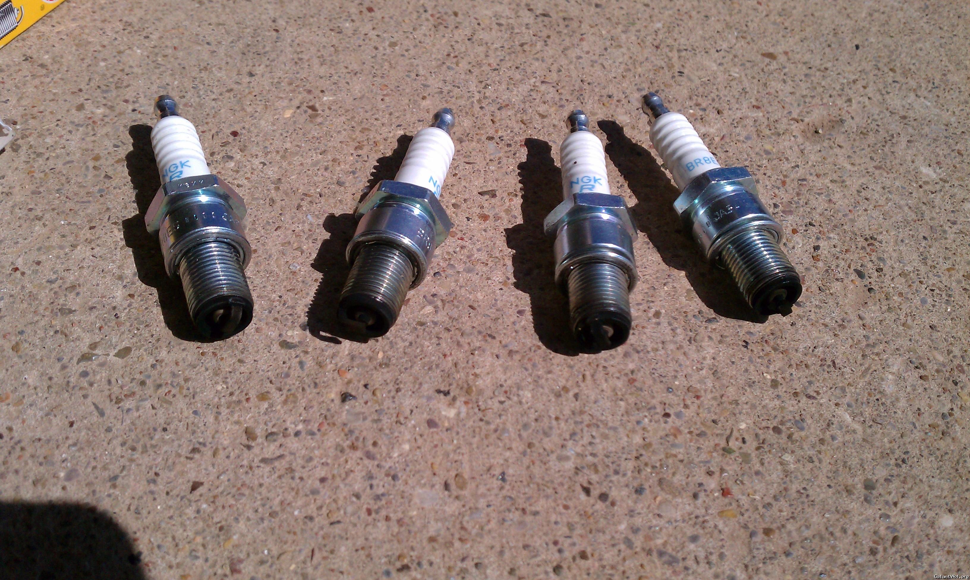

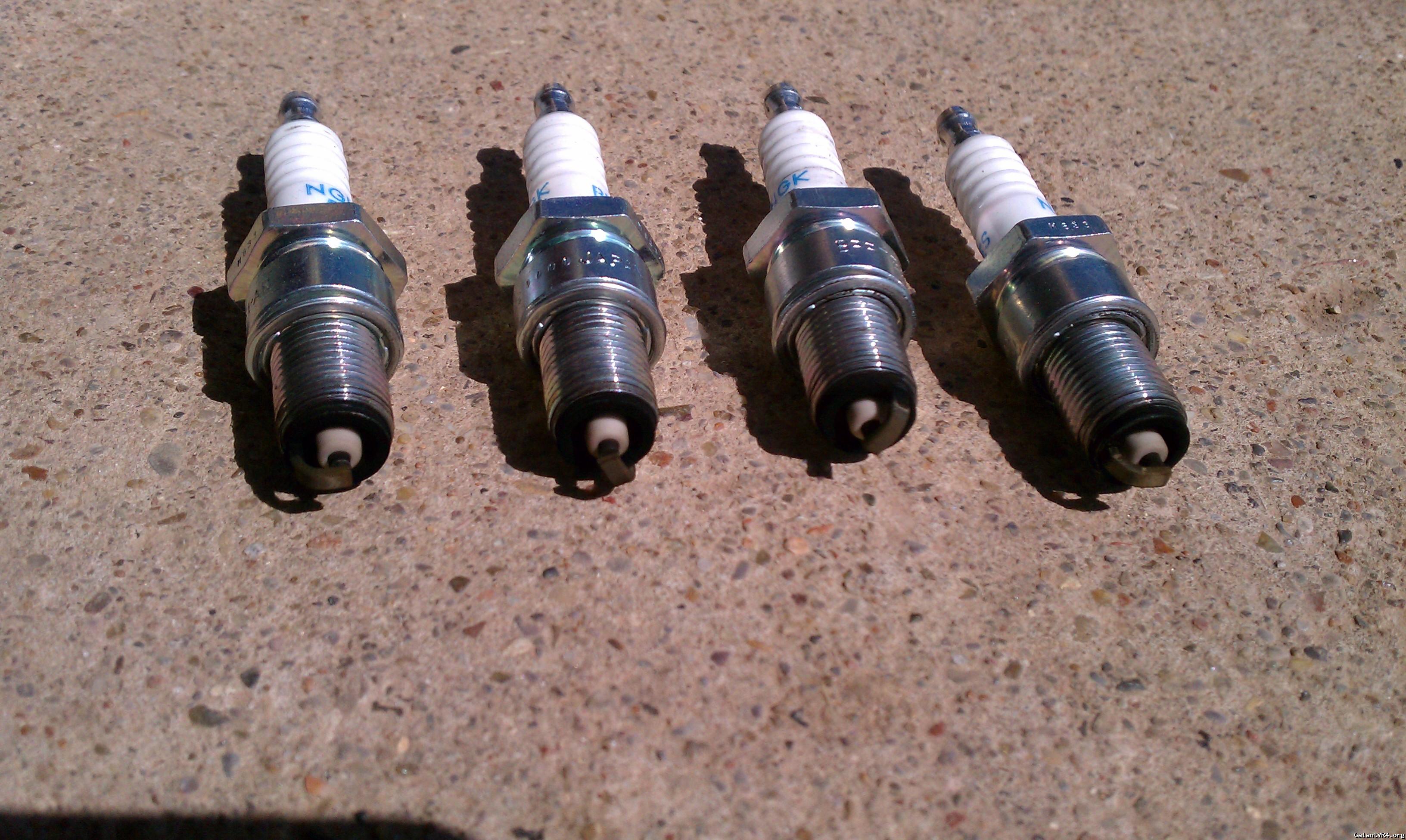

I will take pics of the plugs this evening.

These plugs I put in new after I got back from the tune with 90 oct already back in the tank. maybe 10-20 miles on them
These are the ones they put in at Abel on the dyno. They saw many dyno pulls on e, then a few miles of 90 oct after.

Very rich. Hard to tell on the wot section of the plug. Doesn't look like any detonation. Where your knock sensor is, you might be picking up noise from somewhere else. The knock does increase with rpm. Maybe I missed it but what oil are you running? Also what gave you the idea that you where lifting the head?
