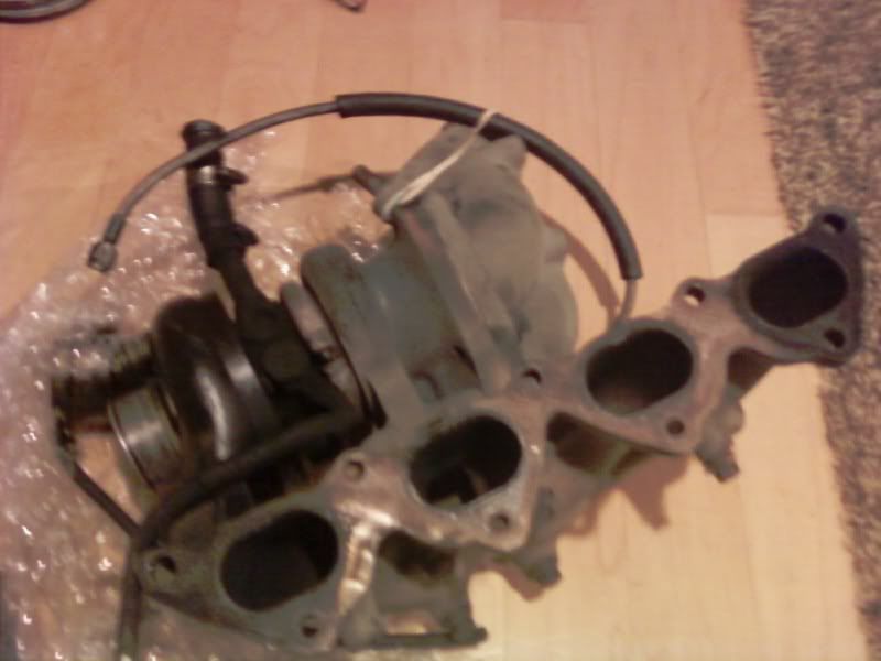

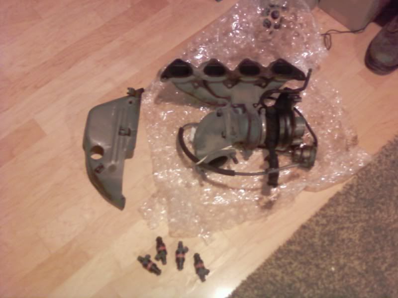

So i bought this turbo setup used, it is a Tre ported s16g port matched manifold, rc 750cc injectors and what i thought was going to be a o2/downpipe combo, its just a 3" downpipe and a ported o2 housing.
so far i am not to sure about this but i will wait for some replies and to actually install this stuff for my finale opinion.
so after inspection these are my results:
injectors look great
3" downpipe is nice also, its just not what i thought i was getting
manifold does not look to be ported in the exhaust ports,
turbo has oil everywhere
turbo band clamp is loose, i can't just barely spin it around the turbo, it seems as if exhaust gas was leaking there, is that possible?
when i spin the turbo with my finger it only spins 1 rotation and stops, maybe a little more.
Turbo has some side to side play, no back and forth play.
How can i tell what these manifolds are? as far as 1g or 2g.
o2 housing part # mr188004 D2
manifold # 7417 and # 115 under the 1st and 4th runners
also they have a grey color to the manifolds and turbine housing, is this a coating for heat?
thanks

"going to be a o2/downpipe combo, its just a 3" downpipe and a ported o2 housing"
So what were you expecting? You said a 02 and downpipe combo but you got a downpipe and ported o2 housing?
11,982
That o2 housing looks pretty hogged out. Should be fine.
Most "ported manifolds" are ported out where it meets the turbo exhaust housing, not at the head exhaust ports.
Journal bearing turbos don't spin much more than a couple rotations when spinning with your fingers, ball bearing turbos do.
Tighten that ring that holds the exhaust housing to the center section. Exhaust gases can definitely leak from there.
Side to side shaft play is normal, in-out play is not.
If somebody pulled that turbo off their running car and then sent it to you without cleaning it up, it's probably normal to be covered in grime and/or oil. I wouldn't do that, but then I fix oil leaks on my cars. Some people don't and oil on parts like the turbo is the result.

I'd find a different oil drain line. That hose and hose clamps looks like bad news. A few people here have had good luck using pushlok hose and hose clamps.

What you need to do is order
-new exhaust manifold gasket for the runners (4layer MLS gasket from mitsu)
-7cm gasket for the turbo
-16G gasket for the O2 housing
Then take apart the turbo setup seperating these gaskets. Match up the new gaskets to the ports and see if they have been port/gasket matched. The O2 housing to downpipe part (2 bolt) has been ported. I dont know how much but the lip is atleast gone. That manifold needs to be dropped off at a machine shop and resurfaced because it leaking exhaust out of port 1 & 4. When you take apart the gasket section for each piece, look for black escaping out from the opening to confirm an actual leak. Check for flatness and resurface to be sure its flat. ALl new gaskets/inspection should fix any leak problem you have in the exhaust path. When you have it apart, take a CLEAR PICTURE!!!! of each opening with and without gaskets matched up against the openings. Also, what is the serial number on the turbo housing itself?
As far as the condition of the turbo, do you see any blades bent?

From what I have gathered from in this thread, the manifold is not matched to the turbo. You will need to hog out the collector to 7cm to get the full potential of that setup.

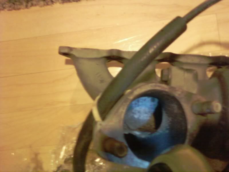

so i took some pics today of the setup against another mildly ported 2g manifold, and a pic of a 2g gasket on the o2 housing, now that i look at it it looks tiny.

Take the turbo off the manifold and look at the collector.
Your sitting here making assumptions saying its not what you bought but yet have little to no knowledge about what you have. If you want to educate yourself, educate yourself without assuming you got screwed hence the "note to self, do not do business with you". You are throwing up red flags everywhere in this thread to not sell stuff to. You came in this thread with the mentality you got screwed but no nothing about what you got.
So like I said, post pics off the things I told you to, buy new gaskets for everything on that turbo setup and we will tell you what is up with it exactly.
