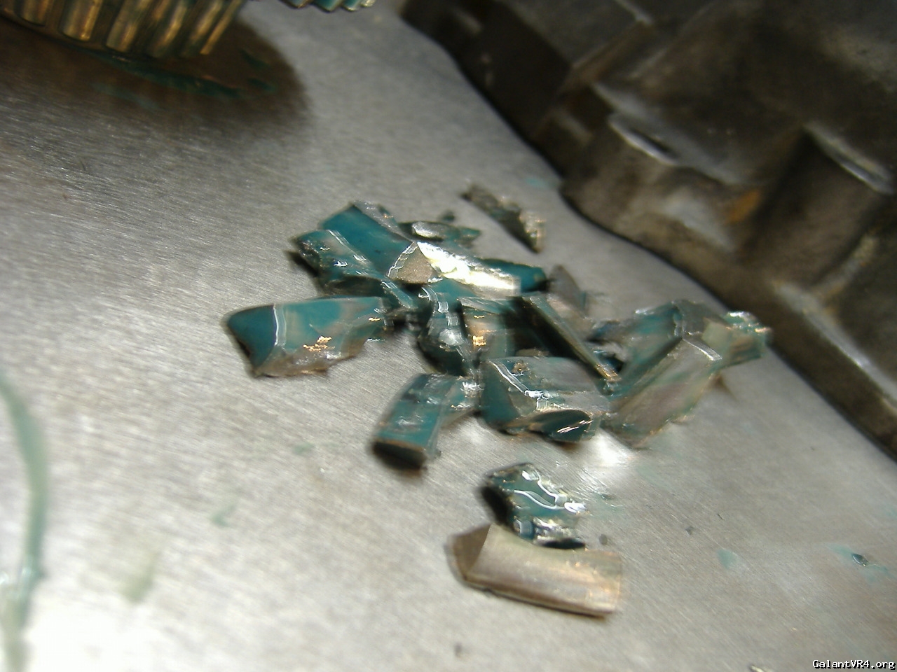

you should have a look..its always interesting to see what has happenedQuoting mrnvit:
im interested to know whats left of my 4th gear in the drag car, there were lots of bits in the end of the case when i took it off, but i couldnt be bothered taking it down further to look.

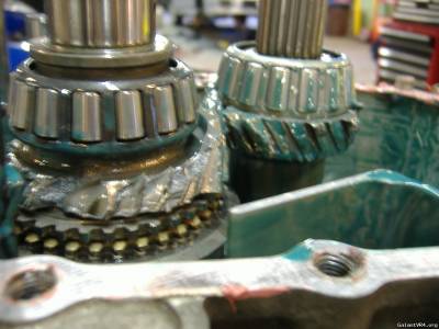

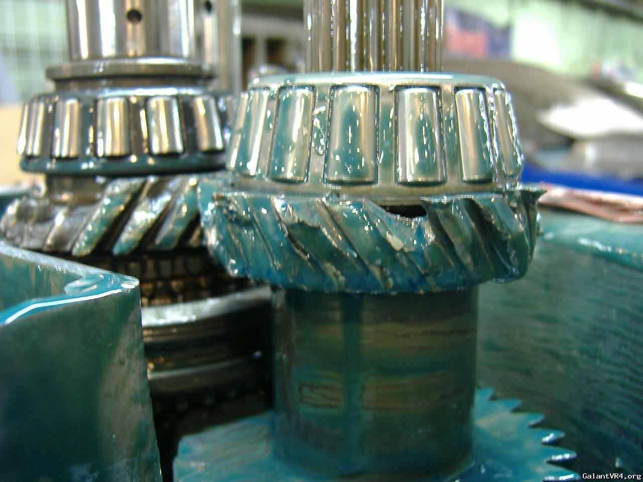

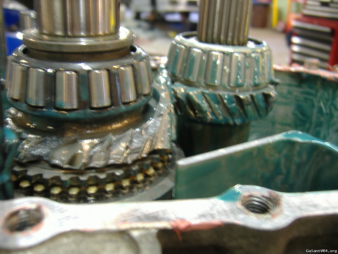

What caused it to break in your opinion?
I'm aroud 340 wkw's / 455whp's also on a dyno dynamics.. The gearbox felt extremely good for that power output..
No signs of weakness.
Your fluid is blue, so it must be redline shockproof?? or something similar?
I run Diaqueen OEM mitsu evo 8 oil with redline LSD additive...I wonder if that has anything to do with longevity of these box's....
What state was the car in when you broke the box? ie, tracking? drags? street?
Are you planning to get another box? or go Dogbox?

no,didn't reuse any of the parts,ended up rebuilding a 92 VR4 RS WQYK gearbox for the car,and just rebuilt a Lancer Evo 2 RS WPFE as a spare /ubbthreads/images/graemlins/smile.gif

Yeah Bazeng, we actually made more but then dialed back the boost a bit for the track. For hillclimbs I'm running about 20 more whp. The fluid is Redline lightweight shockproof. I run heavy shockproof in the transfer case.
I had about 400whp all year last year and the box was fine. This extra bit seems to be a challenge.
It would be close to 600whp on a dynojet.
Anyway I'm still trying to figure out what to do about this. There is a gearset manufacturer in South America that makes a straight cut syncronized box that I've heard is good. Station Arnside in UK also has some good gearsets. They're all very expensive though. 5k or so.
A friend on the Lancer Register is in the same spot we are, two broken factory Evo II boxes this year and one broken Magnus Dogmission.
