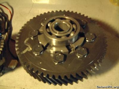

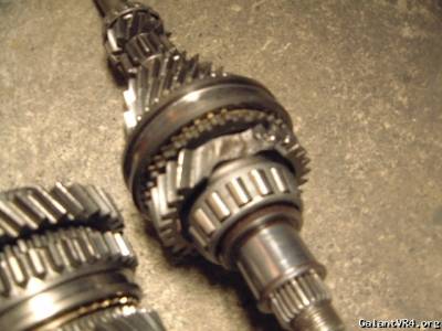

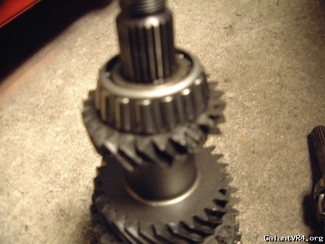

Thought I would share some pictures of the gearbox I damaged on a tarmac hillclimb..I was lucky enough to have no damage to the brand new cusco lsd I had fitted pre-event /ubbthreads/images/graemlins/tongue.gif

4th gear? I have broken two boxes this year. This time I was in 4th and the car just stopped going forward. Same deal.. 28lbs, R Compound tires..

Yeh 4th gear..big sideways around a big sweeping corner lost drive and spun out,should of left the restrictor on the turbo!Had the same thing watching brand new oil going down the drain.. Quoting Bimmubishi:

An evo 3 box has a burst strength of like 360 ft lbs, Believe it or not that type of failure is due to heat. Not that it overheated the gear set but heat induced fatigue, This is why drag cars can run 600ftlbs through that evo box and run 8's with out it breaking because it cools down between runs but get some temp in it and put some power down and forget about it lasting.

I have seen this failure quite a few times with local dyno tuners when they do a run in 4th gear,the last one I saw was another rally car..when stripped down,a run-in rebuilt gearbox with crack tested shafts had let go pretty much straight away.On my car though definitely having a sump guard and higher temperatures under bonnet would of contributed to the failure.
