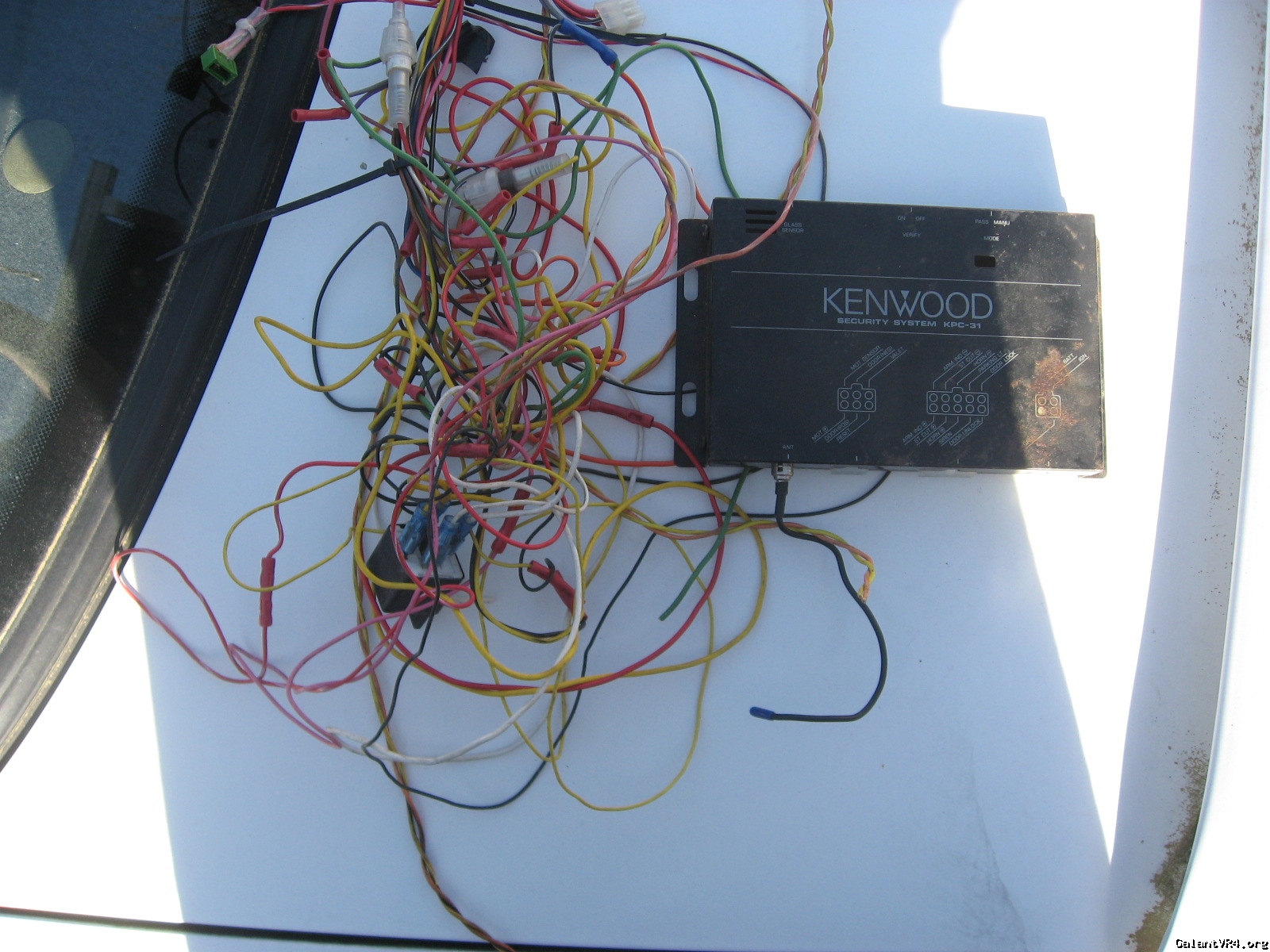

Well I picked up the Galant gsx yesterday from Jason. f*** mapquest. That sh*t had us taking the long way. Any way got home last night and just left the car on the trailer. Unloaded it this morning and got it put where I was thinking it was going to sit for some time. Any way went and did some things and when I got home started working on the car. I found a old ass kenwood alarm system so I pulled it out and all the wires. Tossed a battery in the car and gave it a crank. Oh f*** me it started on the first try. /ubbthreads/images/graemlins/grin.gif Now just need to give it a really good bath and fix some little things.

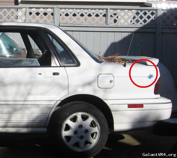

Is the blue side stripe stock? Pretty interesting end on that.
I have know idea.

Glad to hear it is working out for you. It was my brother's project and the look on his face when I said it was because of some stupid alarm in there was one of shock and disappointment. Ah well.
