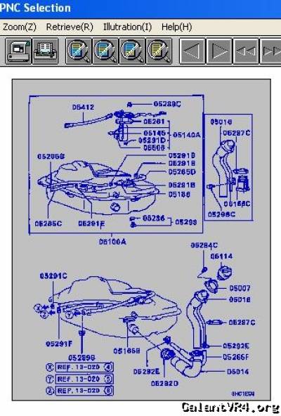

There are two pieces to the fuel filler hose which may be causing some confusion here. The top section which bolts to the car body is MB678630 and is specifically called the "neck." Then there is a lower elbow type of hose which connects this neck to the fuel tank itself. The lower section is MB678633. They both come up on JNZ's website, but its quite possible that one is NLA and the other is still available.
89-92 Galant GSX uses the same part numbers, if that's any help.
